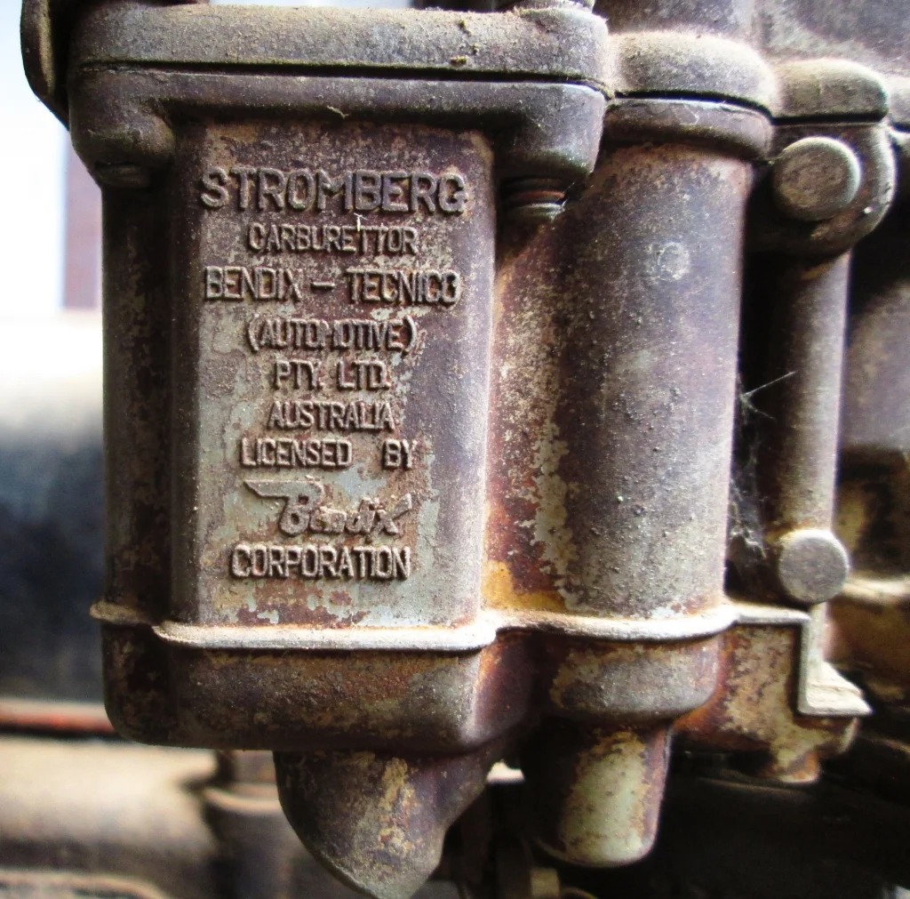

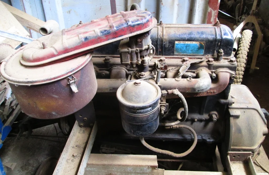

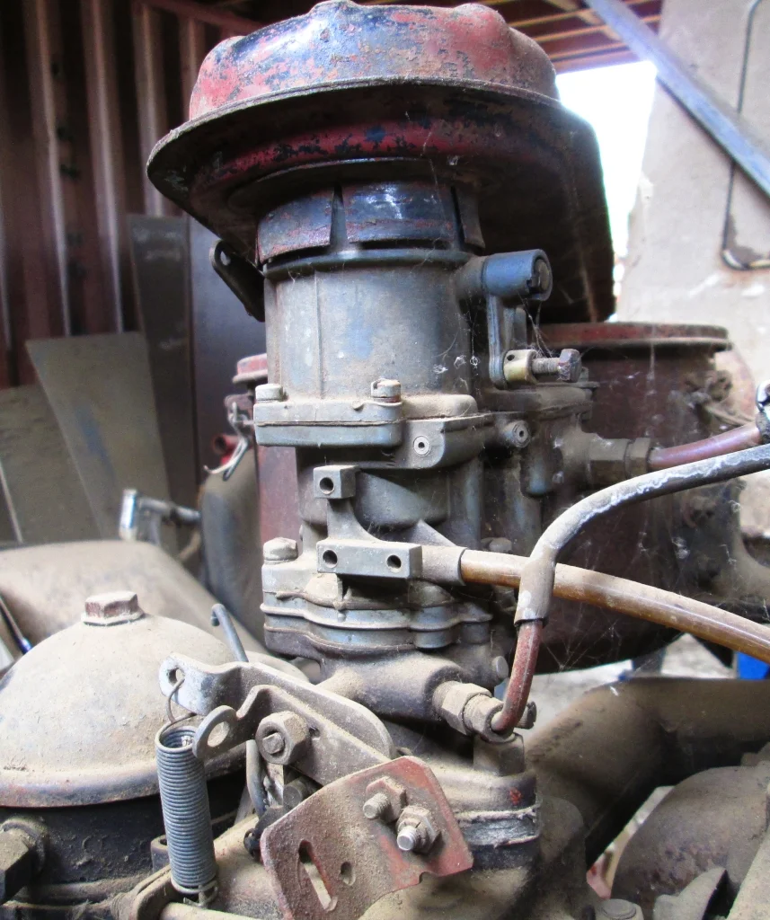

A lot of the old LC's here in Papua New Guinea had Strombergs on them. I have been unable to prove one way or the other if they came that way or it the Stromberg was just a locally popular modification. I have a couple of them, one of them on a running F-135 I have on an engine stand.
Okay fine:
It's a pretty legit install, doesn't look like the usual home brewed solutions cobbled together by gold miners, coffee growers or missionaries that I have seen around here from that era. If the ones sold in New Guinea were originally equipped with something else, none of those have survived. All I've ever seen have been these old Strombergs.
Very kool. Maybe some of the gurus will know if it's unique to Oceania.
Thanks for posting!
The red bracket you see in the second photo is a later mod. When I first got this engine it was in a '65 LC (FJ45? Not enough of the original truck was left to be able to tell), that had been hacked up into a make-shift fire-engine and was in use at a local airstrip. I think that was part of a hand throttle mechanism that (IIRC) was controlled with an old airplane throttle control knob. One of the nuts used to hold it in place looks like old style AN hardware, which is a pretty good clue that missionary aviation guys were involved in the modifications, or that somebody was harvesting AN hardware from local WWII airstrips, which is also possible--a lot of that was going on here in the '70's, which is when the fire engine mod happened. Anyway, that's an example of one of the "home brewed solutions" I was talking about.
