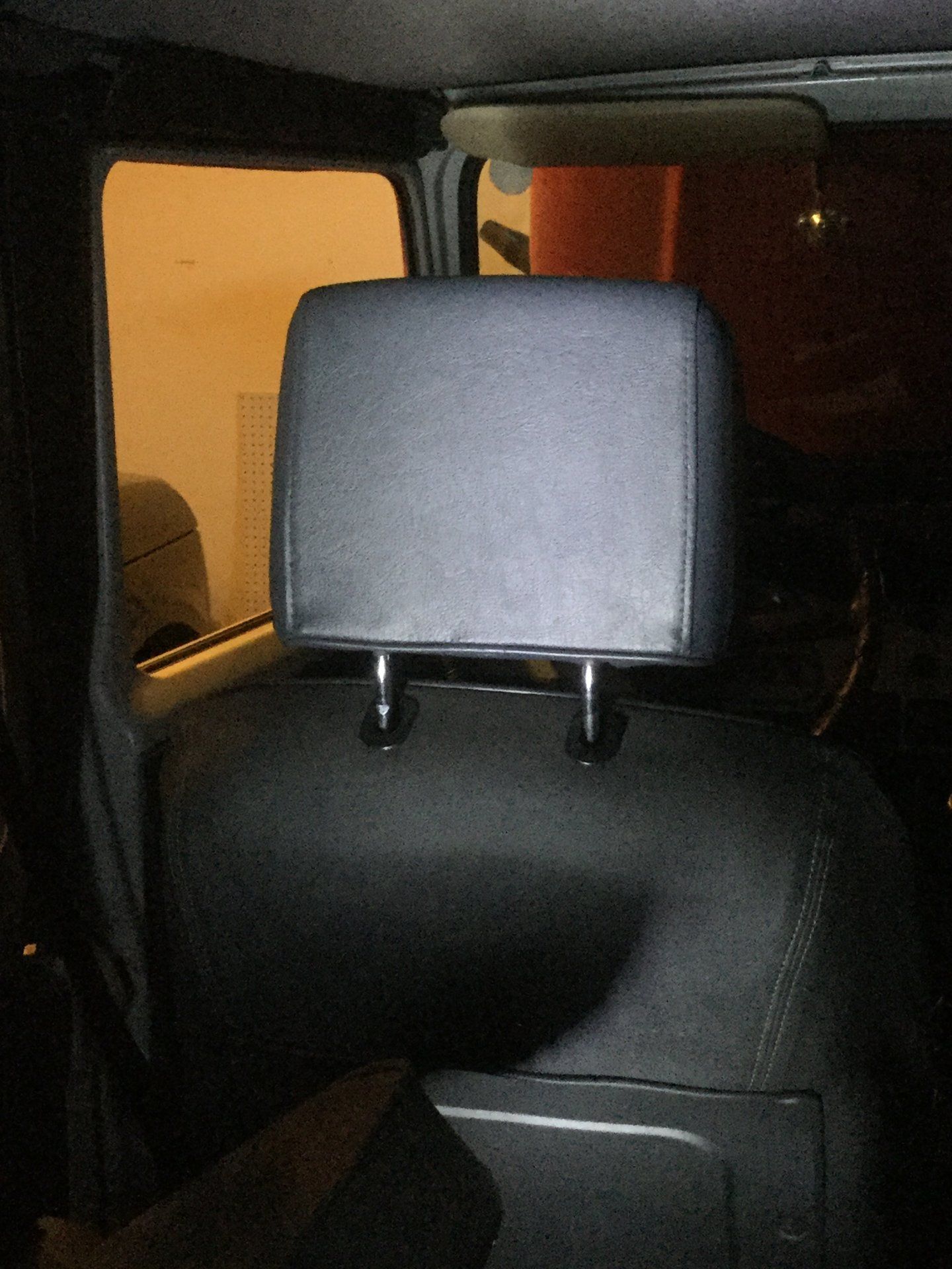

I bought these off eBay -lister claimed they fit a 79-83 Toyota pickup - fortunately they had pictures and measurements - these measured 4.75” and fit perfectly - originally maroon, I painted them with vinyl paint -my camera and light highlights the color difference - in person you can’t hardly tell.
75-78 40 or 55 series? yes those are different than the 79+ headrest.
post in the classifieds and specify the year range.
76 for me - yes those years are the oddballs from what I’ve seen.

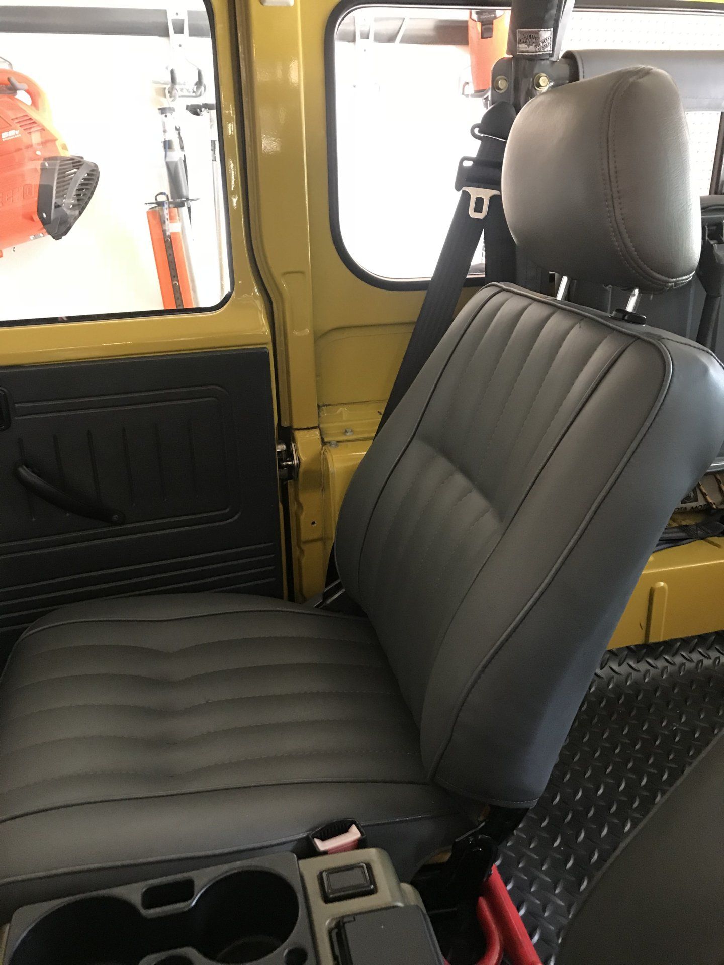

Dual master cylinder and headrests are the two things we're doing for safety's sake on our '67 rebuild... I refused to put newer seats in, so my wife and I pulled the tops off a pair of Nissan Pathfinder seats and welded them into our original seats, and decided not to try and match color- our nod to wabi-sabi philosophy. After my friend, the PO, had a couple of rear enders, this makes my neck feel safer.

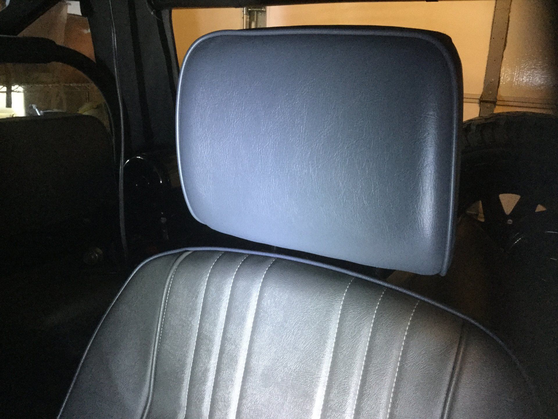

Guys, I’m genuinely shocked it worked, but the Mazda 626 (model year 93-94) headrests worked in my 1976 (4.75” pole distance). Found a brand new set for $50 shipped from Houston on eBay (delivered to me in Austin the next day). They will slide all the way down, but there seems to be enough friction to keep them out a bit if I want.
