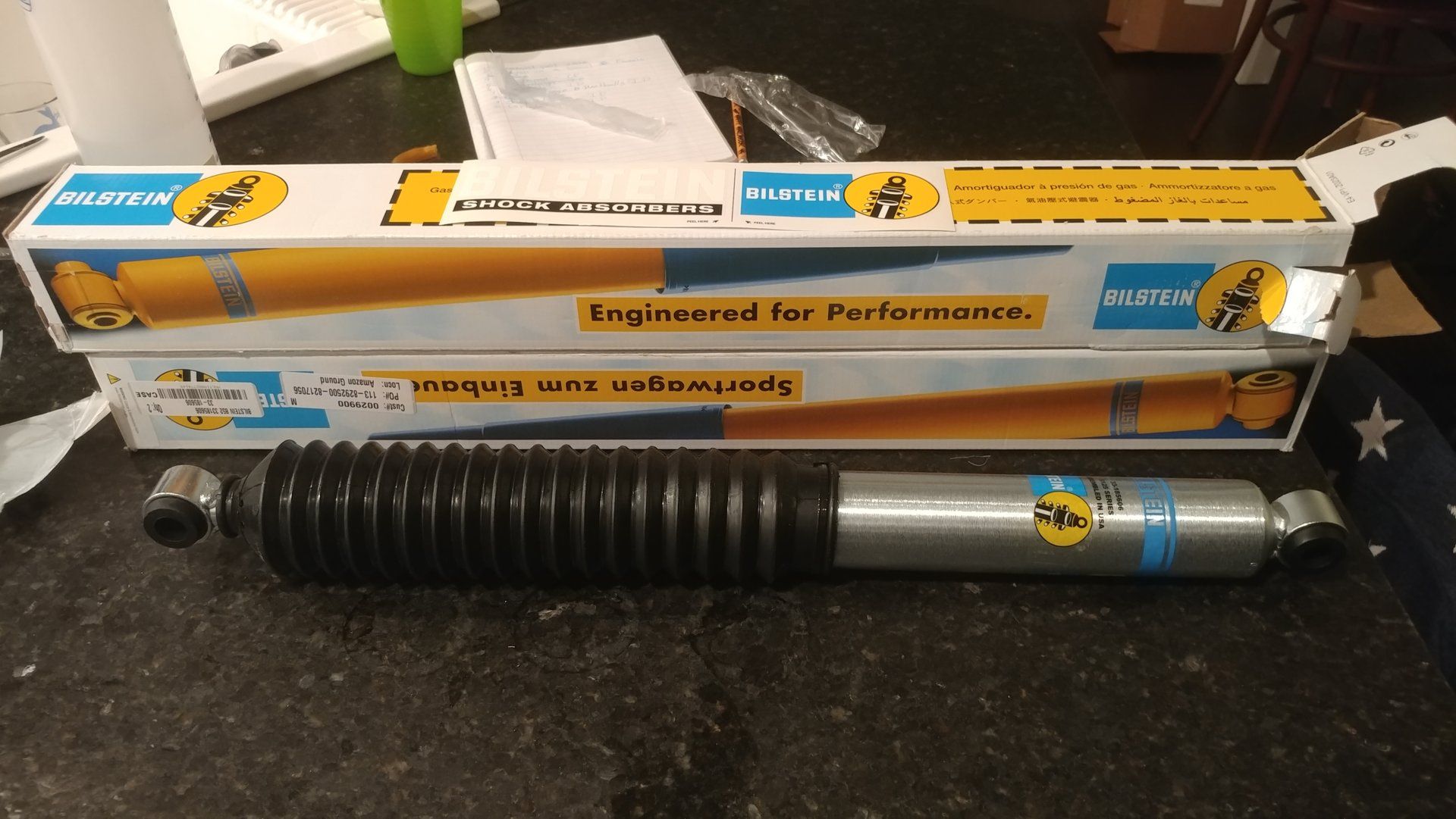

Picked up a new set of shocks for the front of the 40. Its been just sitting in the garage in pieces, so I'm gonna get it back together so we can drive it around some before it gets cold out.

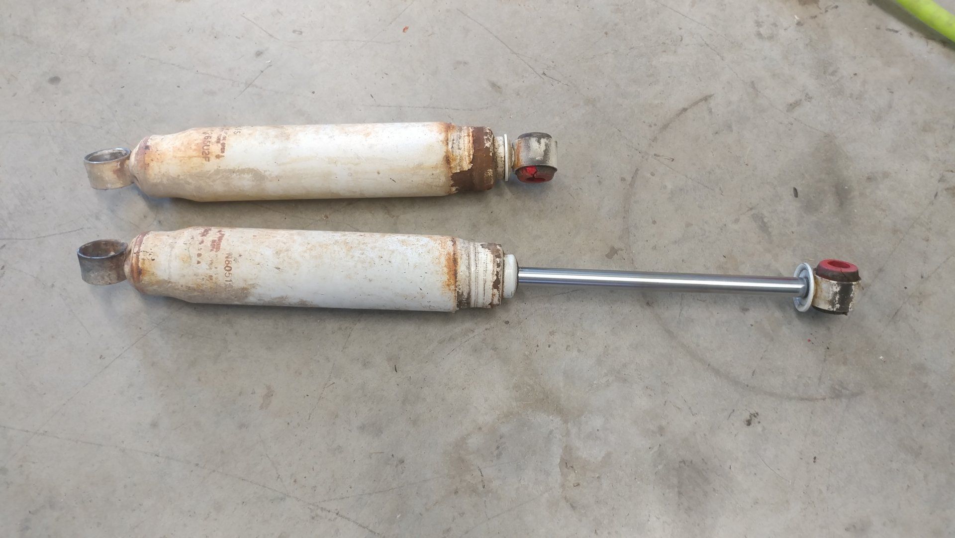

The shocks on that 40 are only 18 years old. No way they're worn out😁
One of them had zero juice left, One still had a little life in it, but neither of them had a complete bushing left in either end.

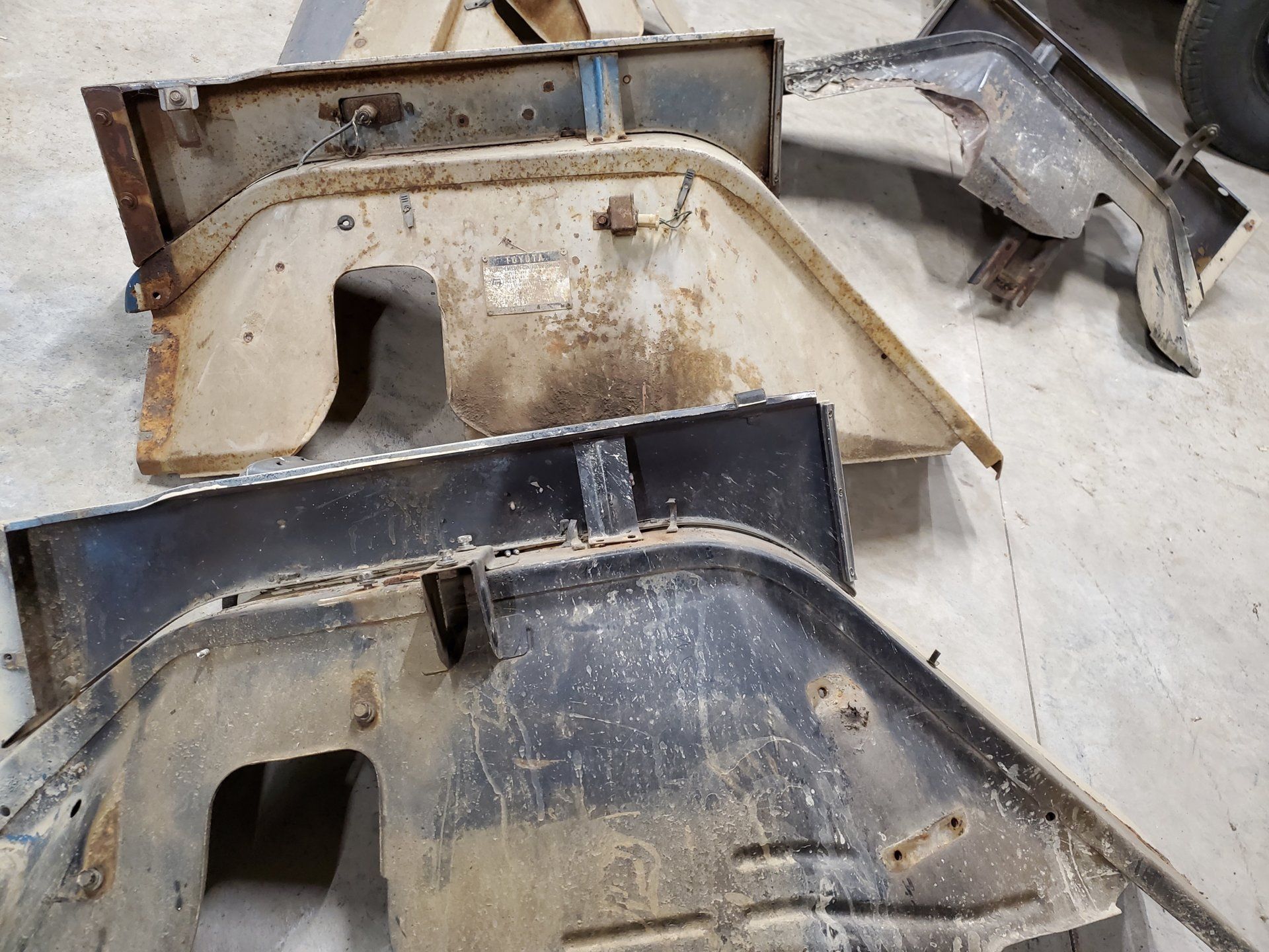

'69 fender is the same in shape, but is missing several brackets.
I will have to make a new reinforcing plate for the charcoal canister. The main thing i need is the coil mount which looks to be spot welded onto the fender.

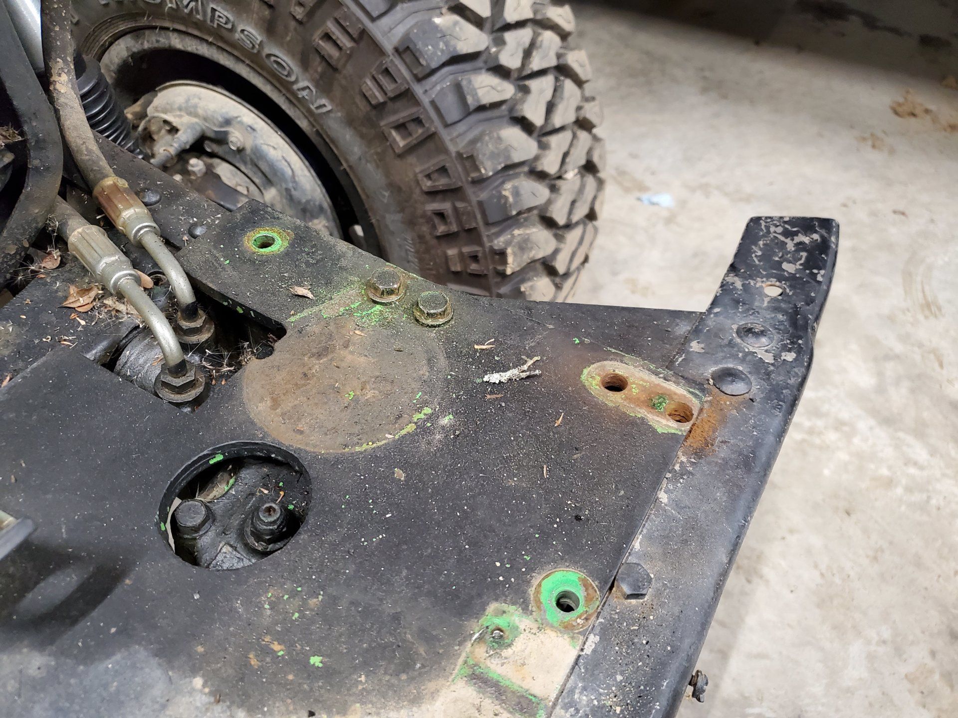

Whoever put this crazy winch plate assembly on and did the steering clearly did not have future maintenance in mind...
The nuts for these two lovely bolts were in the frame...
Unfortunately when you box the frame to mount a Saginaw box this is what that looks like.
To get to those 2 nuts the entire front end must be completely stripped.
This is entirely too many bolts to have to get the front end apart. Not to mention they are of all makes, JIS metric, US metric, standard, Phillips...
Between the impact, grinder, a big screw driver a hammer, whatever else was i could find and about 2 hours, the winch plate is off so I can get to the steering box.

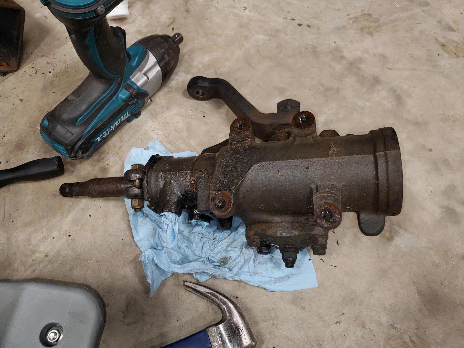

Well, the offender has been removed.
It looks like the input seal took a dump.
This bolt sucked, the hanger will need a little more clearancing...
After looking over the frame plate
And the pump mount.
What I have figured is this is a Man-a-Fre kit with their pump bracket as well. The bracket does not align the belts properly, so basically I'm cleaning it all up.
The box is an older unit with the flared fittings, so I will be replacing with a newer model box, picking up a new pump, bracket and associated lines. Probably a new cooler while I'm in there.

Matt if I remember correctly that pump and box were off a 75 K-5 Blazer.
Awesome. Thanks Andy. That makes sense. From my research I came up with a pre-1980 GM 800 box.
