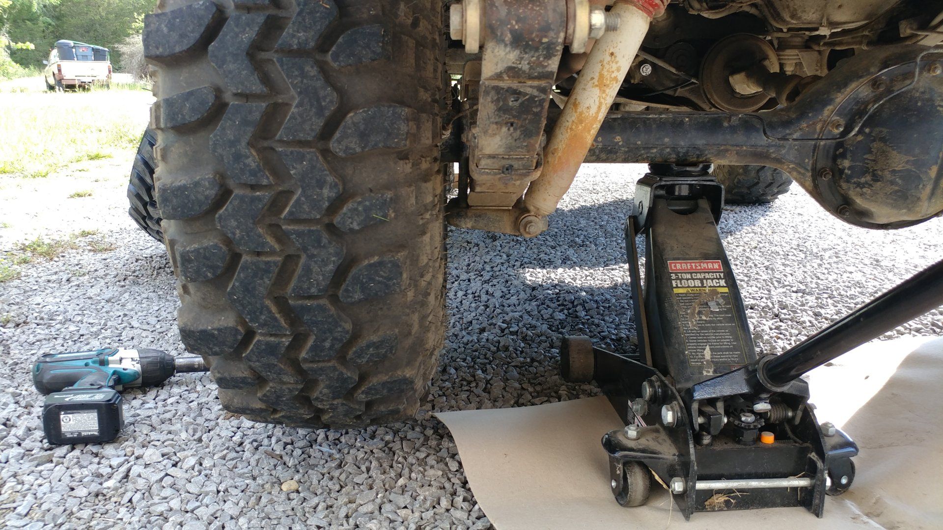

I dont know what the BS is on the steel wheels but between them and those swampers, the rear tires were close to the springs and didn't leave much room for flexing. I knew the BS on the racelines was 4.5" and in my reading it seemed that 3.5" was what most folks aimed for, and then Elbert offered up the spidertrax he pulled off his 60 and I snatched them up. The bolted up and put the tires at around 3" net.
I cleaned the stock studs and put a dab of red loctite on them before torquing them to 85 ft-lbs.
Then bolted up the new wheels. Check out the difference.

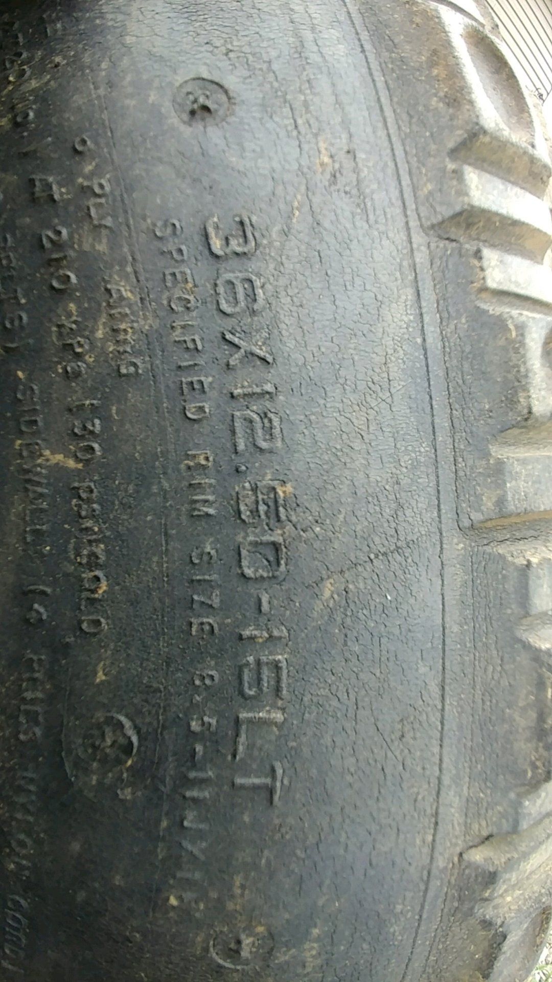

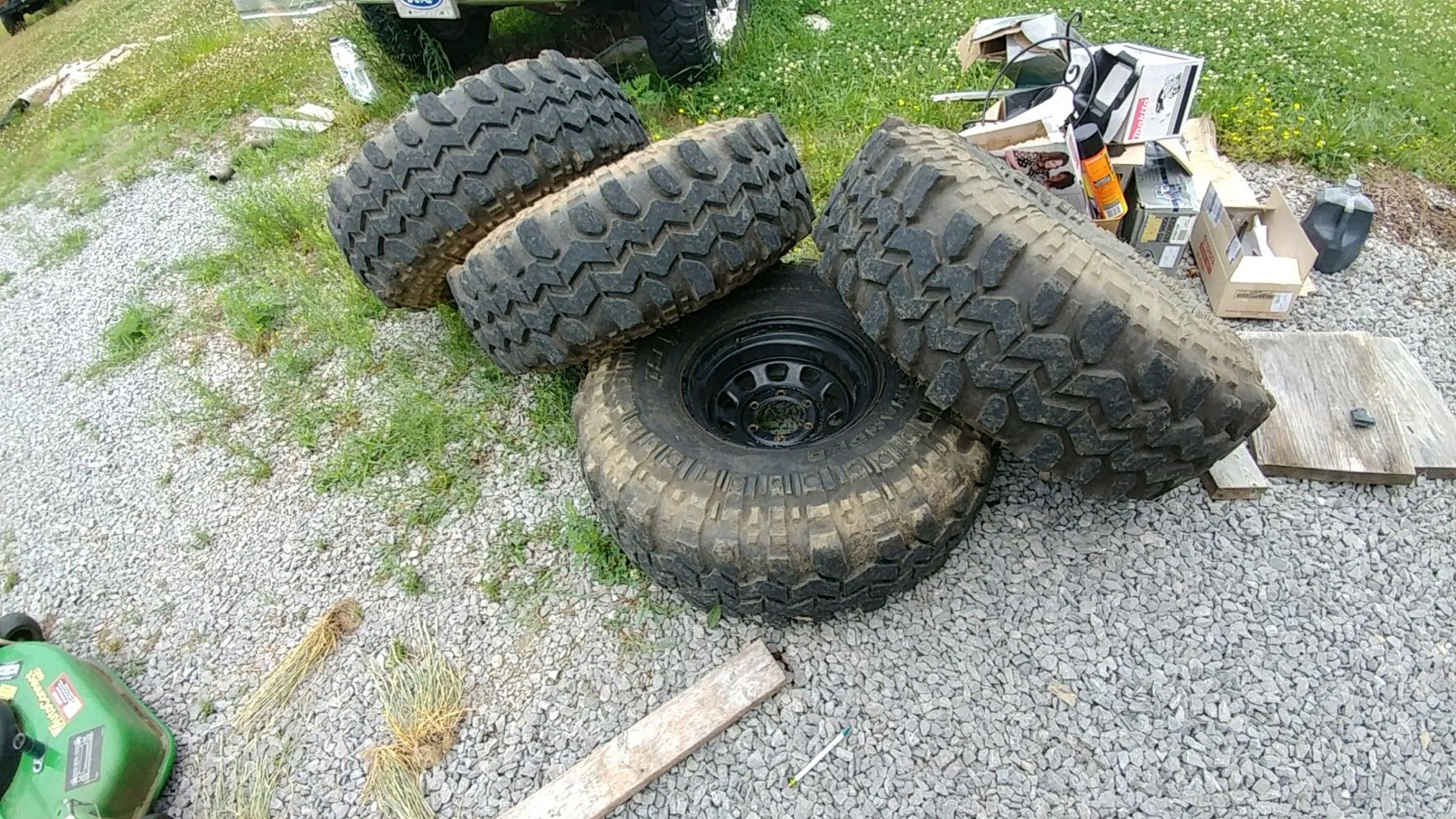

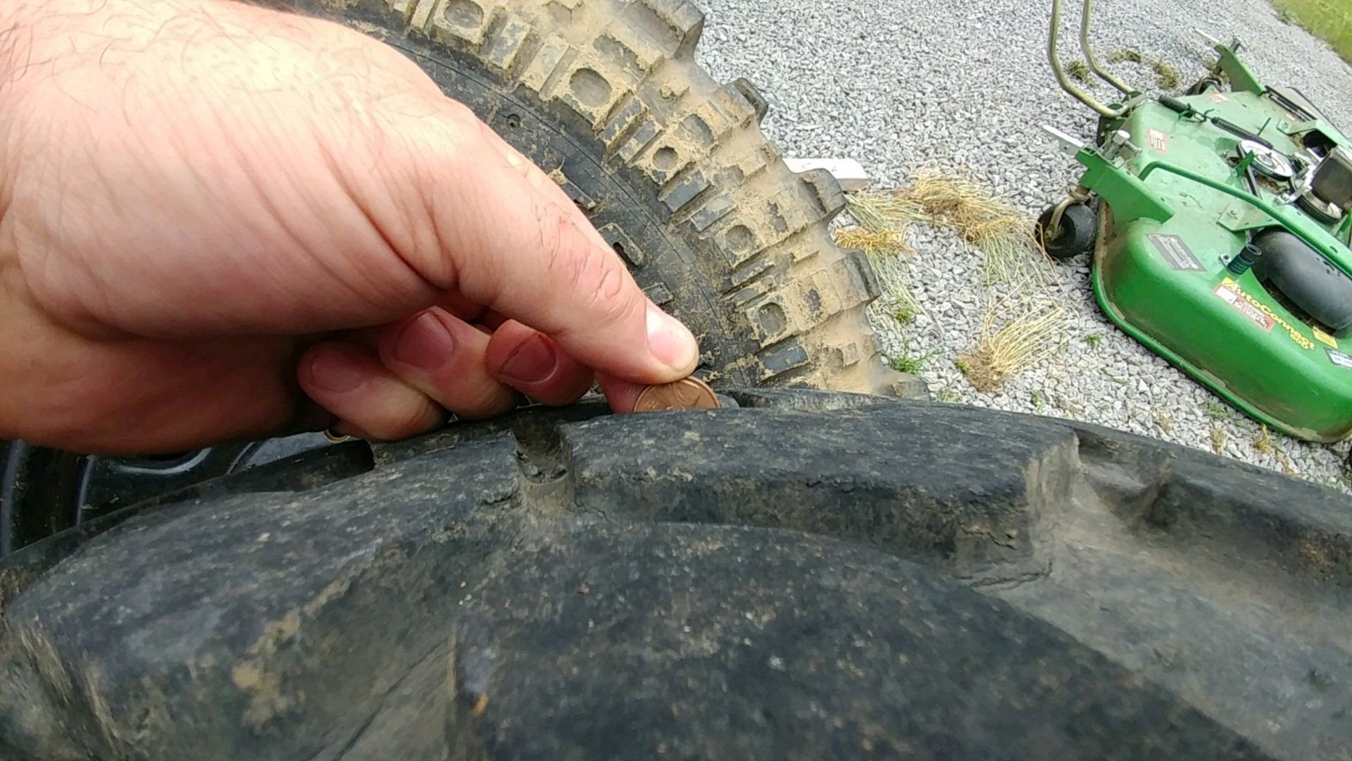

Here are a few pics.
Sidewall cracking, this is probably the worst of it, and 4 of the 5 have some like this on them.
Tread depth, lots left (Lincoln who...)
Here are the 4 I pulled off the 4D, the other one is stashed elsewhere.
