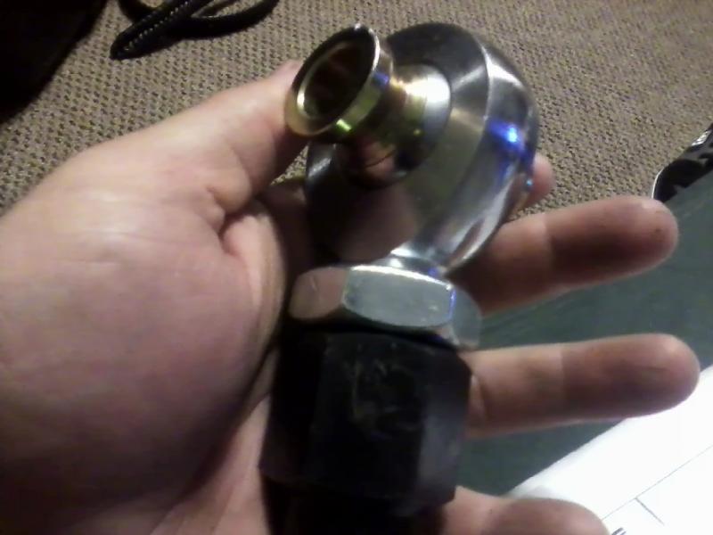

I also got the heims in for my anti wrap bar. I got a set of two so I can build a wrap bar for the front if I find it twisting.
If I don't need to build a front wrap bar I will have a replacement for the rear bar.

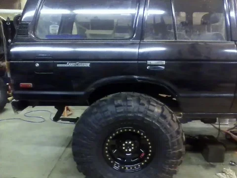

So I switched the two mounted tires I have to the rear so I can remount my shocks up front and cut out the fenders.
The tires look pretty good back there.
They don't stick out too far either.

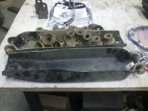

And here are the shock towers I will adapt to my hoops to drop the mounting location of my shocks lower.

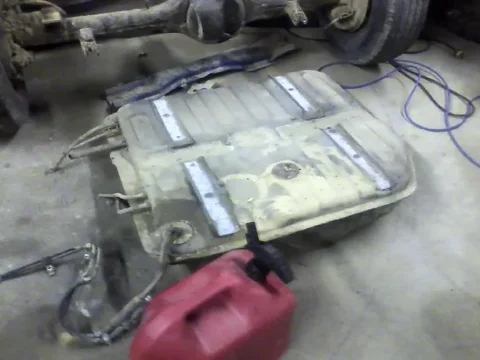

I also had a buddy come over and help me drop the fuel tank.
I will send that out to get the extra ports plugged and the tank checked for leaks and sealed.

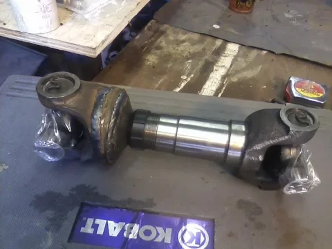

I received my midshaft today and installed it into my truck.

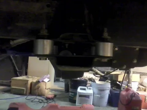

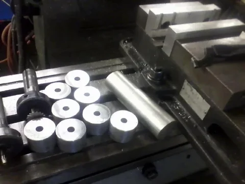

There was an issue with the U-joints binding so I decided I needed to drop my transmission crossmember a bit to alleviate some of that angle.
Here is the midshaft.
Fortunately I work at a machine shop within 5 miles of my house and the shop I have my truck at. So I ran over to work today and whipped up some aluminum spacers.
Here they are installed:
I also remounted my front shocks to increase the amount of droop I can get out of them. I also took the time to put the 1410 yoke on the front.
Those spacers look sweet. Truly custom. Love that stuff.
There were a ton of 7075 aluminum butt ends in the scrap bin from a job. Free access to scrap for machining is nice.
