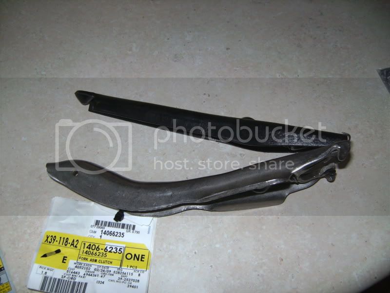

Had something bite me in the ass today while working on the cruiser. I was moving some wires around and noticed the plastic sheathing on the clutch line was slightly melted. The engine hasn't been run for more than a minute or so, so it's pretty obvious that I am going to have to move the clutch slave cylinder. Here's a pic of where it's at currently.
I have the AA bracket for this already and tried to use it but because of the curved clutch fork there is no room for the pushrod. I need to swap to a straight clutch fork. Here's a pic of the difference between the two
I had thought about doing this before I put the engine in but didn't think it would be that big of a deal :bang: So this week the interior will come back out and the tank and the trans cover. Because I have an early SM420 I'll probably have to remove the bellhousing as well. My SM420 has the 2 bolts up top that go into the bell, and two bolts that go through the bell into the trans case. I can't see a way to just remove the trans in the case.
Hopefully once this is all back together I wont have to worry about boiling clutch fluid
Got a ton of work done today:
Replaced the clutch fork and now the slave cylinder has ~3-4 inches of clearance from the header. Big improvement there. I got all the interior and gas tank installed again as well. Fixed a small problem with the tail lights and a couple of other small things. Checklist is getting short
