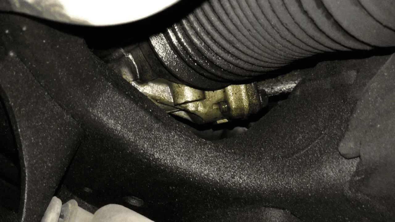

Apologies for bumping an old thread, but it seemed the most appropriate. I recently bought an LC 100 w 176,000 miles on it. I had it checked out by a Toyota master tech and he gave it a clean bill of health, which slightly surprised me as the steering feel was a little off to me (it was a little raspy, for lack of a better way of describing it). I chalked up what I was feeling to the LC being on a truck frame, etc. and I had never really driven a vehicle like it before. Anyhow, after noticing a slight pulse near lock and what seemed like odd play in the wheel I decided to have it checked out. After about 15 minutes I was informed that I needed a new rack and pinion and that it would be $1,600. I crawled under the LC when I got home and did notice that the boot was wet, but the leak had not yet made it down to the ground. Anyhow, I was wondering if anyone had any suggestions about how I might further explore the situation here and figure out if I actually need a $1,600 replacement at this point. Picture attached, if it helps.
