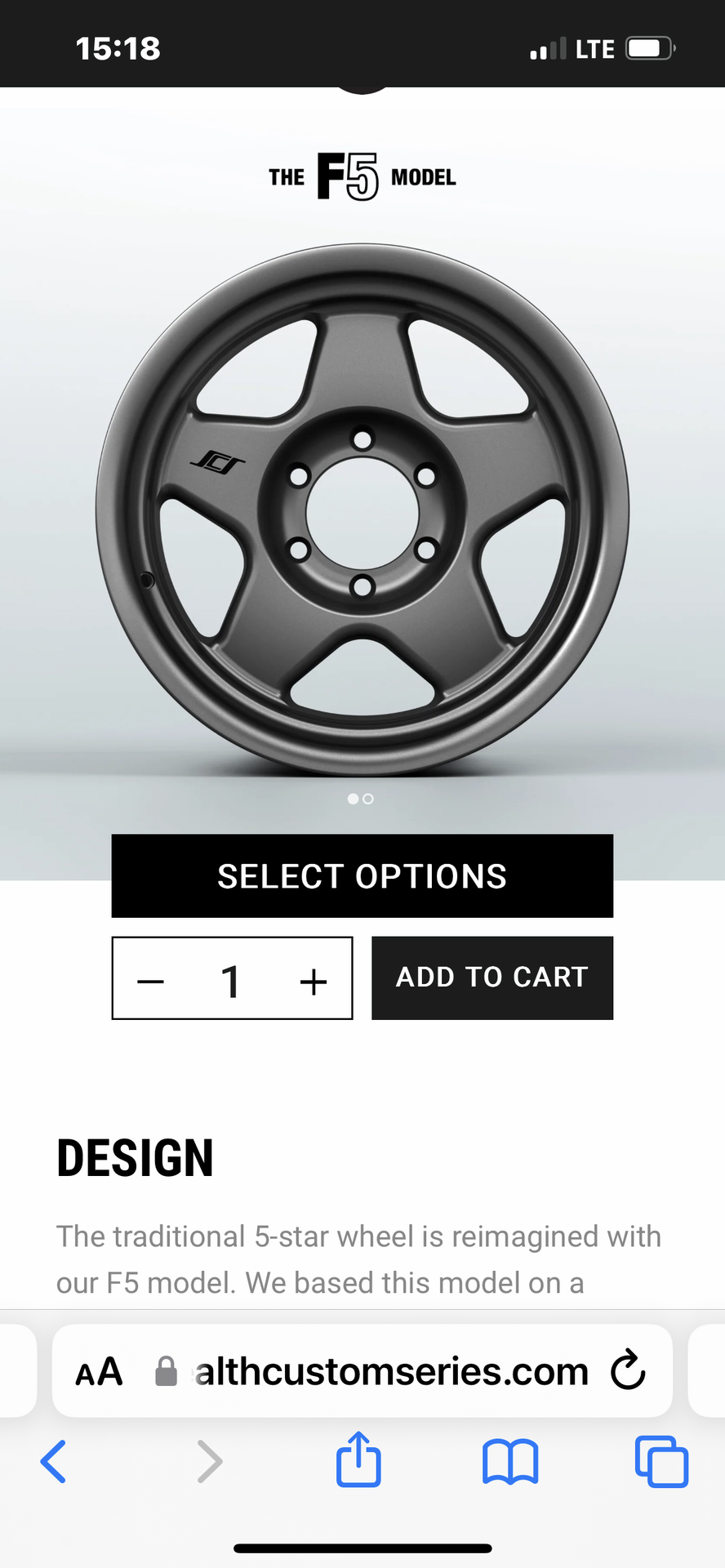

Anyone running these in the 16” with 3.5” backspacing on their 70? If so can you post pics and any pertinent information please, thanks.

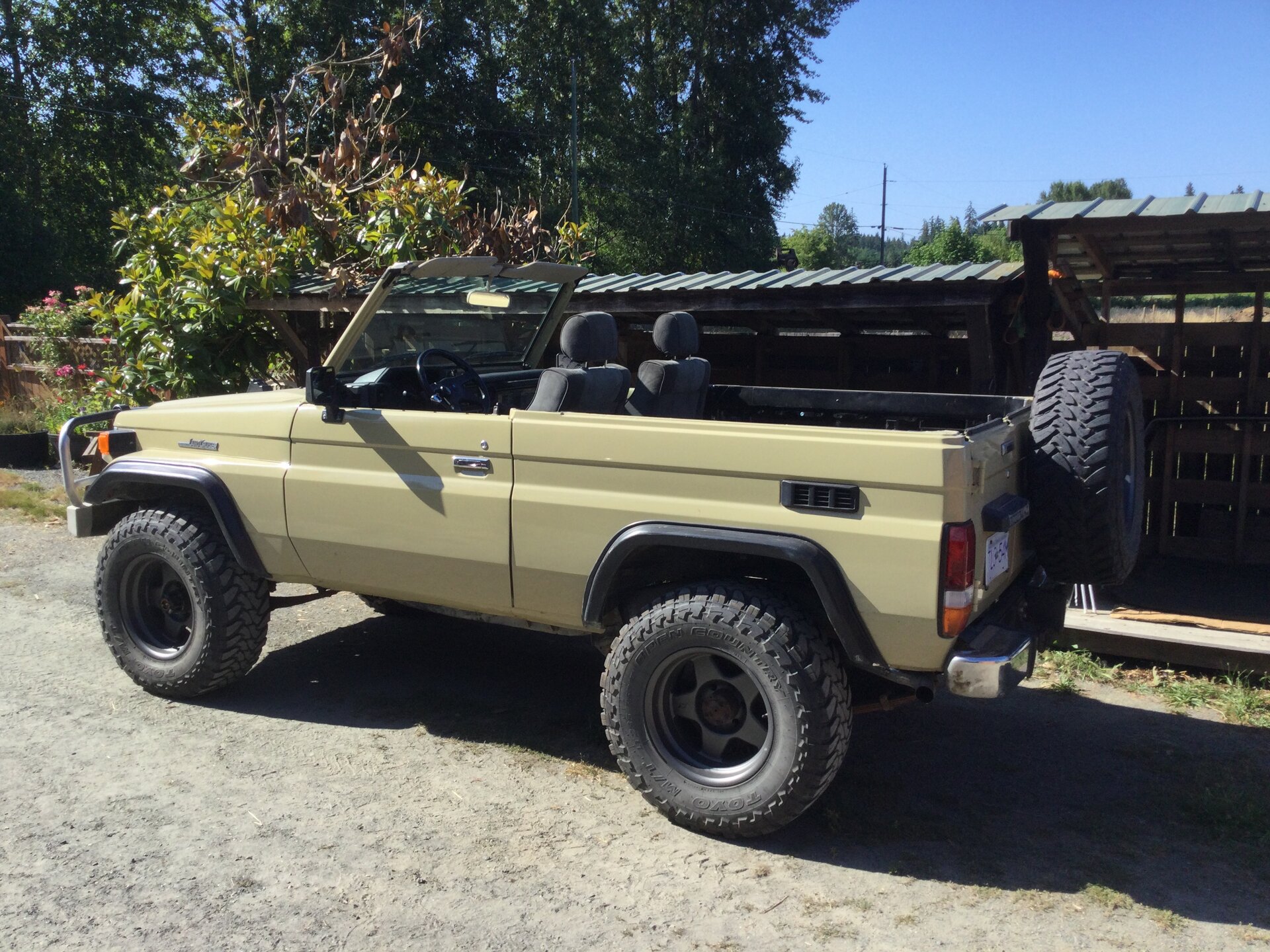

On my 80 and we are also running them on a 45-series with 60-series axles. 60 axles almost the same as 70.
Both same specs you are looking at.
I am not 100% on this but they seem to not like low pressure. I just rolled one off the bead over the weekend with 14psi. That is a first for me and I have ran as low as 8psi on stock wheels.

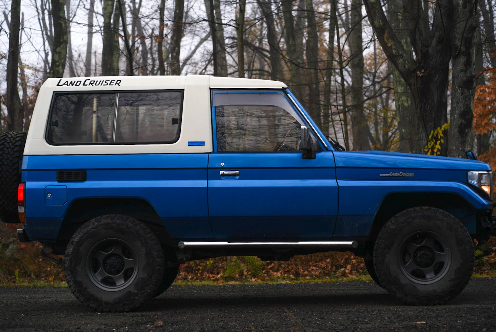

So where are Bradley V wheels from? If SCS copied them I never found them.
It certainly wasn‘t from lack of looking. Until now, I had never heard of the.
Thanks. Do you know how to interpret what they call inset? -5 or -6? which diameter wheel did you get? the 16x6 or 16x6.5?
Inset is the -15 part of the description I gave. It's offset in the US from what I've seen. -15 offset is "Face 4" on Bradley wheels. I went with 16x8, 15 (face 4) for 33" 285/75R16 tires. If you want to go 255/85R16 then I would get their 16x7 -15.
