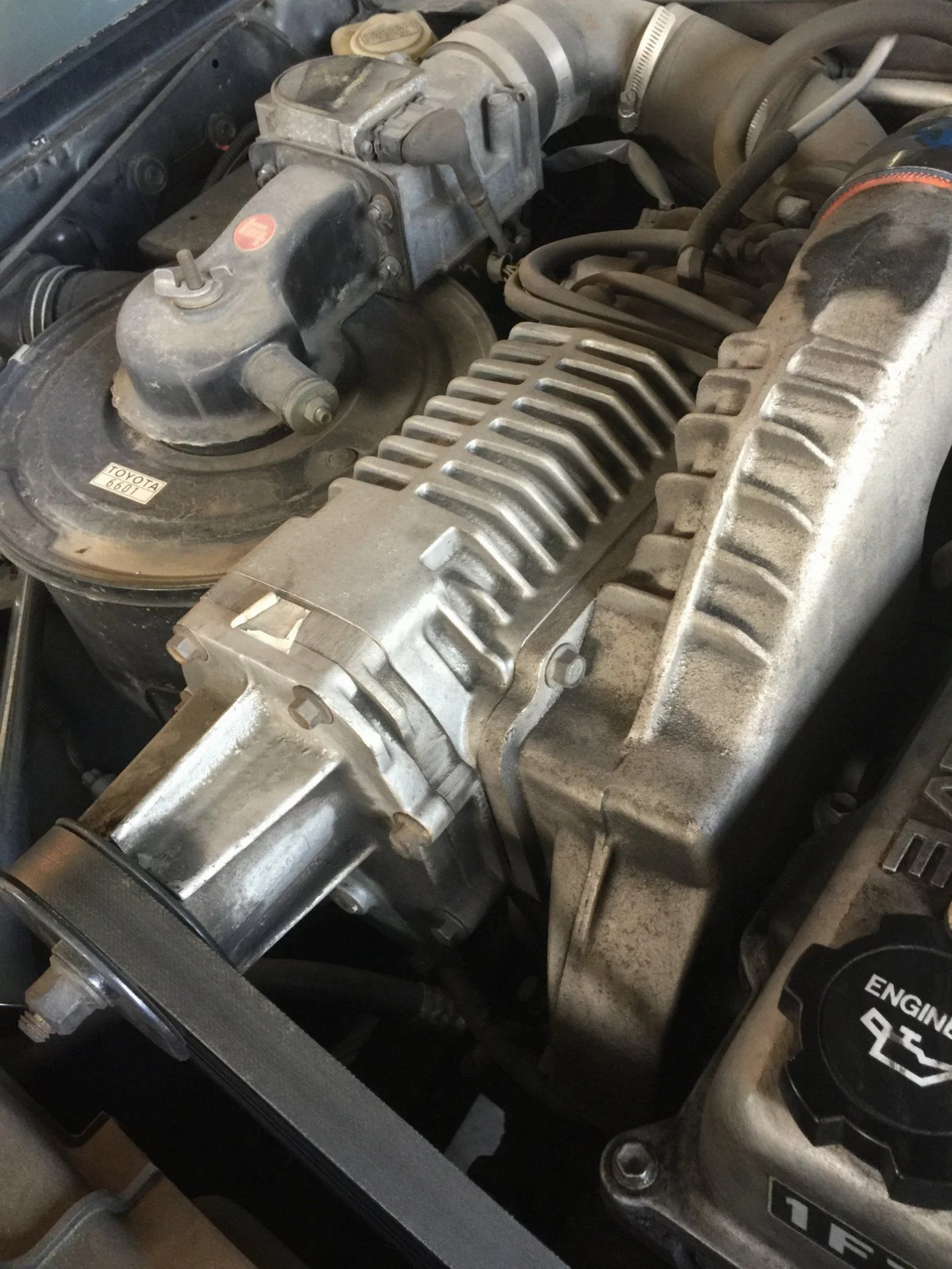

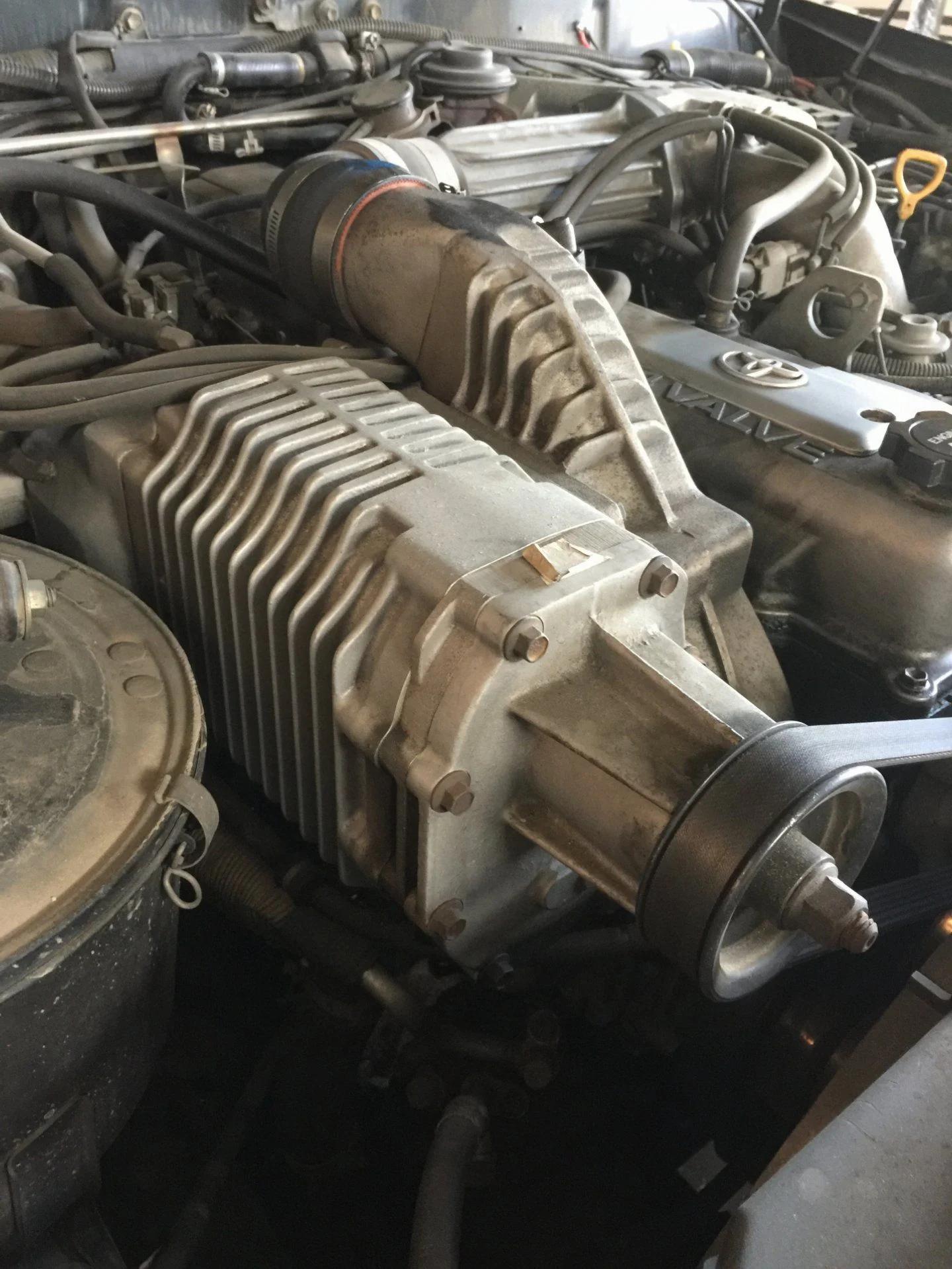

I need wisdom. I'm stealing a supercharger off of a 1994 year model and putting it on a 1997. Does someone have a list of parts that will be needed once I take the supercharger off of the 1994 like the intake hose? I know the easy answer is to use the parts from the 1997 on the 1994 but I need to steal the supercharger ,get the 1994 running and sell it before I put the s/c on the 1997.
Question 2, is there a replacement supercharger hose kit anywhere?
Yes I have searched... Thanks!

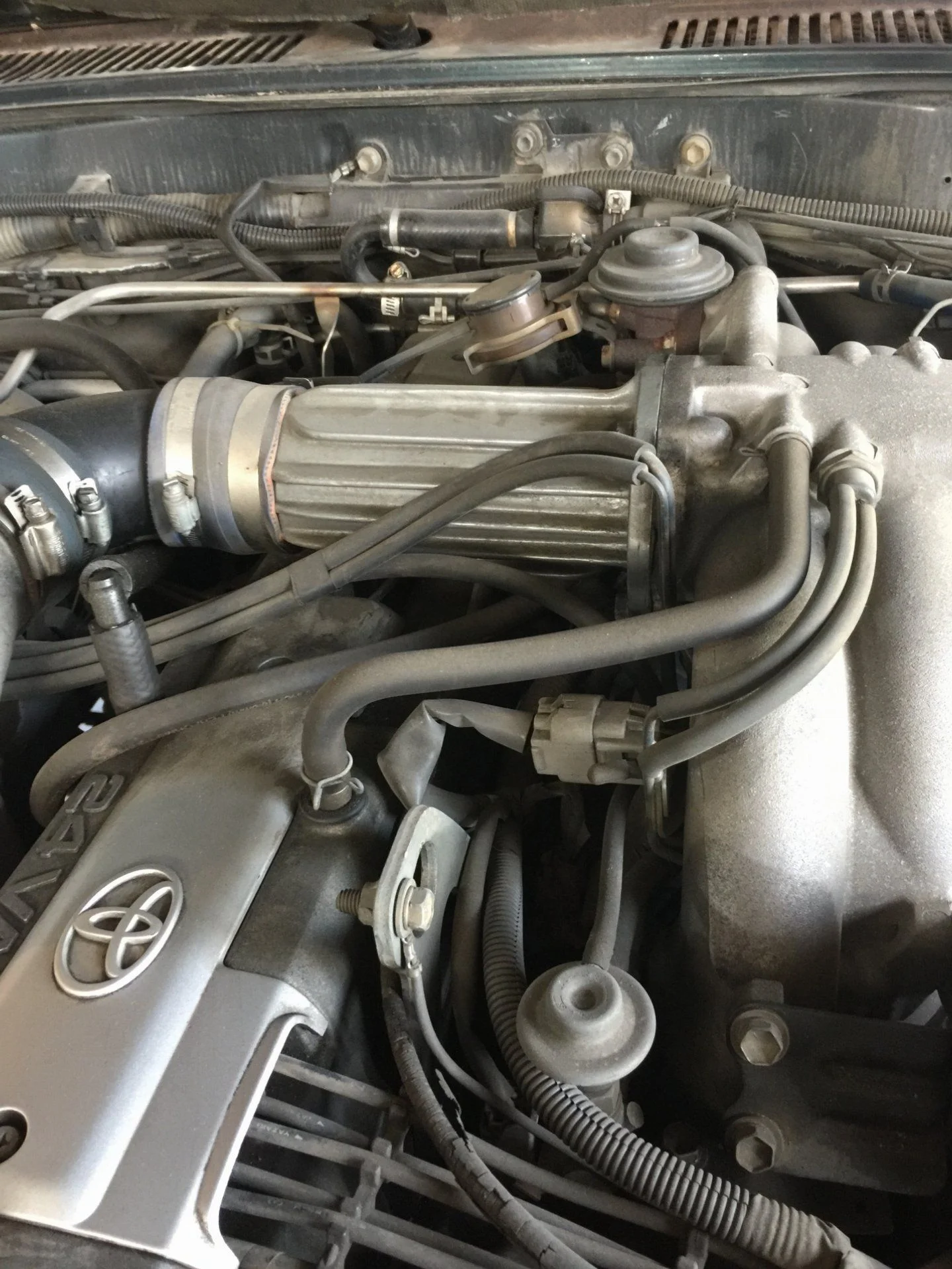

To the original poster, I presume you want to return the 94 to it's original configuration.
This will depend on how the truck was modified. Most likely the PAIR system was removed altogether and at least some of that stuff is discontinued. The heater return hose and tube is also specific to 93/94 as well as the air intake hose.
The air cleaner housing may have also been modified.
Looks like you will need a new air box top, hose from the box between the mac and intake, and if the pair system was deleted then that hard pipe though in reality not a really needed system so maybe just block off plates on the manifolds

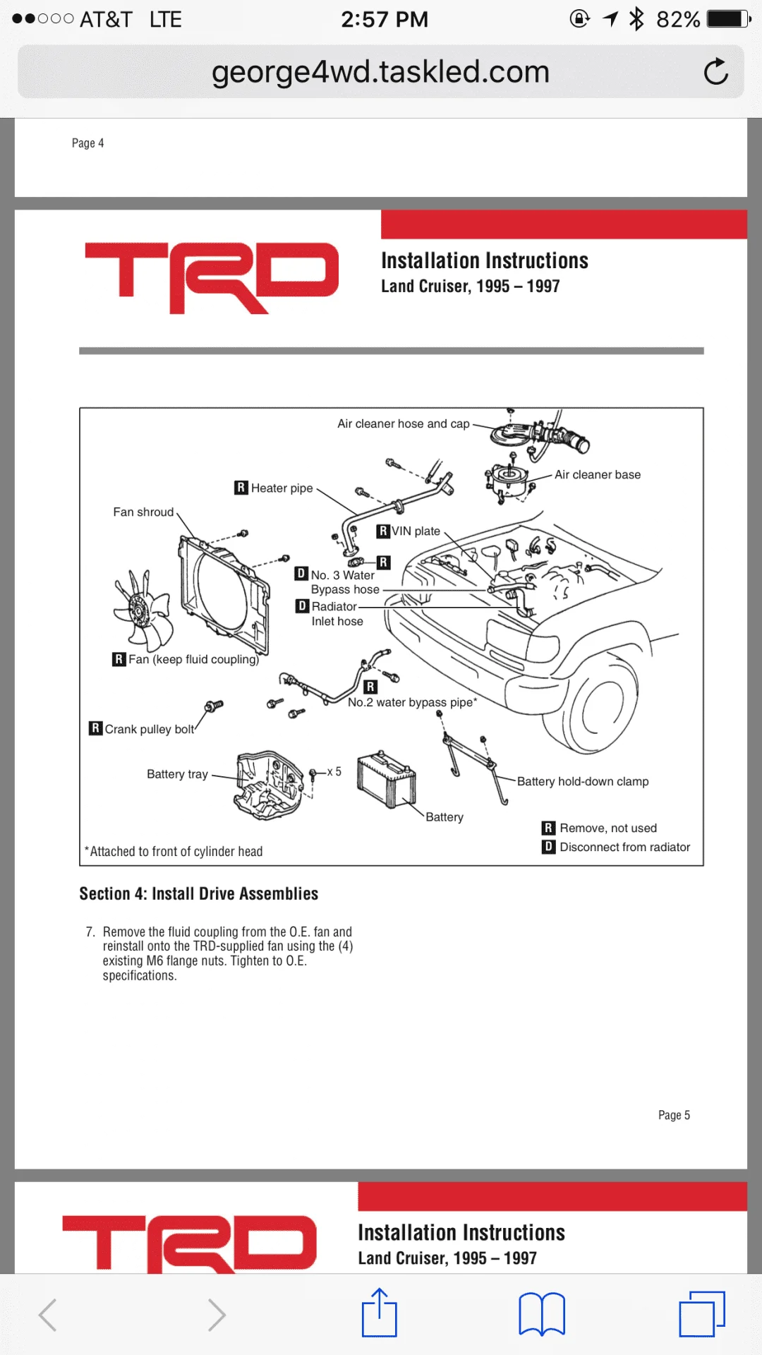

I have read the install manual. There aren't any part numbers. I don't want to buy a bunch of random parts that I think will work and lose my butt on restocking and shipping fees...
No.2 water bypass pipe
Heater hose
