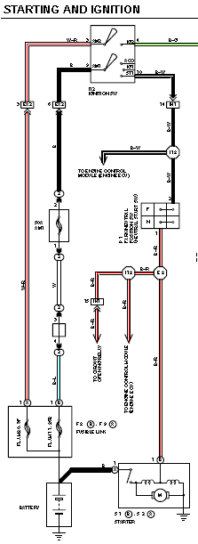

It sounds like the starter logic signal is not getting to the starter.
Use a meter and diagnose. The starter logic path is pretty easy.
Battery positive/FL AM1/fuse AM1/ignition switch/NSS/starter.

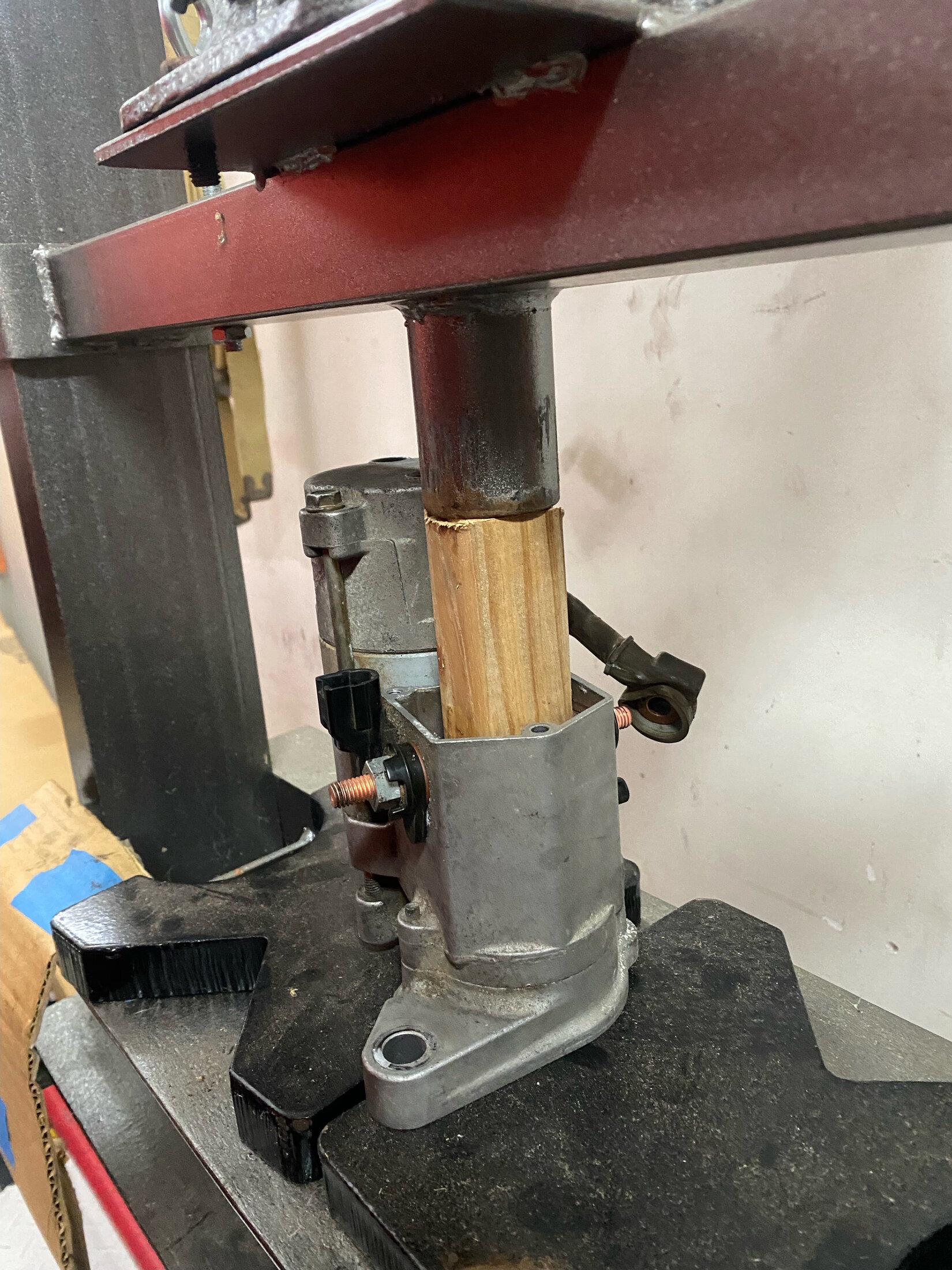

I have battled this issue for years. There is another post here that shows the FSM process for installing the new contacts. This includes pressing the contacts into the housing with a press to 220ft lbs while torquing them. I have two starters. I used a press on both but i don't have a gauge. The first one I went easy. They second one I went in to the anxiety zone. The first one worked for about 6 months then started having the click no start issue. The second one has been in going on a year with no issues.
I'd pull the starter confirm the contacts are good and try to replicate the FSM process.
If the solenoid is not pulling in as the OP states, then the starter contacts are not the issue. That indicates that the logic signal from the ignition is not making it to the starter or the solenoid windings are open or the plunger is stuck in the solenoid bore.
On another note, using a press at 220 ft/lbs is freaking insane to me. All you need is a small block of wood to keep hand pressure on the contacts as you tighten the nuts. You're just trying to keep the contacts from rotating as you tighten, and the copper nuts don't have to be Godzilla tight as the copper will strip.

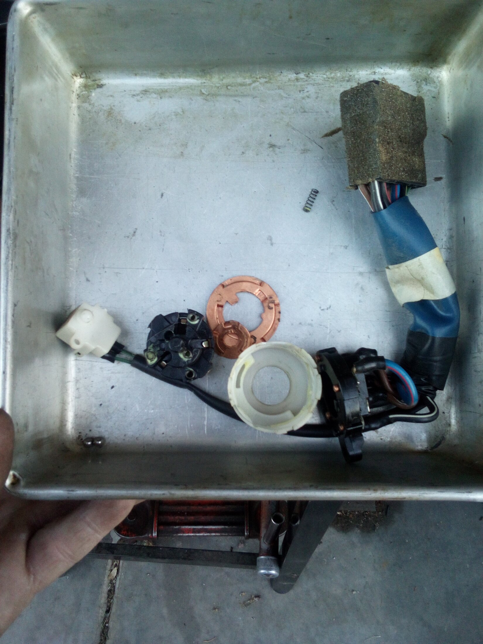

New update:
Well i took the dash all apart and replaced the ignition switch, When i removed the old switch it just all fell apart in my hand, tiny balls and springs going everywhere, Something tells me this may have been the cause of my starting issues,
After installing the new switch the truck started right up, lets hope it stays that way, Below is a photo of all the parts and pieces that came out of the old switch,
On a side note, I'm now getting close to 70 years old and climbing up under that dash to replace that switch, that's held in place by a tiny Philips screw was ZERO FUN, And reinstalling that tiny screw was even LESS FUN because you can't see crap up under there, you have to do it all by feel,
