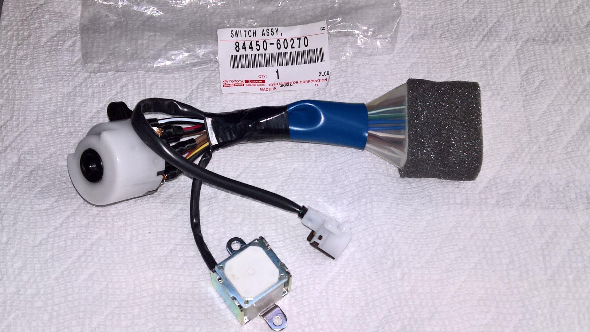

In the link to the switch you rebuilt, you show a photo of a brand new switch ( showed below) but that switch has a metal box wired to it in the lower part of the photo, My new switch (For a 94 land cruiser) came without that metal box, so what does that metal box do in the 96 and 97 land cruisers?

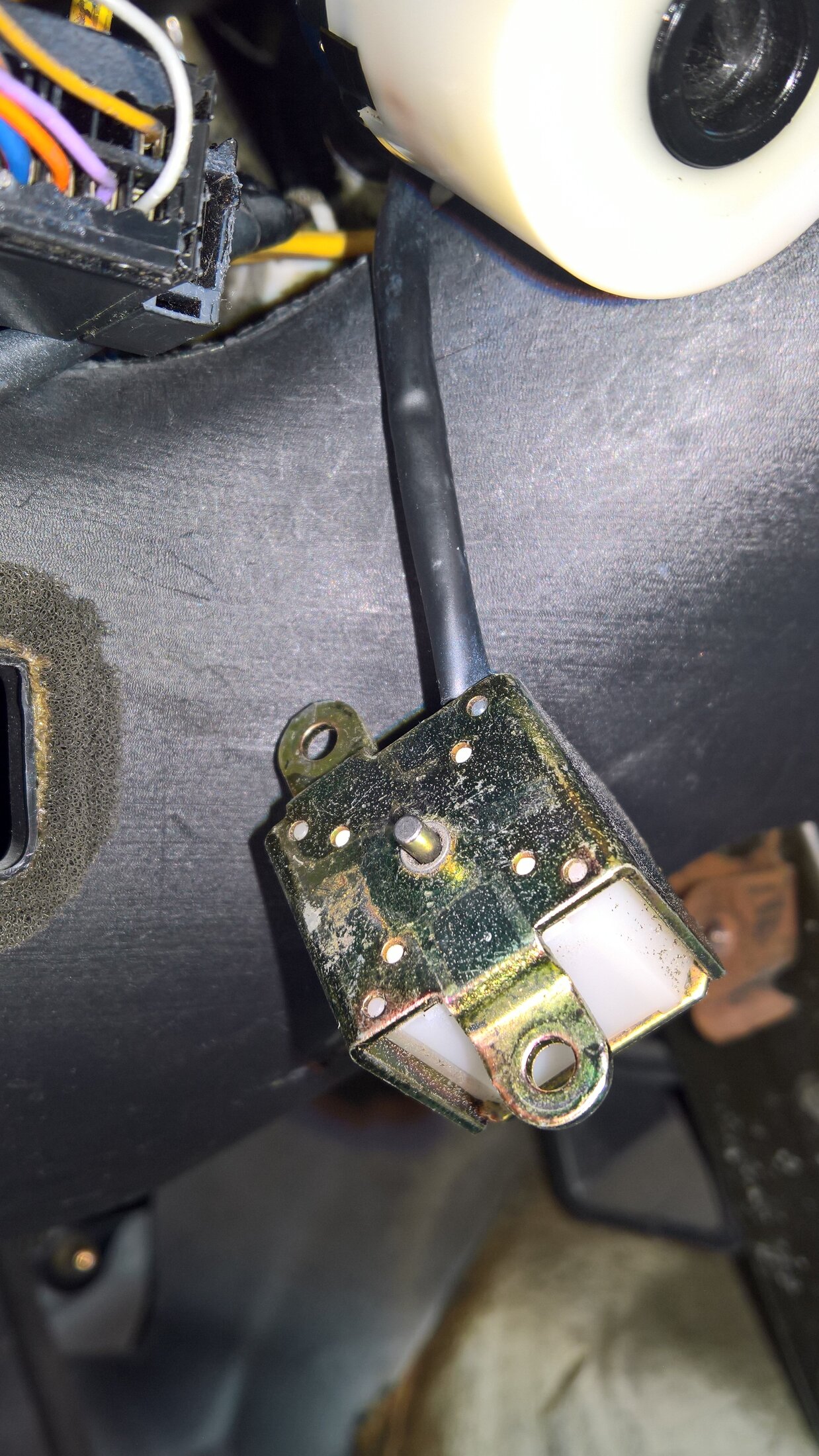

The box is attached to the underside of the upper steering (ignition) bracket where the lock cylinder is located. There's a moveable pin on the other side (see photo below) that (IIRC) protrudes into the barrel of the bracket which is then pressed in when the ignition cylinder is rotated by the key. I assumed it was part of the ignition interlock system but I've started and driven that 96 FZJ80 without the metal box attached to the upper steering (ignition) bracket ie: just dangling as in the photo below. But then again the console and shifter were apart also so no brake interlock either.
One of the electronics gurus ( @jonheld ) may be able to post up the differences in the wiring diagrams (early compared to later models) and tell us what it's exact function is.
