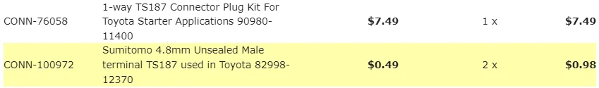

I was able to find the Toyota starter connector from these guys:
http://www.bmotorsports.com
TS187 male
the female is on the starter and a bit harder to find. Not sure why you would need to.

Toyota still sells the factory starter connector, it’s technically a female connector pin in a male housing. You can get the female connector on the starter from China.

I replaced those with new Toyota parts last night. When I installed the new terminal wires, I saw corrosion on the 2 'big' wires going into the NSS. Those 2 'big' wires carry current from the ignition switch and the starter. So now, all components of the starting system have been replaced with new in the past year, except for the main engine wire.
