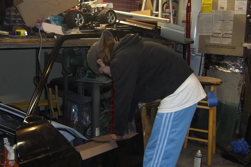

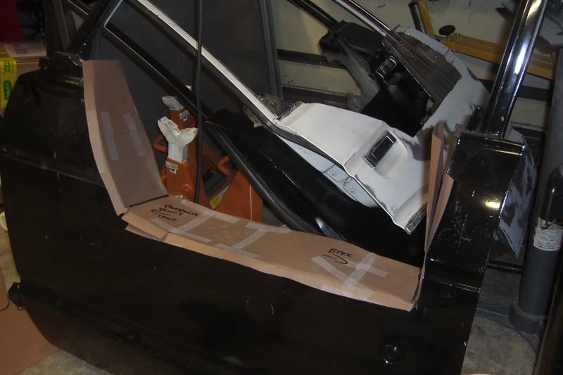

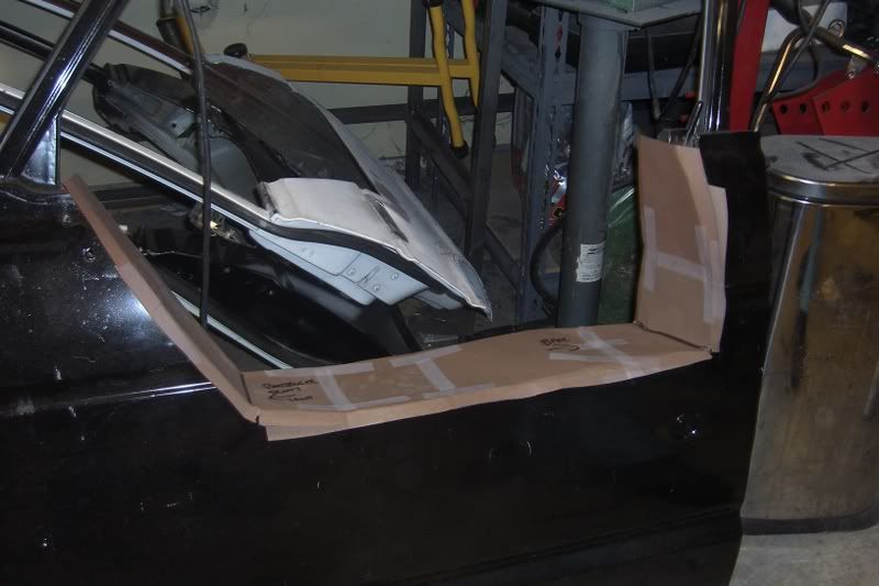

Had some time tonight... made some templates.

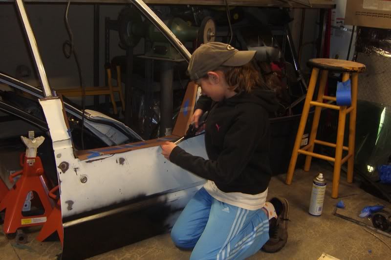

Ok ok... I better come clean. Its been a long time since I've got to play with scissors and contruction paper so I recruited someone with a little more experience. Here's who really made them for me. Step daughters are great!
busted! when she is ready to do some sliders and a front bumper let mw know. I can pay in gummy bears and ice cream..;p
clint

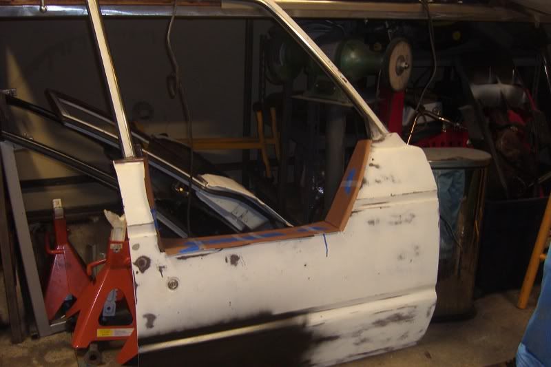

looks good guess I gota do both front doors now :doh:
remember to keep the heat down and tack move a in and tack to keep em from warpin ..... my one took forever cant even think about doin 4 :eek:

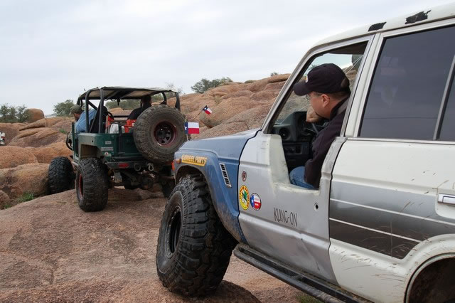

Damn, i guess youll need it to be fairly tall, thats a big tire. How much will that get into the back wheelwells, the front can be trimmed easy enough but the back is mostly necessary sheetmetal.

I cut the rear of mine to the flat part of the fender and my 38.5 doesnt get close to any of it ... the front was ALOT of work post up some more pics I want to see the doors on :D
Well, I had the rear axle moved back about three inches, so clearing the rear door should not be an issue now. I am probably going to have to cut the the rear body mount and do something a little different as the the tire will swing really close to it (reverse shackle). We'll see when I get the tire on there how much I'll need to cut.
I've already cut the front quite a bit and have a 1inch BL... the front fender shouldnt be too much of an issue due to the shackle reversal.
All and all its going to be a little work to make it work but I'm not afraid of my cutoff wheel one bit. :) I'll post some pics soon.
