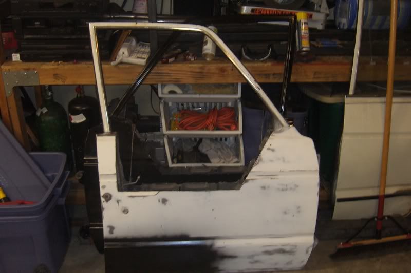

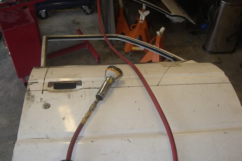

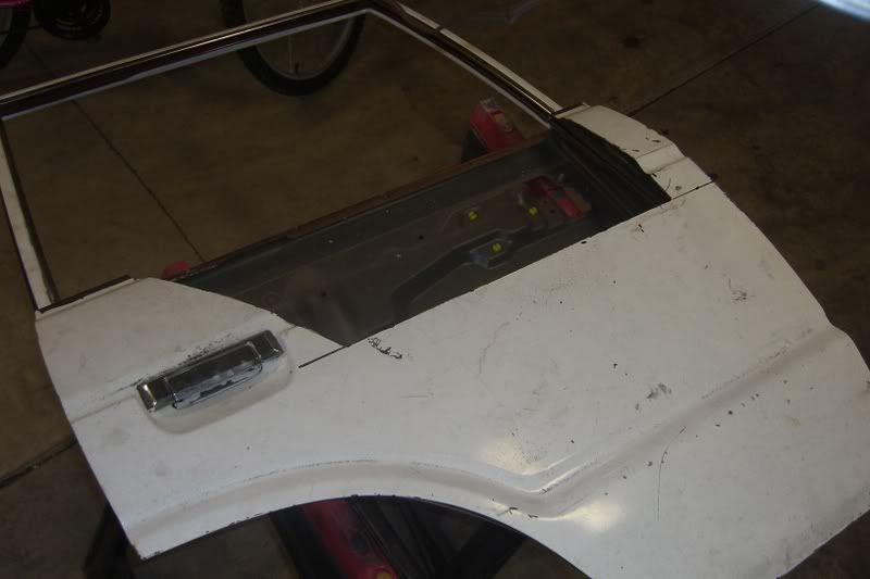

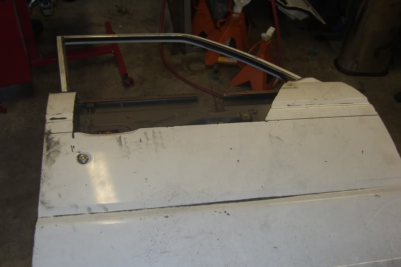

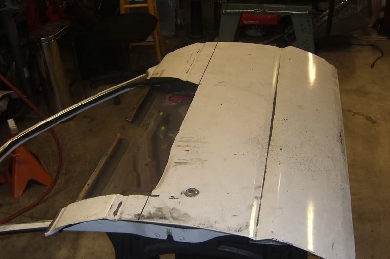

well, with the cruiser out gettin a th350 swap and the SOA and needed something to work on so I started my half doors... now I got a set of good doors and these to thrash on. here's a couple pics.

How are you gonna do the latch?
I'm going to rework the linkage on the inside latches on the front doors so they'll mount on the flat part (where the void is now) to open the doors. Hopefully I'll have enough room in front of those to make some cup holders for nice cold sodas. :) The rears will only use the outside latches (unless I feel especially creatvie).
In the rear is there a linkage that runs horizontally across the door? I ask because the lock button/tab/thing you pull up on to unlock is by the b pillar. I looks like you are planning to cut straight across below the level of the handle.
yes, there is linkage that runs across but I plan on just welding the tab on the locking mechanism to the "unlock postion" and getting rid of that entirely... shoudnt be a big deal.
