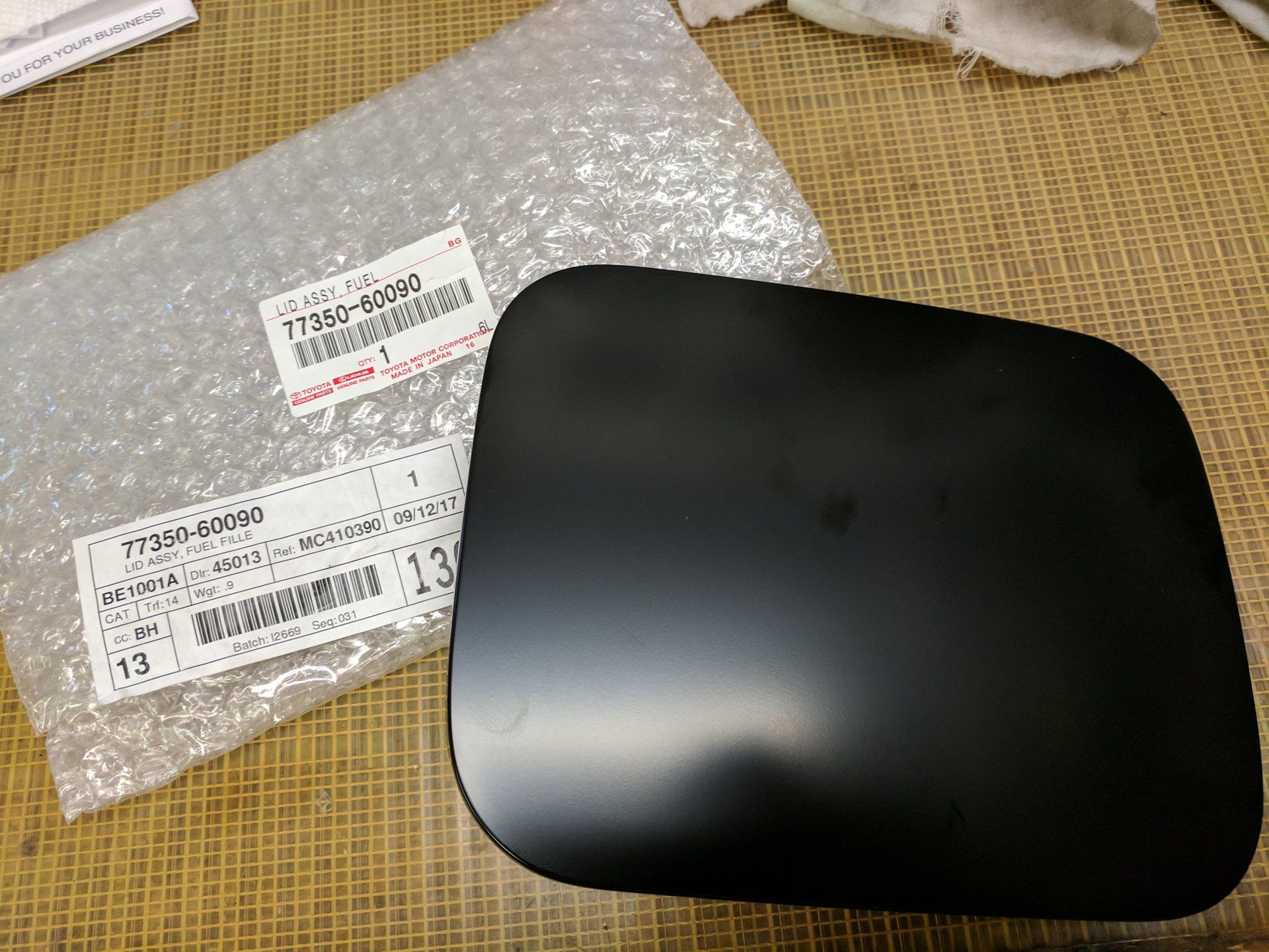

In case anybody wants to know what a new fuel filler door looks like. This is heading to the paint shop tomorrow for a fresh coat of Super White. It is held in place with some special pop rivet. Door was $41.88 from McGeorge. Shop said they would shoot the paint and install for $100.

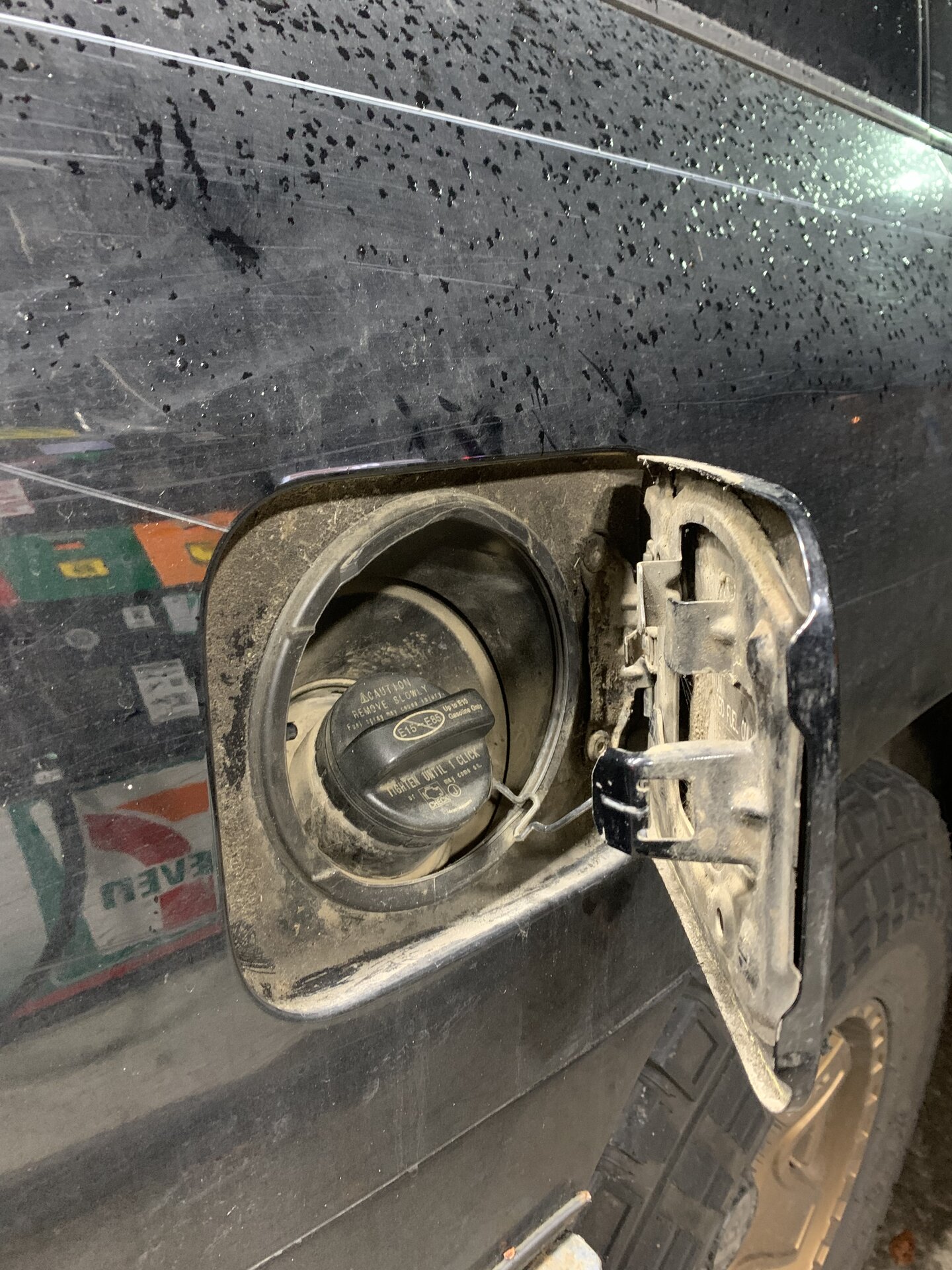

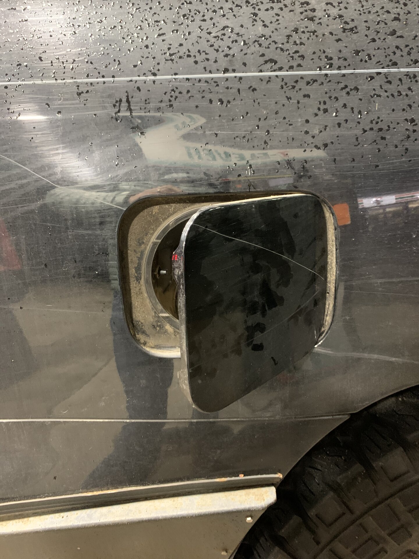

Did your door stop opening all the way? Mine only opened about 40% last fill up. I didn’t see an obvious root cause . . .

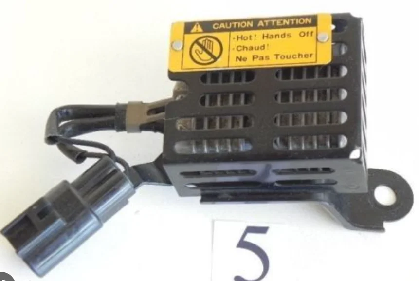

Mine look the same. Can the daytime running lights be disabled?
Yes, just unplug the DRL resister that looks like this on the passenger side of the engine bay

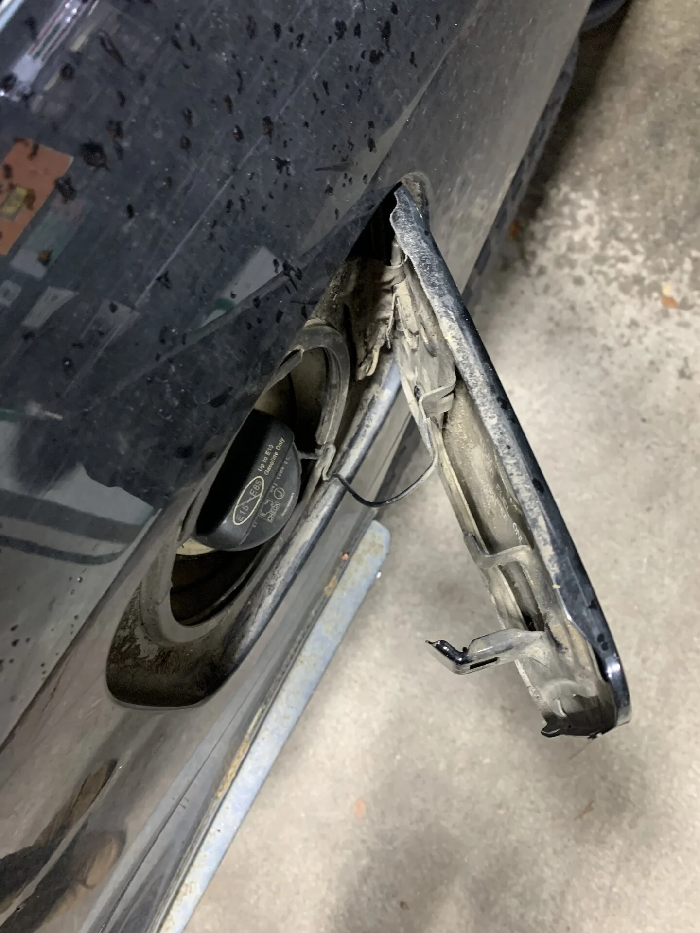

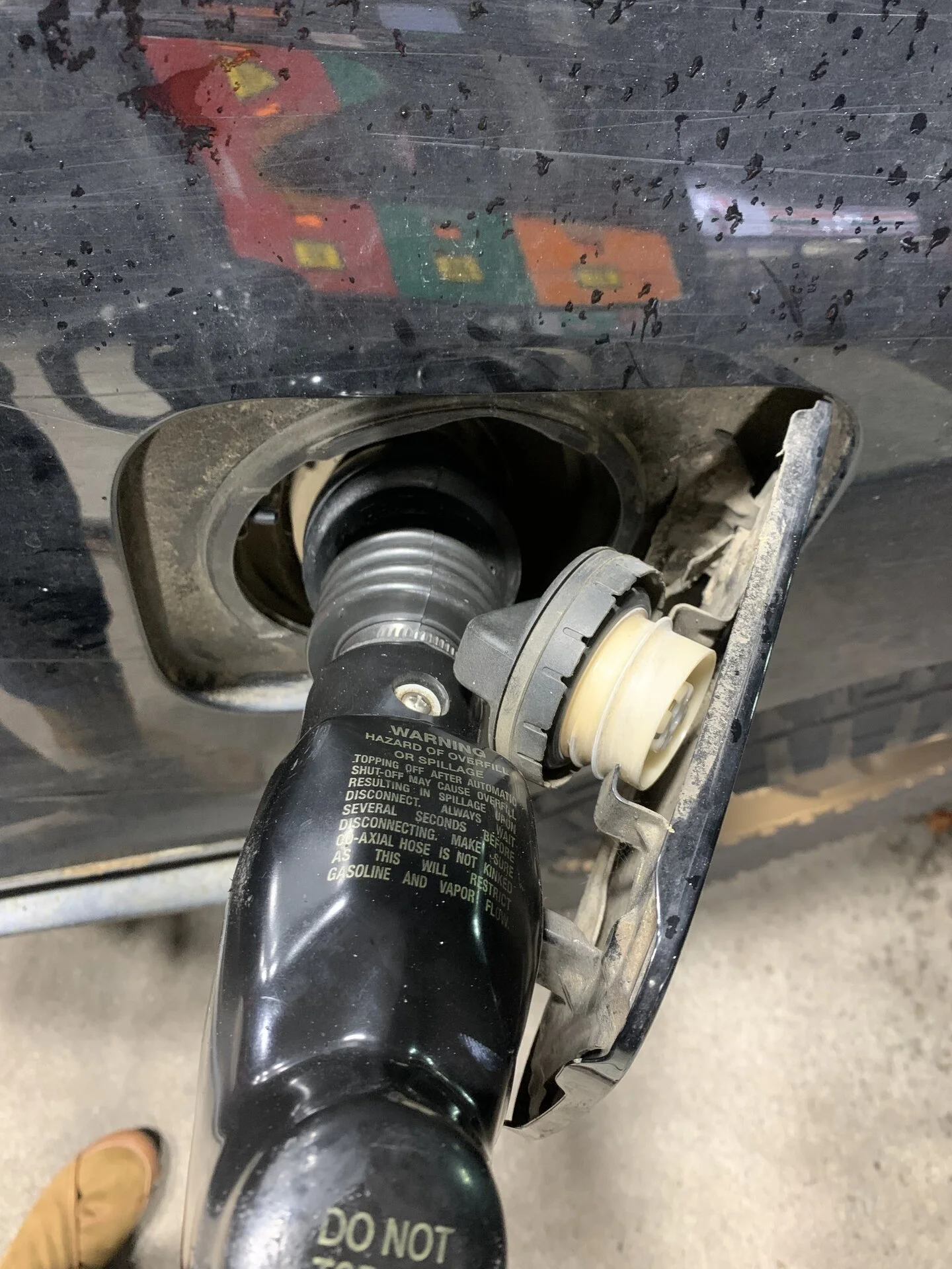

No, one of the hinges broke, so the door was drooping when I opened it. I believe it fatigued due to the hinge being stiff which caused it to break off the tab on the door. Maybe put some oil on the hinge, see if that helps. I try to remember to oil mine every time I do an oil change, when I'm doing all the door hinges.
Thanks. Yeah mine is binding somehow. I don’t see anything in the hinge. This is as far as it will go, to get it here the whole riveted bracket is torquing. It still closes flush.
Just ignore the portable trail I keep in there.
Is your door spring intact? Maybe it's bent or wonky.
I carry a spare one just in case.
Spring seems fine. It unlatches and closes fine. Just isn’t pivoting on the hinge. I’m going to order a new door.
