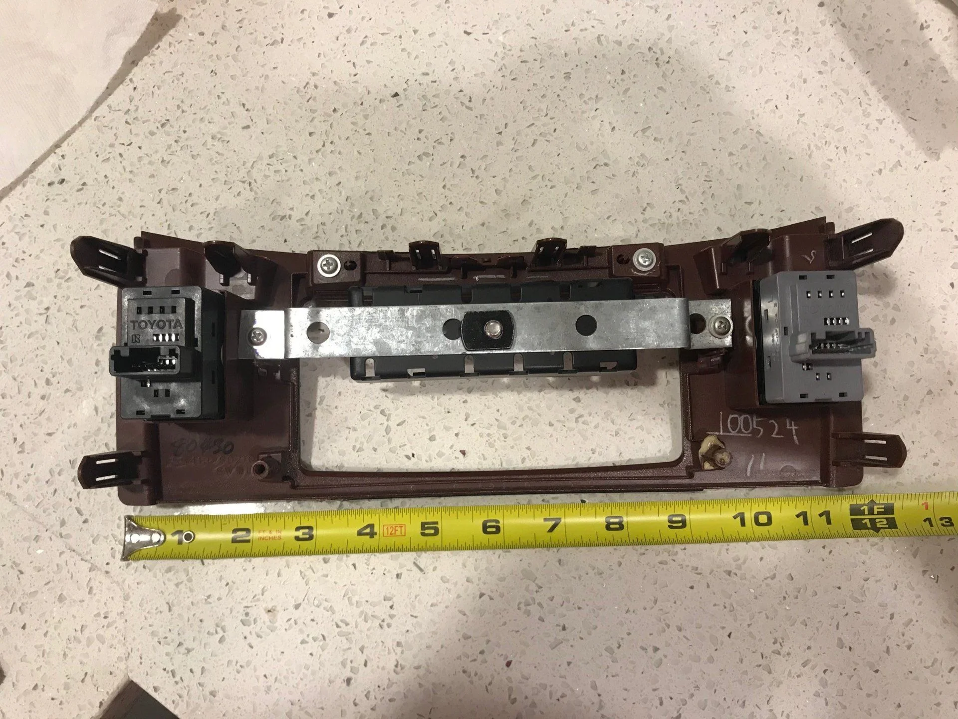

I need to remove the ashtray assembly from my 2010 LX to fix the lighter socket (not working, checked fuse). Does the whole thing just pull straight out or do I have to remove anything else first. I'm scared to death of breaking mounting clips.
I'm also open to any tips on how to remove just the socket. There seems to be two small pressed in clips, but I can't get anything in there to bend them out.
Here is the assembly (not my photo)
Pulling it requires removing the leather on both sides of the center console (the one with the start button). Then the ash tray assembly will pull out. The plug for the lighter wraps through the ashtray and out the back.
I was afraid of that. Do the leather side pieces pull straight out towards the doors? If I did manage to get the socket out without removing the panel, will the wires be long enough to at least pull it out?
they pull out at like a 45 between console and door, and you want to remove the entire panel to work on it. It’s fragile!
