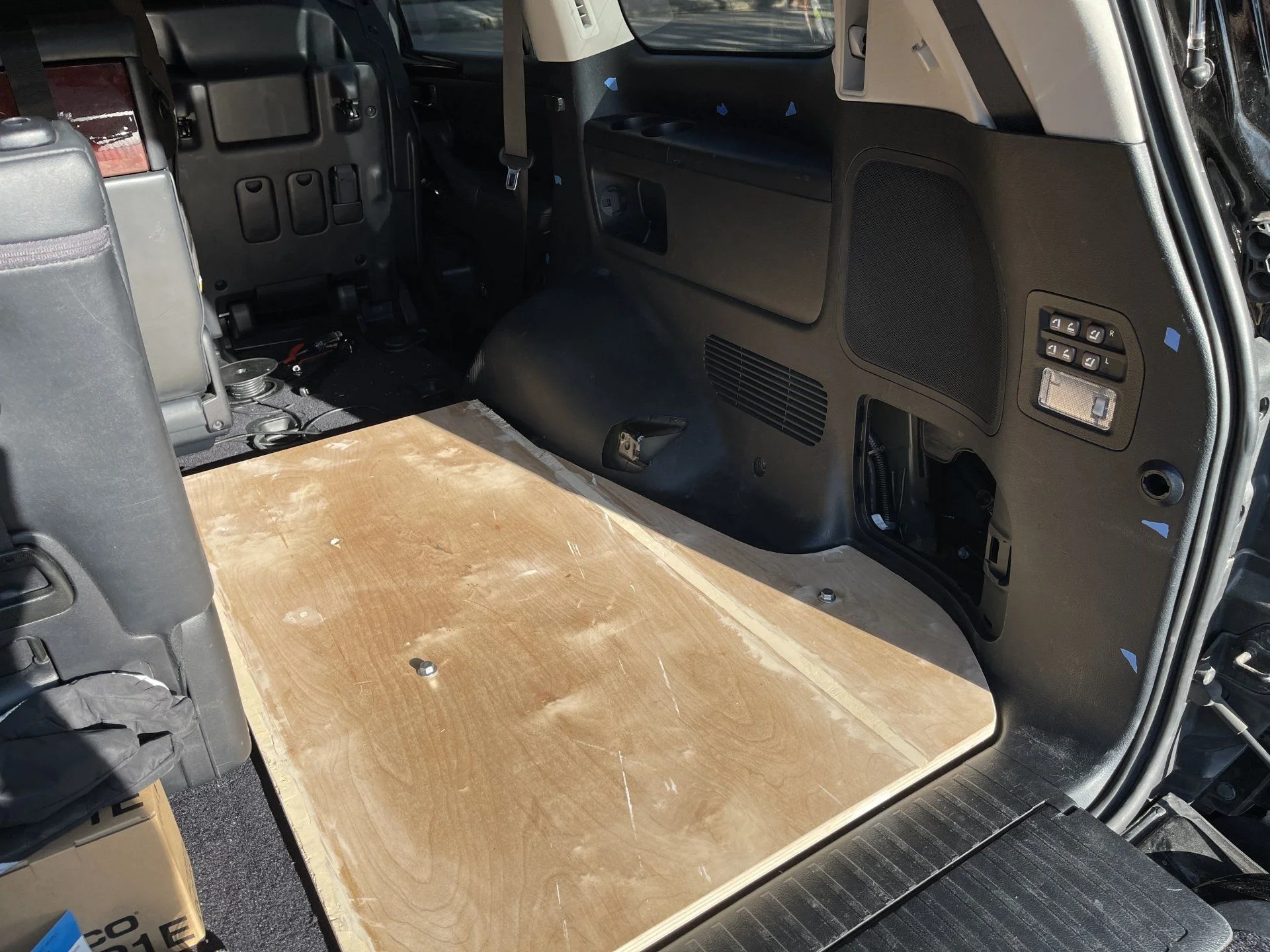

Anyone know the bolt sizes used for the 3rd row seats? I'm fitting some custom drawers and need longer bolts to mount the base plate

🤦🏻‍♂️ I just did this, but I’m only 90% sure it’s a M8-1.25 I used a 50mm and 45mm length.
Home Depot had them in stock

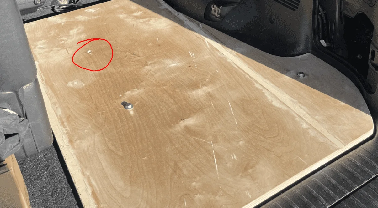

sorry! i just checked and they are M10-1.25.
the two bolts in the picture are 50mm, and I needed a 60mm for the one circled in red. However, i'm using a 3/4" bottom, so YMMV

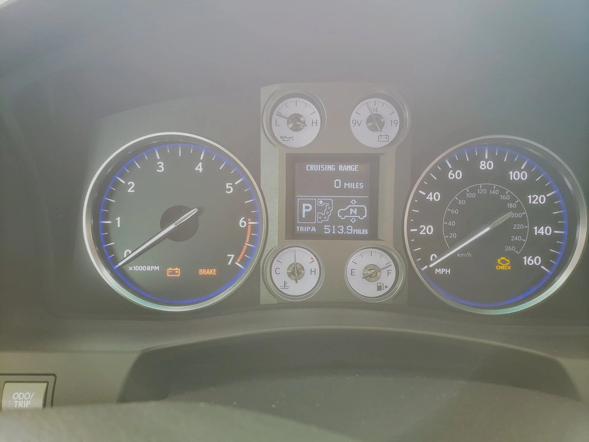

I did a distance to empty test, running the tank to engine stall. I was able to travel 45 additional miles after the counter saying 0.
45 (local) miles at a typical ~11mpg city for my modified vehicle, represents 4.09 gallons left after the trip computer says 0.
With 4.09 gallons reserve:
Best case for a stock vehicle on the highway @18mpg = 72 miles.
Worst case I've had towing/headwind/hill @8mpg = 32 miles.

Thanks is what I was wondering .. so approx 4 gallons plus my 19.6 means 23.6 usable.
