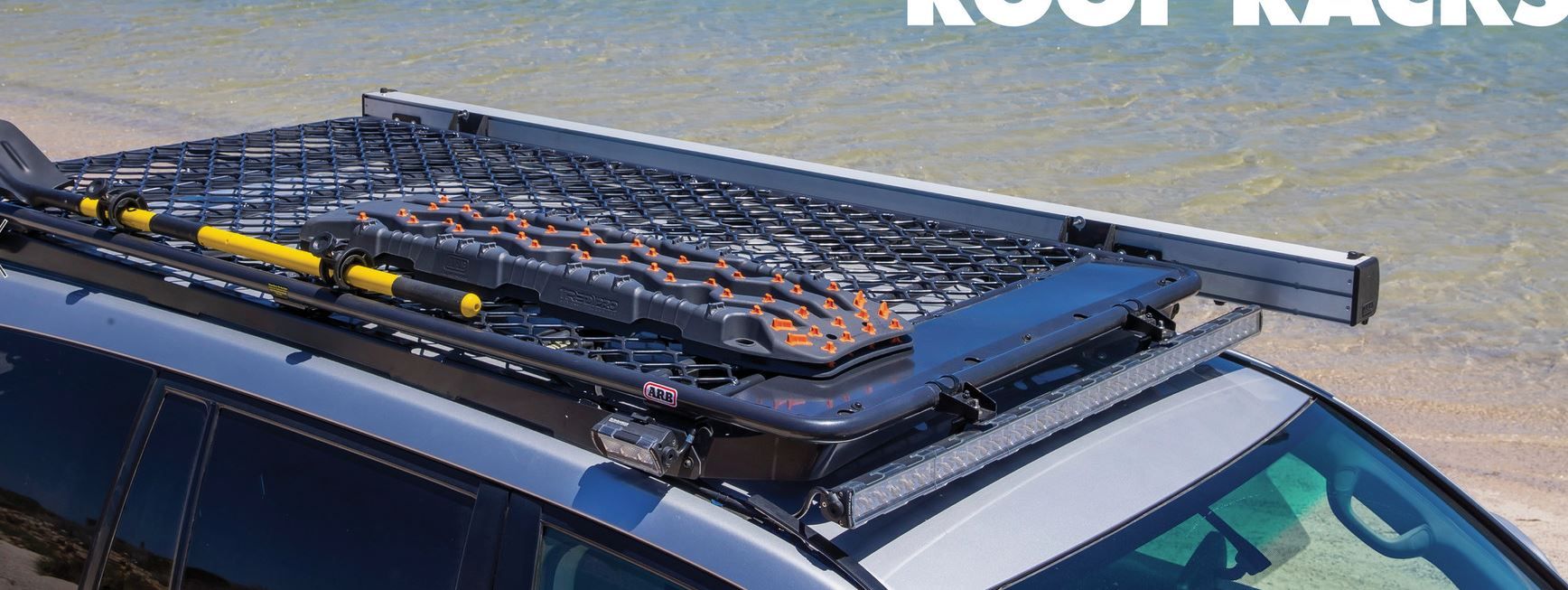

What Light bar is this on the front of the arb roof rack? I couldn't find it on the arb website, and this pick is from the arb catalog.
