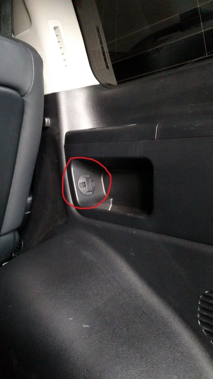

LX 570 owners...what's in your cookie holder? (powered 3rd row sear switch?)

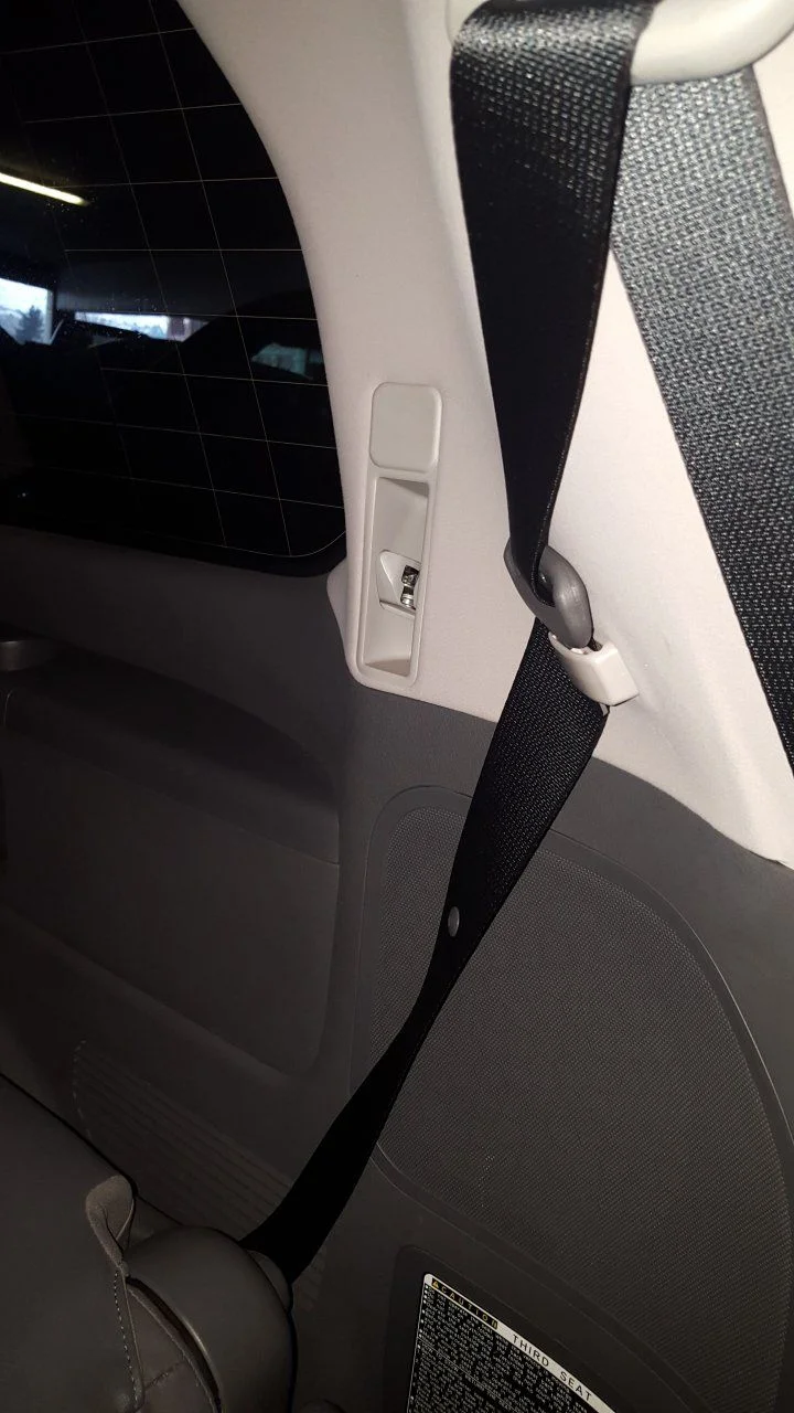

I'm not sure what is there on the LX. I'll have to take a look later today. I DO KNOW that it is not the switch console for the 3rd row seats. That is much bigger, located behind the 3rd row on the right hand side, and is square / rectangular. If I remember correctly, it is about 4"X4" in size, so definitely not this little guy. I'll take a look at lunch to see and post back up.
Isn't that one of the locking point for the third row seat?

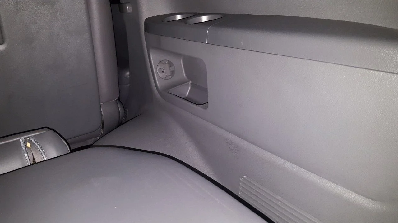

So, I walked out to my 2010 LX to see what was exactly there...
As to the 3rd row locking mechanism, no, this is not it. That is much higher and more towards the rear of the vehicle.
What did I find? That mine is EXACTLY the same as the original photo... but grey.
I always assumed they were a blank insert for US spec vehicles. I thought that maybe euro spec or oceana spec got 12V sockets there. Just a wild guess.
It's a bottle opener

CodyAustin was probably right - a temp sensor. As I was connecting a D-Ring, I pulled it out accidentally. It has two wires connected to it and is certainly not affixed tightly enough to be even a light tie-down. Don't waste your time.

I've got one on each side of my '13 LC. If you know (or remember) the wire colors, I can probably find out what they are. Temp sensors sounds reasonable.
Steve
Thanks Steve. Red and green.
They're "room temperature sensors", one on each side, for the rear heating and a/c. Check...GSIC - Global Service Information Center
