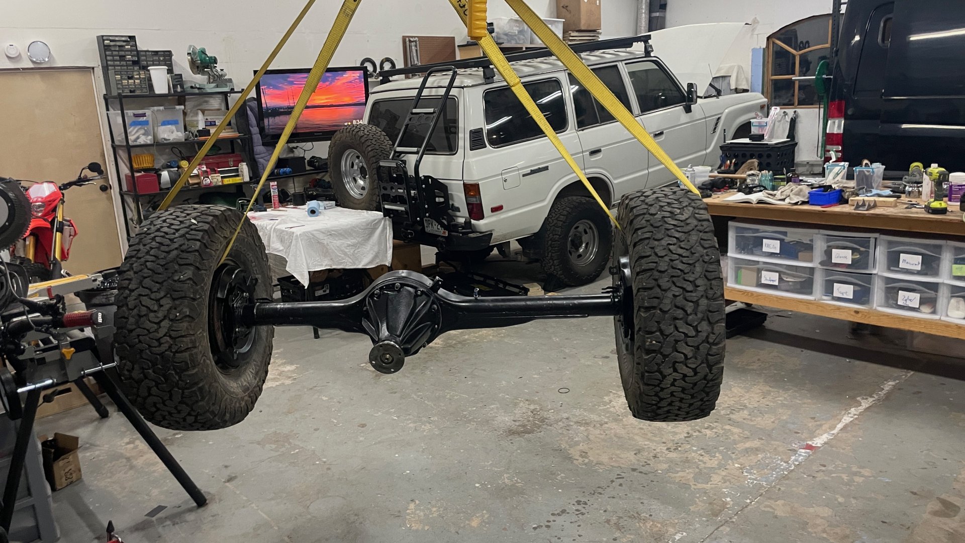

Hey all, long time lurker, first post tho...
I'm swapping in a FZJ80 rear axle into my FJ62. I ordered new spring perches to weld on from trail gear, but comparing them to the stock perches, they are an inch slimmer. The stock spring perches are 3.5" wide and these new ones are 2.5".
Does it matter? I've looked all over for either an answer to this question or a 3.5" wide perch for a toyota axle and can find neither....
Any insight? included a couple pics of the perches (and a couple of the axle rebuild for fun!)

I had a friend who ran spring perches that were a lot narrower than his springs. He had a lot of issues with springs killing themselves fast and twisting around. That was on a Jeep YJ, which is much lighter than an FJ. I'd try to find or make wider perches.
EDIT: The FJ62 spring perches are extra wide because the u-bolts pass through them. That isn't strictly necessary. As long as your perch is as wide as the leaf springs themselves, you should be fine.

Yea i feel like it pretty sketchy to have 1/2" gap from the u-bolts to either side of the perch...
My leaf springs are 2.75" wide but theres a metal guard (see pic) around the leaves that makes the whole stack roughly 3.5" wide, thus the stock perch is the same width. U-bolt c-c width is ~4.25"
So I'm just stuck on what to actually do? Does anyone know of a 3.5" wide perch? or do i need to get a new ubolt assembly thats skinnier? Is that little guard around the leaves necessary?

Interesting stuff, yea this is all from the previous owner who lifted it a while back. That little metal shim is like an angling shim, i assume that was installed with the lift to tilt the diff up, but its too narrow and has twisted around on the pin
I think i just need to get rid of all that crap and order this kit from ruff stuff? Do y'all think this will work? the perches are 1/4" wider so they'll fit the springs if i get rid of that u-shaped cap, I dont think i need that at all, correct?
