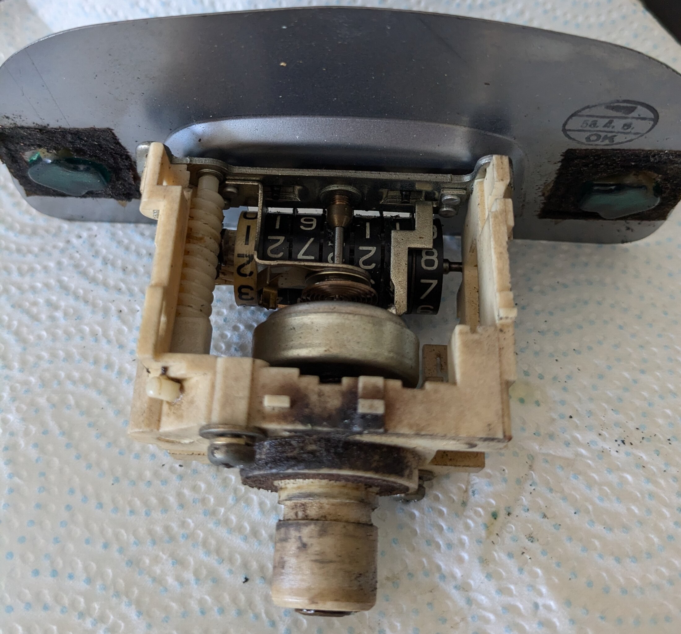

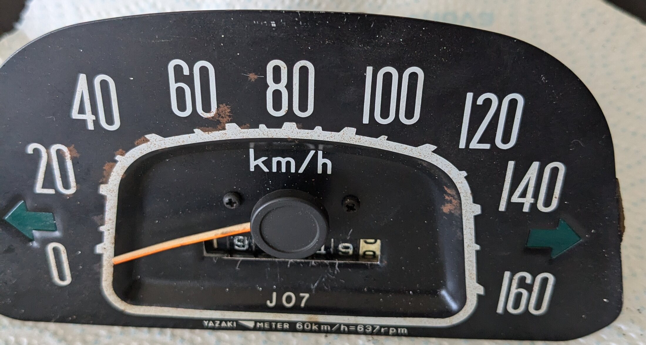

I have a 1981 BJ40. The speedometer is part number 83110-60014. Only the white wheel is turning. I have ordered a new one (from Japan), but would like to fix this one. Can anyone help?
Common problem. The reason can be two-fold.
(1) The factory grease has solidified. Sometimes, a gentle cleaning and light re-greasing will fix it.
(B) Sometimes, the little tab on the white dial wears down. I moved my white dial to the other end of the rotating assembly and made it work.
Grease had solidified. It does less than 200 KMs per year so the other dials have not rotated for the longest time. I took it part, figured it out, or so I thought, and put it back together after applying some anti seize. Will need to do it again... when the white dial reach 5... the black dial rotates :) Thanks!

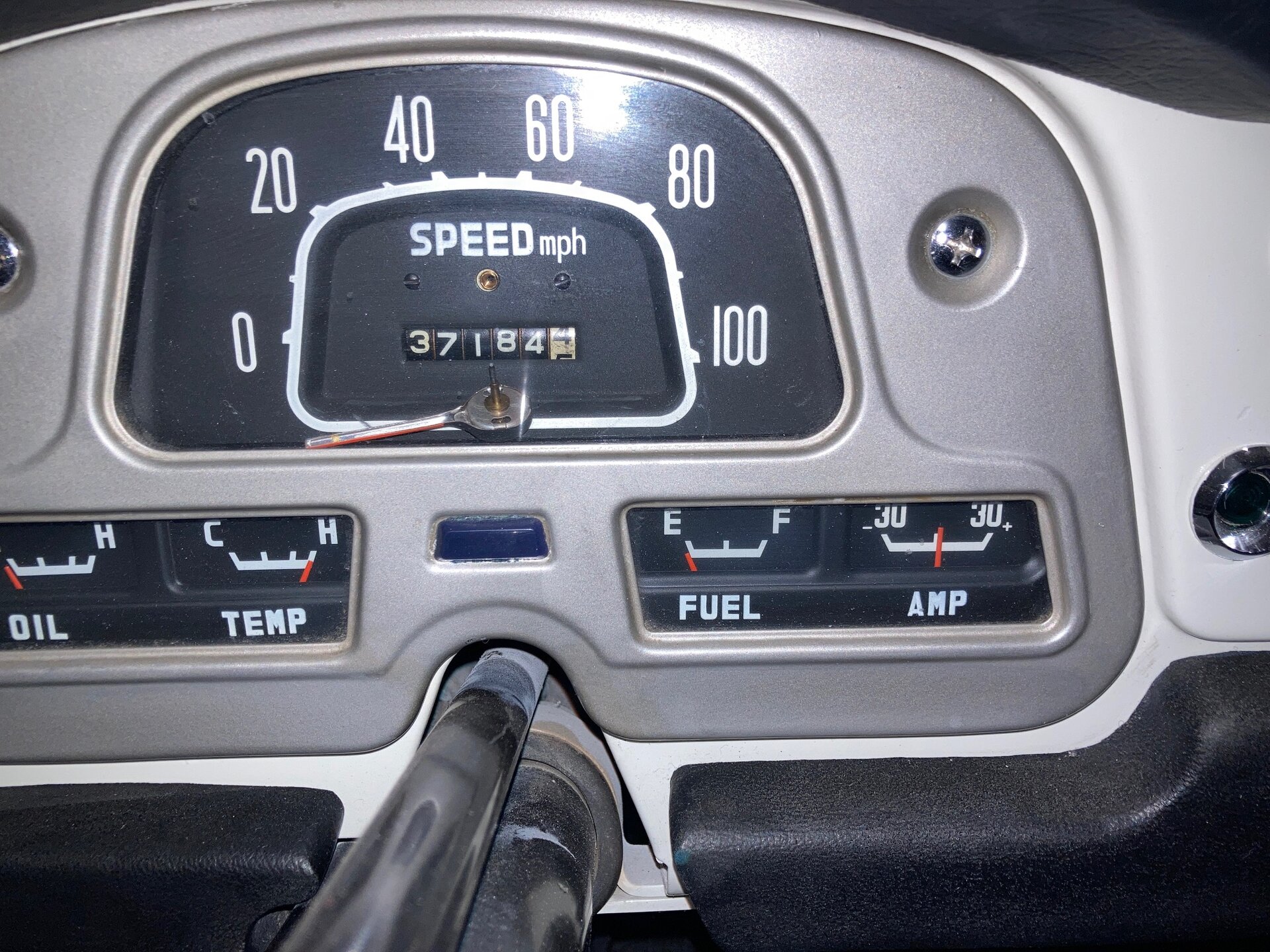

Thanks @devo and Jack! You are correct Jack. Before I could get the speedometer cable disconnected, the needle spun off of the speedometer. It is now laying between the glass and the speedometer plate. I cannot tell if it is broken or spun off. There is a shaft on the needle. I will take a photo and maybe you can tell if the needle is broken. I cannot dig into the repair right now, but I will keep your contact if that is ok with you for later work. I have an extra speedometer when I thought my original '69 was broken a few years ago, but a new cable seemed to fix my problem until yesterday. The extra speedo I have is from a later FJ40 model (maybe 72-74) since it has the newer connector, while mine has the pin with the screw cap that goes into the back of the speedo. Maybe I can use some parts from it to fix mine.View attachment 3279595
FYI... Based on my limited experience, I believe the speedometer needle has merely come loos and it can be pushed back into the shaft. I have pulled my needle off and put it back successfully before. It is necessary to remove it to paint the Speedometer face.
