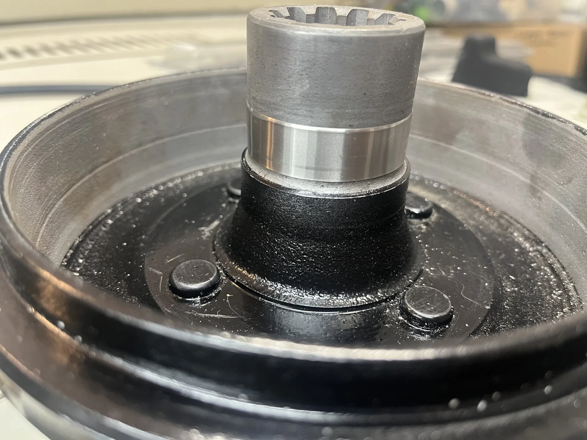

I purchased a Speedi sleeve from SOR. The included applicator does not seat the sleeve in the correct position. Do I find a way to seat this down all the way or…..?
Help me out friends.
Help me out friends. View attachment 3461394View attachment 3461394
Are you throwing on a dual seal housing? Many vendors offer the seal housings machined for two seals. This moves the sealing surface location to “fresh” metal. Another option if you want to add suspenders with your belt. They are avaliable from Marks Offroad, Cruiser Brothers/Valley Hybrids, Cruiser Outfitters, and likely also SOR. Good luck!
Looks to be in about the right place to me.

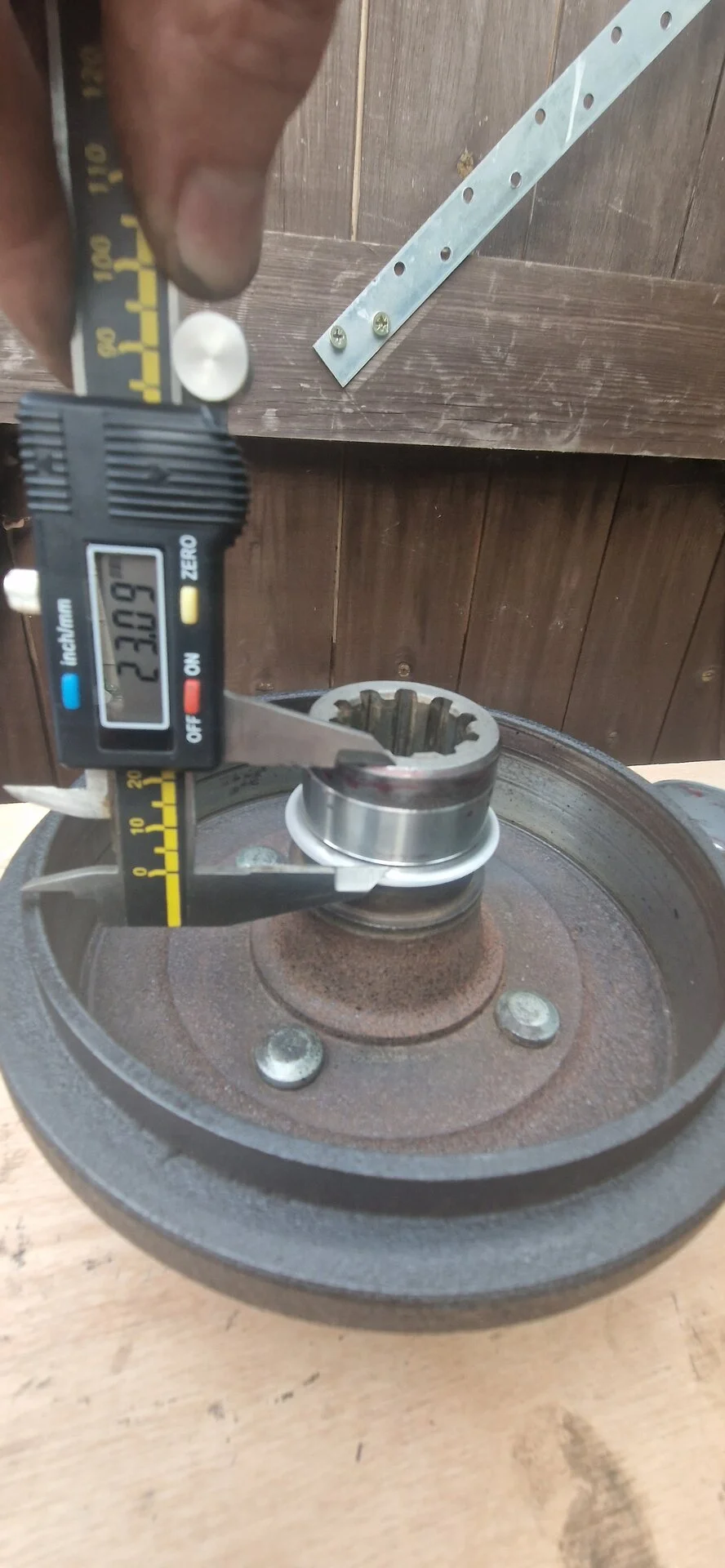

Either your seal is in a very different place to mine, or you didn't manage to scroll through to post number 14 in the thread I posted above which demonstrates that the tool is the correct depth to position the sleeve at exactly the right point on the shaft...?
I'm curious why you claim success, what happened to the flange on the speedi-sleeve? Also, have you verified that it still fixes the groves in the snout? Has it been installed and no longer leaks?
Ill let you know. The sleeve covers up the location that was previously worn out. Install tomorrow hopefully.

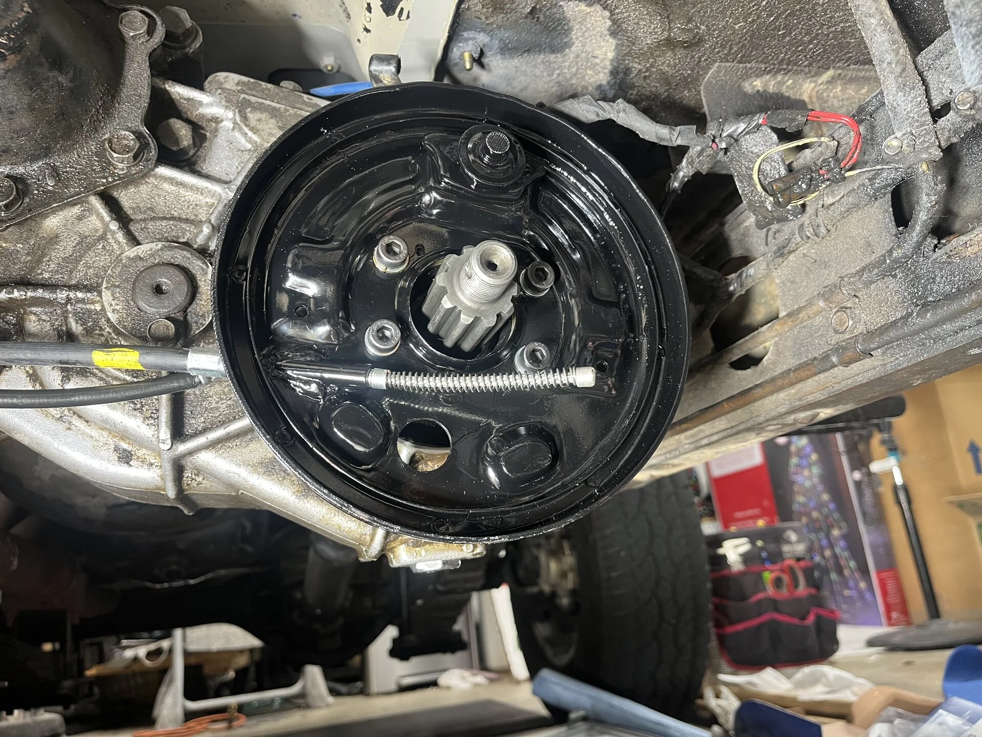

If the groove is right down at the bottom, then that isn't caused by the seal; it's caused by the lever arm rubbing against it due to excessively worn shoes / over adjustment.
Yeah that lever arm wear is fairly common. I’ve got a drum sitting on the shelf that’s mega worn in that low spot on the spindle. I‘m guessing there was actually a lever arm failure somewhere in it’s past (pre-me).
Tbh it was never completely clear to me what causes the lever to touch the shaft - does one of the pins fall out??

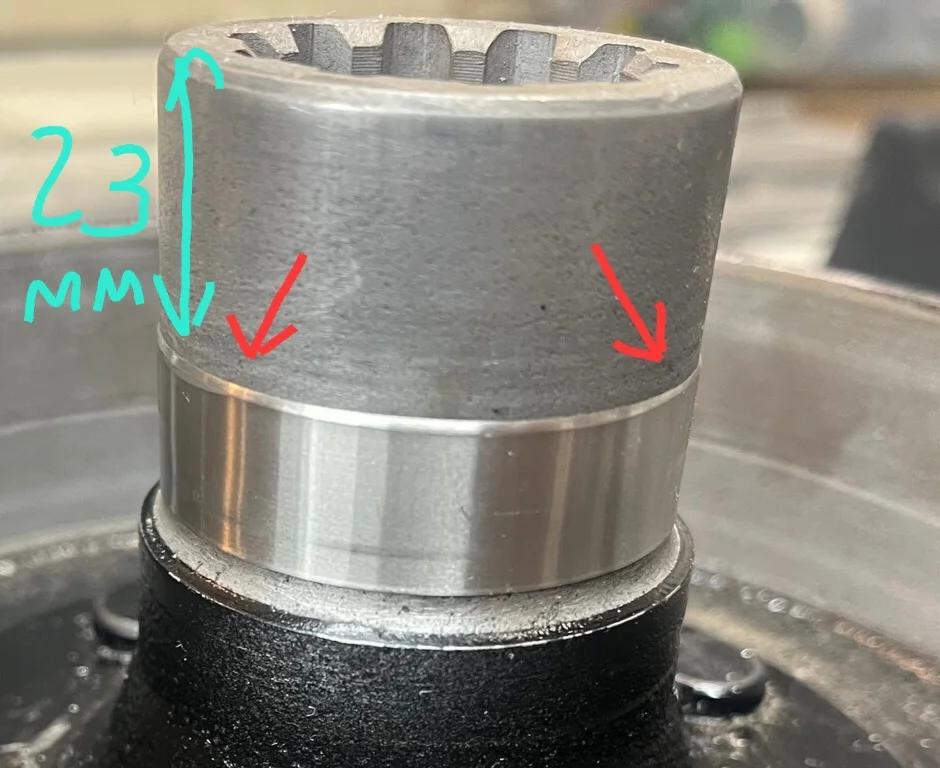

I measured 23mm from the top of the shaft to the outer seal face. The contact point with the seal lip is a few mm above that (say 19mm).
You might squeeze a second sleeve on top without removing the first.
I've highlighted the seal wear in red - mine looked identical.

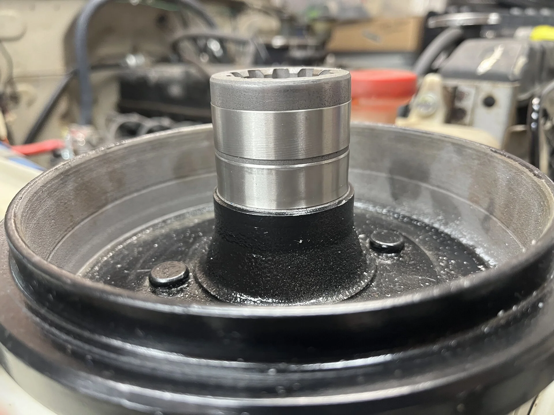

Update. Clearly Im not very well versed in these things. So the deepest groove was right at the base, and was probably from the lever arm. I filled it in and drove the sleeve over it to keep it protected. Speedi sleeve two was driven into the correct location. The wear was minimal but I still wanted a sleeve over it. Double seal in the speedo should help as well.
Looks great.
They're not cheap, but I think it will be worth it.
With the double seal too, it should last at least another 40 years now :)
