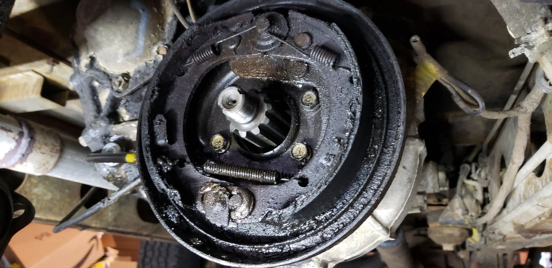

My '73 FJ40 (3 spd) has been dropping a oil from the parking brake housing. I removed the drive shaft, parking brake housing and flange that's connected to the transfer case, and tracked it down to oil coming through where the bearings are(sorry - don't know the name of the part).

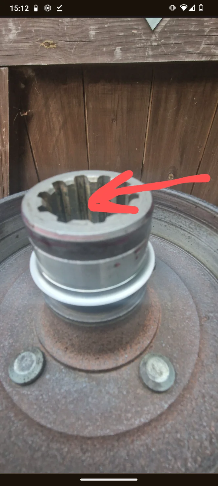

Does the silicone sealant go in here? (see pic)...
Thanks.
Correct, that's where the sealant goes.

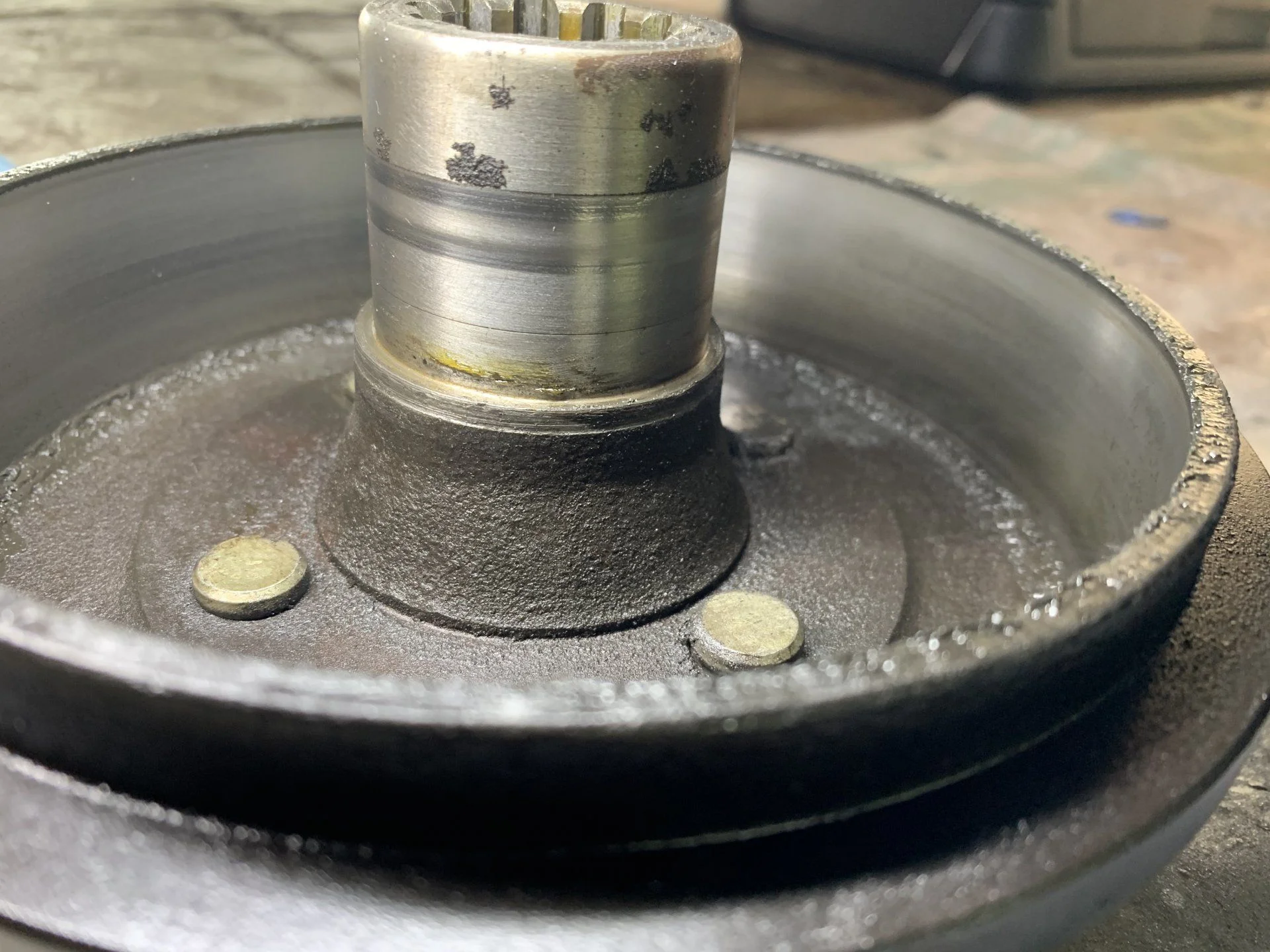

You only need the speedisleeve if the shaft is worn. The purpose is to make the shaft round again and smooth as it was originally. Its a tight fit on the shaft once its hammered on.
As you'll see on mine, there wasn't a huge wear mark on the shaft but it was enough to damage the seal and make it leak, so best to just buy it before you start.
