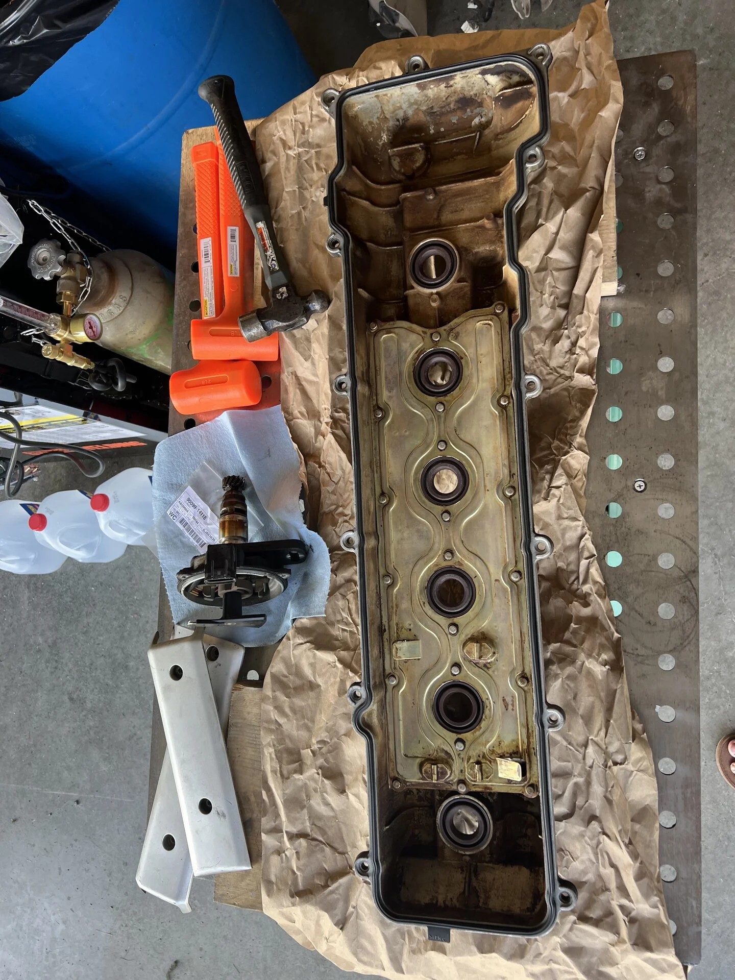

Spark plug seals are oil seals that are pressed into the valve cover and a logical time to change them is when you service the valve cover gasket. They get rigid and brittle over time so can break during removal, but it is no big deal. I press new ones in with an appropriatly sized socket and dead blow or ball peen hammer. This is DIY territory.

anyone got any pics of the spark plug tube seals and where they are located or how they go in?

Big thing to watch for is to install the tube seals in the correct orientation, IME it helps to lube them with some silicone both for installation into the valve cover but also when you reinstall the valve cover to the head. Make sure the valve cover gasket doesn't fall out of the groove and get pinched when installing. I use silicone grease (dielecric or similar) to help hold it in place. FWIW.
