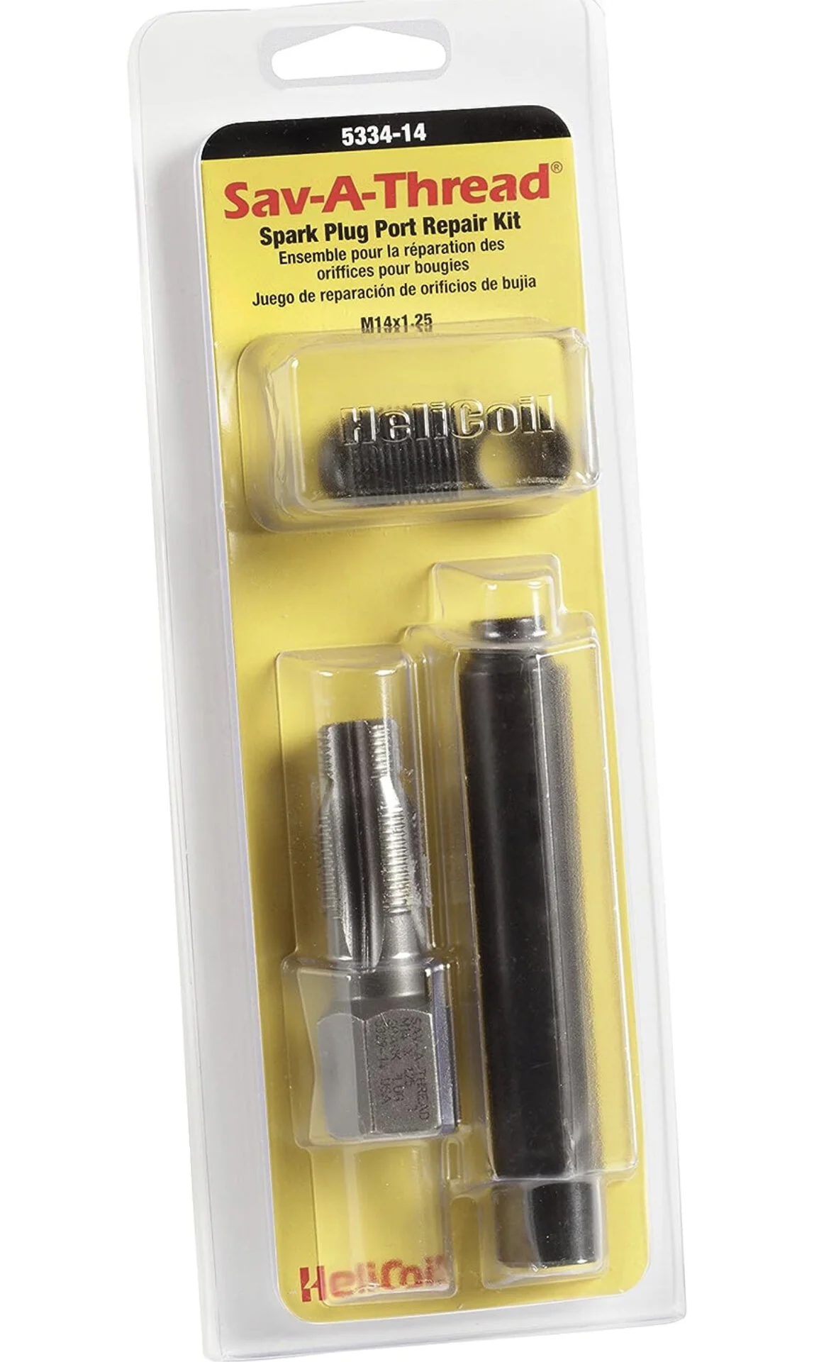

You'll probably get better info in the 200 forum for a 2010. Its possible it could be fixed with a helicoil.
Can you tell us a little about the circumstances? What were the symptoms? Was other work being done on the car when this was “noted”, or was there previous recent work that would have involved the spark plugs?
You can do a helicoil with a new spark plug.
See the YouTube video. Should be able to do everything at an auto parts parking lot.
Haha, first time I’ve seen a one piece helicoil. Looks like a 2 step Timesert imposter. I recommend you watch a YouTube episode of a Timesert installation so you can compare, then you decide which is better.
Blew #5 spark plug in our 2004 Land Cruiser in 2021.
Replaced with Helicoil and running just find. Been over 20K miles since repaired.
We never heard back from this one time OP w/2010? poster. I'd assume he had onboard thread insert repair.
But, the video posted above is interesting.
For one he used anti-seize on spark plug threads. Bad idea!
I've never done a head thread cert. Hope never too do one.
