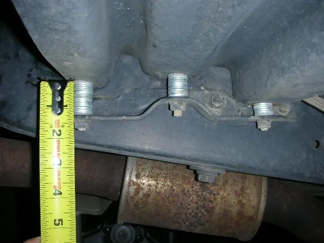

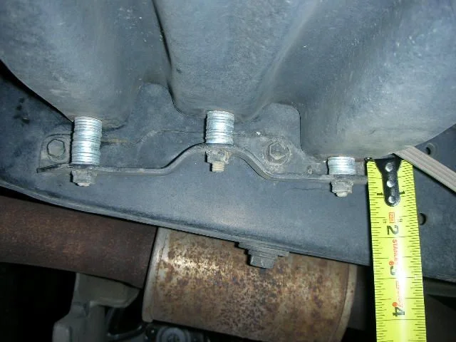

I lifted mine more at the front so the tire now sits alot more level than stock. I didn't have to do anything with the tire winch. My spare is a 315 Toyo M/T. This is only until I build my rear bumper.
From a previous post:
I used 2 1/2 inch x 1/2 inch cast iron pipe nipples with 90mm bolts to raise mine. I used 2 inch x 1/2 inch cast iron pipe nipples with 80mm bolts to lower the crank(the hardware store didnt have any more 90mm bolts). Home Depot and Lowes only went up to 60mm bolts.
You wont be able to go up over 2 1/2 inches. The rear part of the tire hits a brace in the back near the bumper. It does tuck the front up quite a bit though.
If you can find more 90mm bolts, then use them.
6 bolts for the bracket (3 on each side)
6 pipe nipples for the bracket
4 bolts for the spare winch
4 nipples for the winch
Couple extra just in case...
