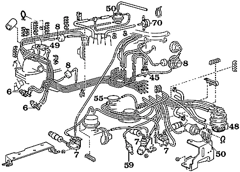

I don't know if it's because the air cleaner is off, but the two nipples on the distributor cap are open, as well as the 'T' on the PCV line - If those are open when normally running, it's sucking unfiltered air into the engine, plus it's not clearing ionized air from the distributor which can lead to bad corrosion of the metal parts.
…I actually did not know that about those two nipples on the Dizzy. I always wondered if those were supposed to be closed off or open. Anything special I need to close them off? I may have to take the cap off too, just to take a look. I have a new cap (as far as I’m aware it’s new) and the PO put a new rotor in.
Also, yes, the PCV valve T is open because the air cleaner is off. 👍🏾
Don't close them off, they need to be plumbed in with the valve under the air cleaner that goes to the T on the PCV line so the dizzy can breathe. There's a diagram in the Emissions FSM how it's hooked up.
# 70 is a small filter on the inside firewall passenger side that sticks its nipple thru the firewall
There's some pictures here: FJ60 idle help and PCV question - https://forum.ih8mud.com/threads/fj60-idle-help-and-pcv-question.1281537/
Funny that you mention that about #70. I actually don’t see that nipple you’re referring to. 😅

Yeah, that's all messed up. Gonna need to study the study the Emissions vac hose diagram in the manual and check them. Not uncommon for them to be wrong.
I think that smaller hose was supposed to go the outer nipple on the dissy vac advance, but not sure.
The hose from the firewall goes to the larger nipple on the dissy cap.
I’ve printed out the ESM so I readily have it on standby. I was originally looking through it because eventually I’m gonna do a desmog.
Thank you nonetheless, and I’ll get to it. I can simply route the larger hose to the dizzy, no worry. Definitely will have to find out about the smaller one. It doesn’t quite reach the outter nipple on the vac advance, BUT it could be that it’s simply the wrong hose. And thankfully I have quite a few new ones on-hand.
I believe I had the dizzy vac advances hooked up properly; I just had the vac hoses disconnected and out of the way while I was doing other things over there. But I will need to find the proper hose for that nipple on the dizzy cap.
