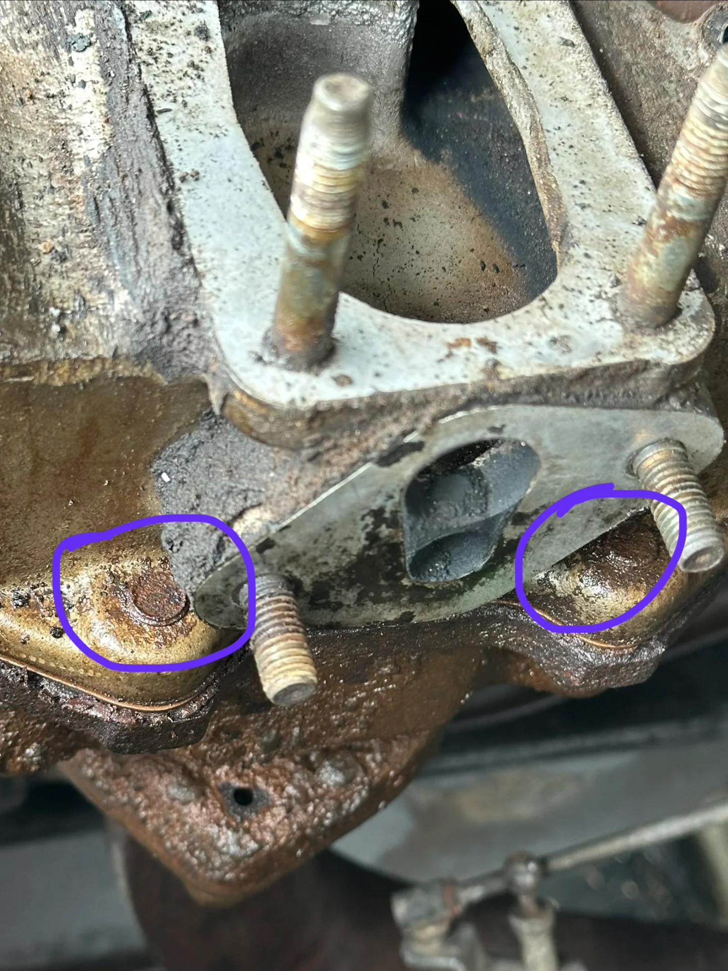

I’m beginning to take the intake manifold off, just hitting the bolts with some pblaster and whatnot.
Ah! If you're taking the manifold assy off, then doing the rear block off plate is a breeze, even if you break one of the small studs. If you can't get what's left of the stud out, any machine shop can do it for $20
With the manifold off, it might be a good time to replace or have replaced those two rear horn studs - you can see even in Jim's website pic, the studs have broken off... If you can get the studs out, some people with the de-smog, use bolts with a lock washer and you should never have an issue again.
Yes, I’m taking the intake assy off - I was going to give it to a machine shop to get the surface flat again per Jim’s recommendation when I spoke to him on the phone. That might even solve the alleged vacuum leak I believe I was having and trying to track down too when I put it back on with a new gasket.
I will keep an eye out for those rear studs (praying they don’t break 😂).

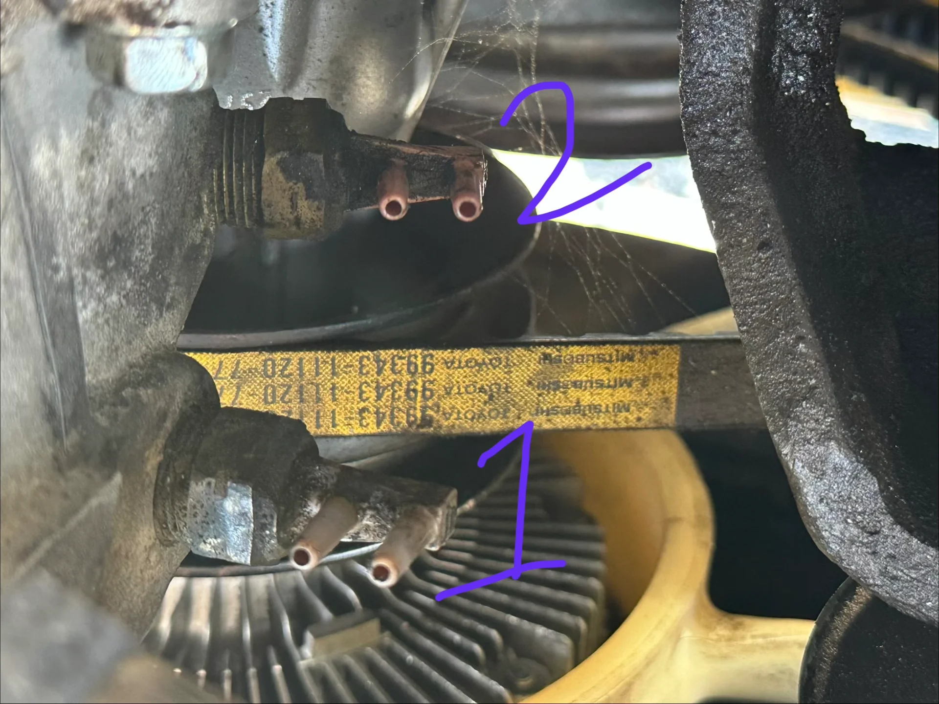

I wanted to ask a question that I don’t believe was covered in the Desmog thread that’s attached to the guide: With the removal and subsequent plugging of “BVSV 2”, does BVSV 1 just be left as is with no hoses connected or anything?
Hopefully someone who's done the de-smog can answer, but I thought one of the BVSV gets used for the Carb choke or choke-breaker, but if you're having your carb rebuilt by Jim C it's possible he removes that (breaker) ?
I’m having it rebuilt by Jim. In fact, I’ll ask CruiserTrash and see what he tells me. Perhaps I might be missing something.

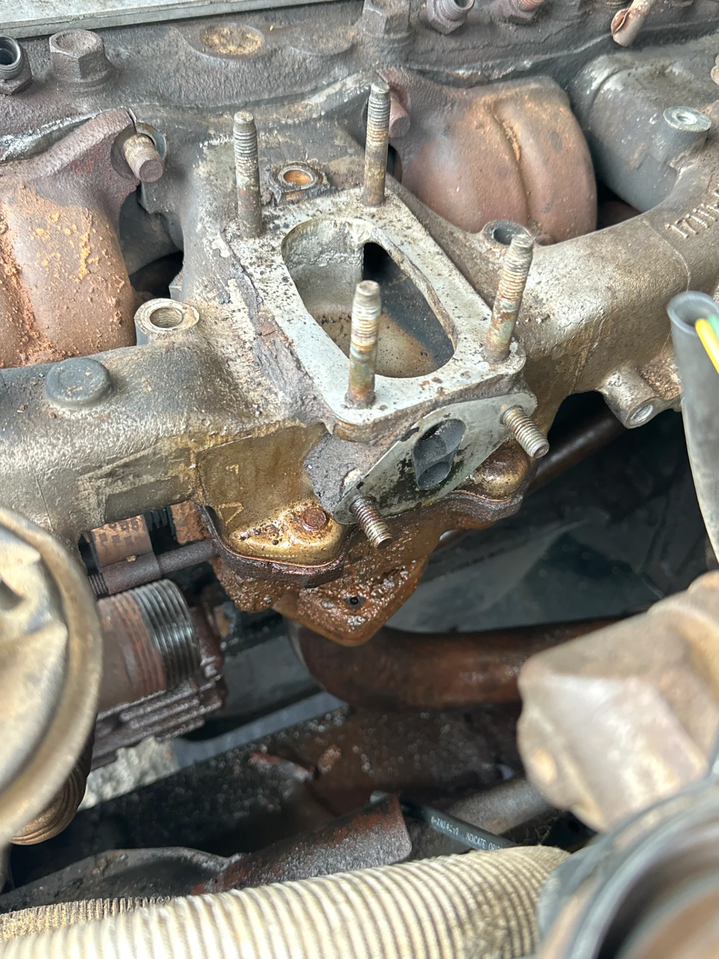

I’m continuing my work on removing the intake and I come to the bolt on the underside that’s closest to the firewall, get a socket in, and expecting a struggle: It appears to be HAND TIGHT.

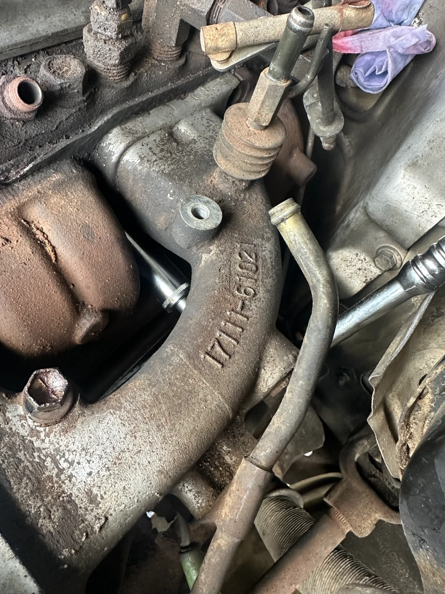

I believe at this point I’ve removed necessary bolts for the intake, but I think these are the last 2 and it should be free from the exhaust?
Zoom out some but those can stay. There's a triangular connection with three bolts that connects to the downpipe you can remove and pull the whole thing out
No, those two bolts are keeping the intake and exhaust as one assembly. Do not remove those. There are three nuts holding the downpipe onto the bottom of the exhaust side of the manifold assembly. If you haven't removed those yet, you will need to.

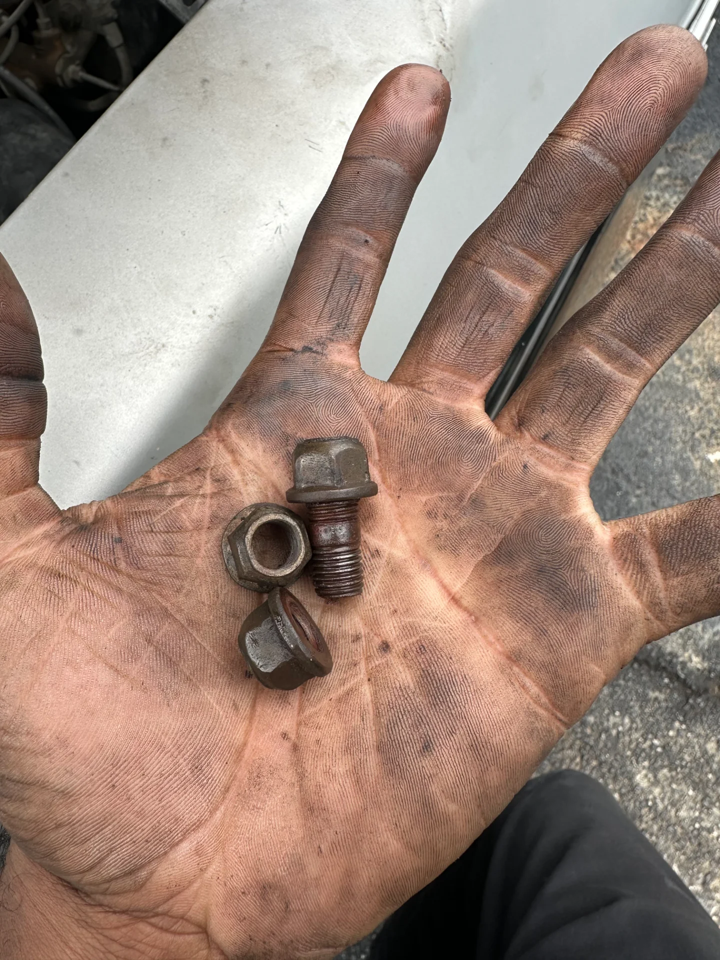

Okay!
So I’m on the right track. I got one of those bolts out; the other two…well, the nuts came off 😅
