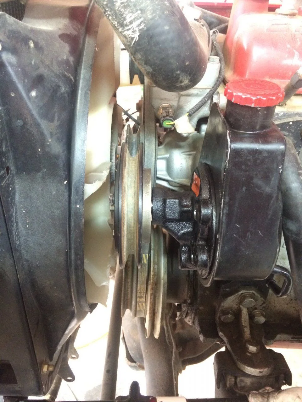

Well finally got around to fixing my steering system. Sent all my stuff to West Texas off-road. The rebuilt everything and sent ram assist parts. When they sent it back they called and said I needed to clean or get new hoses and cooler because the parts I sent had metal pieces in them. So everything will be replaced.
Started on it yesterday. Fixed my alignment issue on the pump. View attachment 1098425
Had to weld a 1/4 in piece of steel to the bracket and grinned it down at a angle so it lines up much better now.

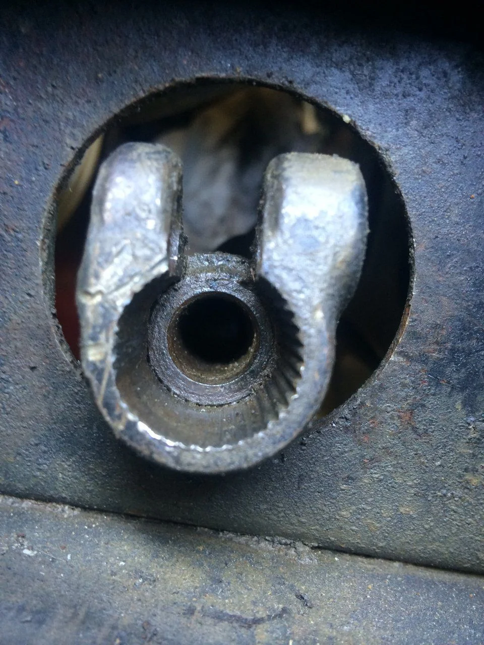

Then went to install the gear box. And I noticed this...View attachment 1098428I thought this is bad...

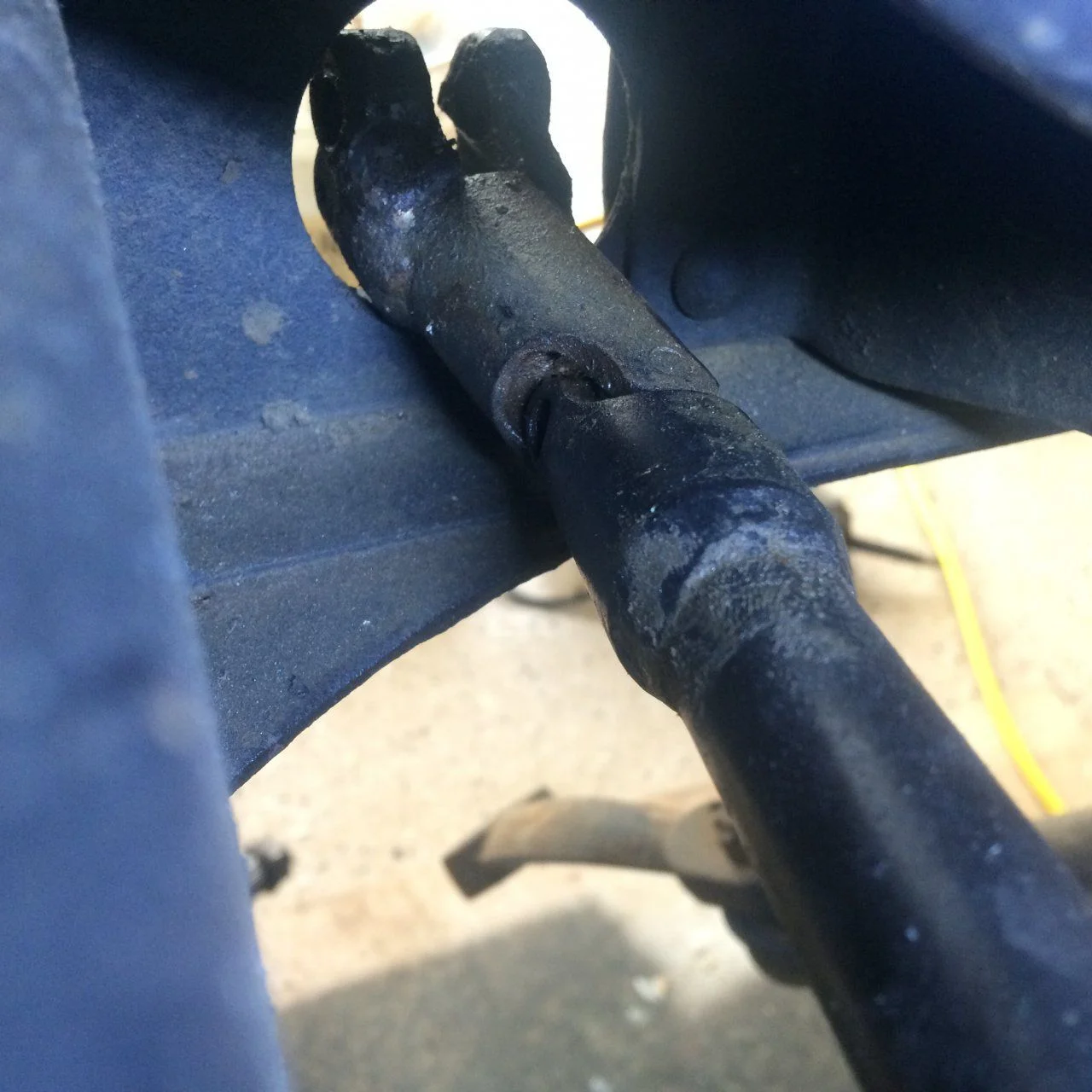

So now I will be redoing my steering shaft. Can't replace that piece because it's all welded on when PO did the conversion. View attachment 1098429
Question? Should I replace that shaft with a telescoping one? Or just leave it solid. I will be cutting it off when it comes out of the firewall and going new stuff to the gear box.

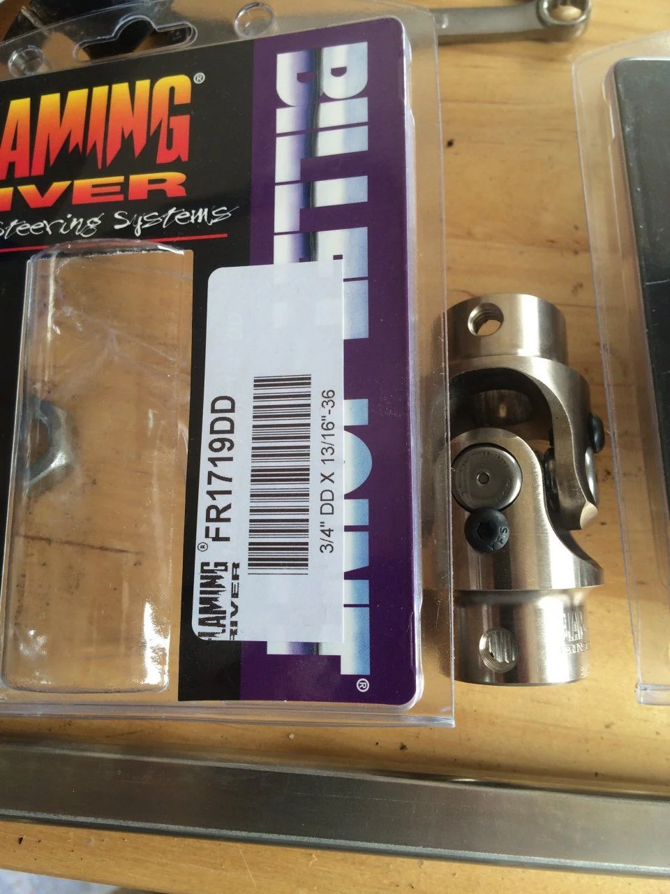

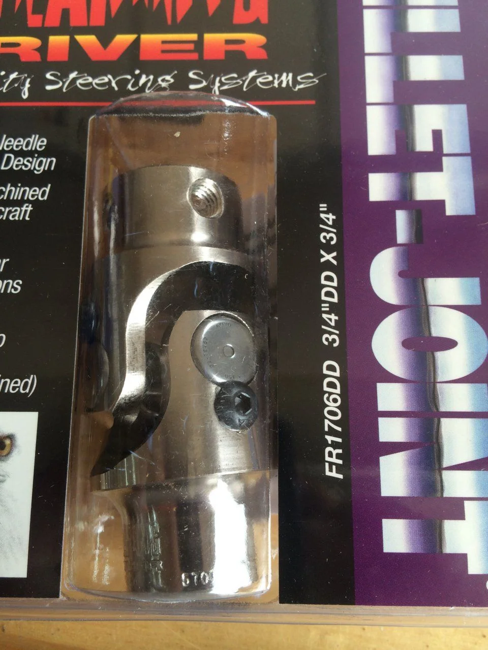

Started on steering shaft rebuild. Ordered flaming river parts:
Also ordered straight 36" DD stainless steel shaft. Good stuff!

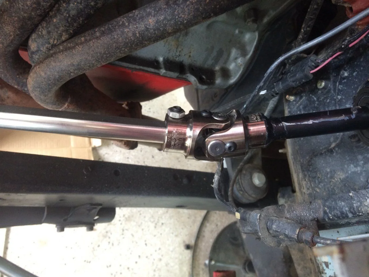

Had to remove steering assembly to get old stuff off. Luckily PO welds were not that good so a little grinding and hits from A hammer it popped off. Welded the new joint on and reinstalled. Put other joint on gearbox and had to cut about 2.5" off to make it fit.
Fits like a glove.
I have steering! It works so far!! Still waiting on a Georg pitman arm and it will be finished.

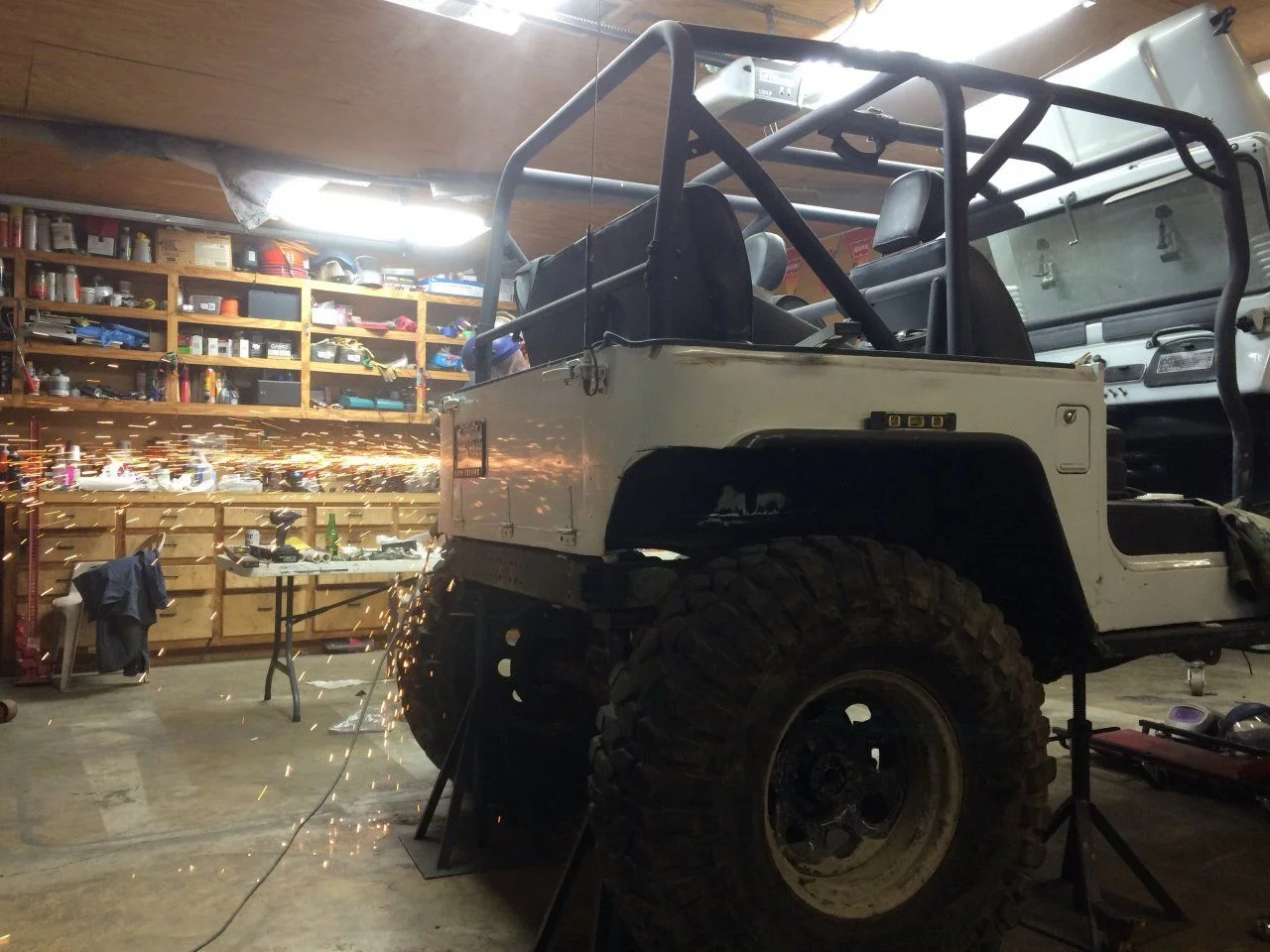

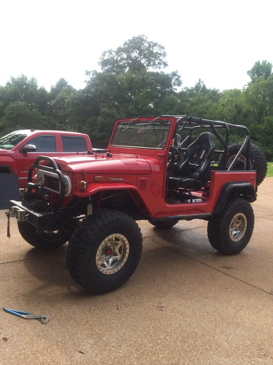

Also gave her a much needed bath. Been way to long since it's been on the road.
Not in the plans. Only other thing I might add is ARBs. I think I need to build a F-toy to keep up with that bunch. Something I can beat the piss out of.

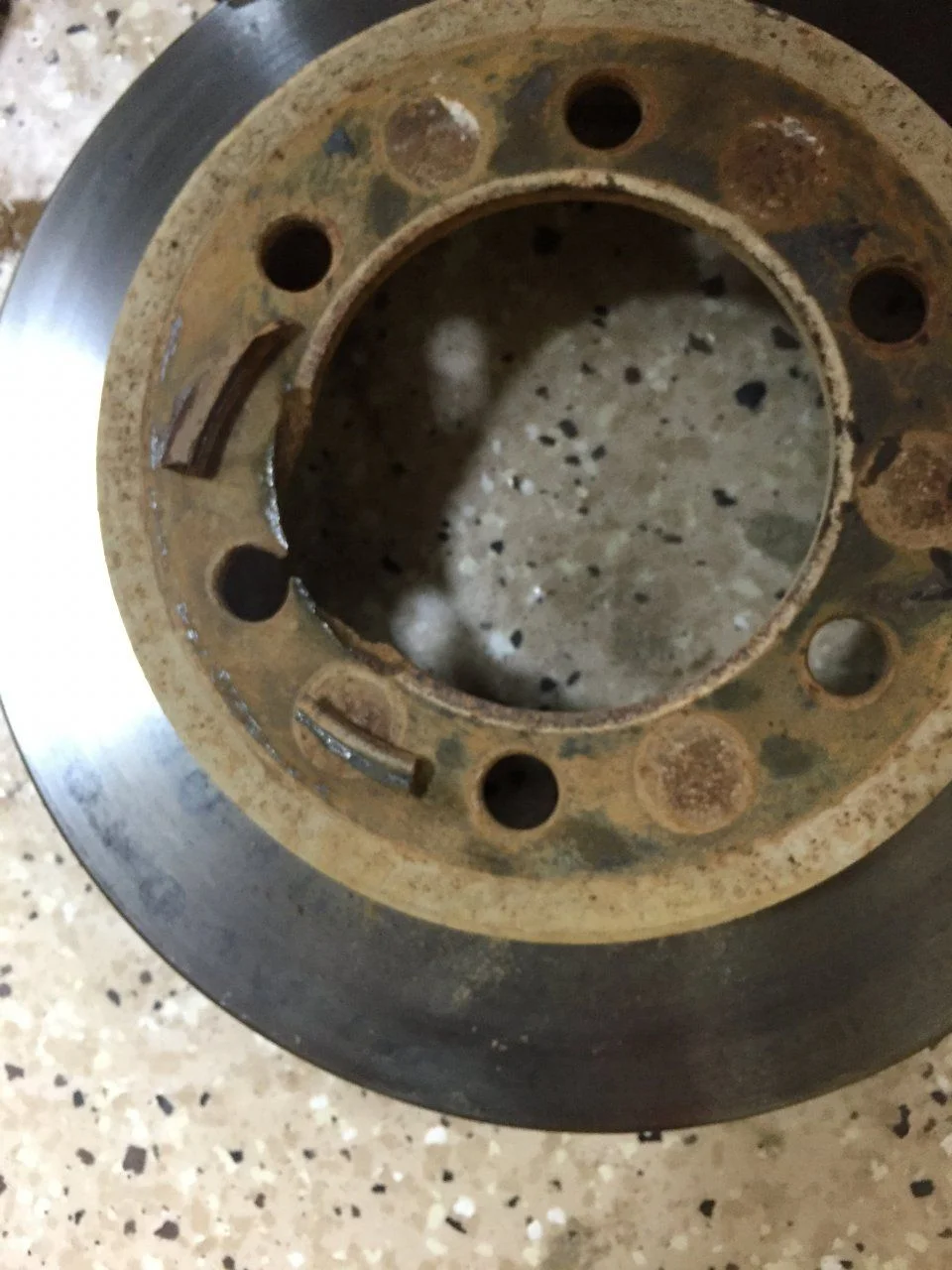

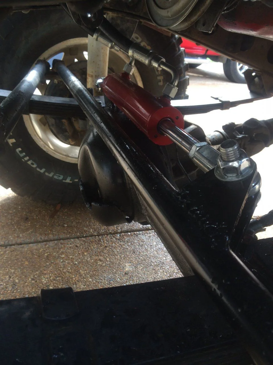

Something does not look right. A little something to remember SCC2015!!! Also found this during tear down
So the money pit is going to receive 4:88 nitro gears, ARBs. Going to get some rotors from Poser. Also up front going to upgrade to 6 shooter knuckles. I found that the track bar that the PO installed has some cracked welds so that will be reworked as well. Hopefully after this I will be done!
