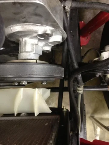

Some pics
Clarence between fan and PS pulley. Look at the ps pump, can you get one with a shorter shaft? That will make the pulley come closer to the ps housing?
Space between rad and fan. How much space is needed? I have the rad sitting forward about 3/4 of a inch due to the electric fan I had. Should I move it closer to the fan?

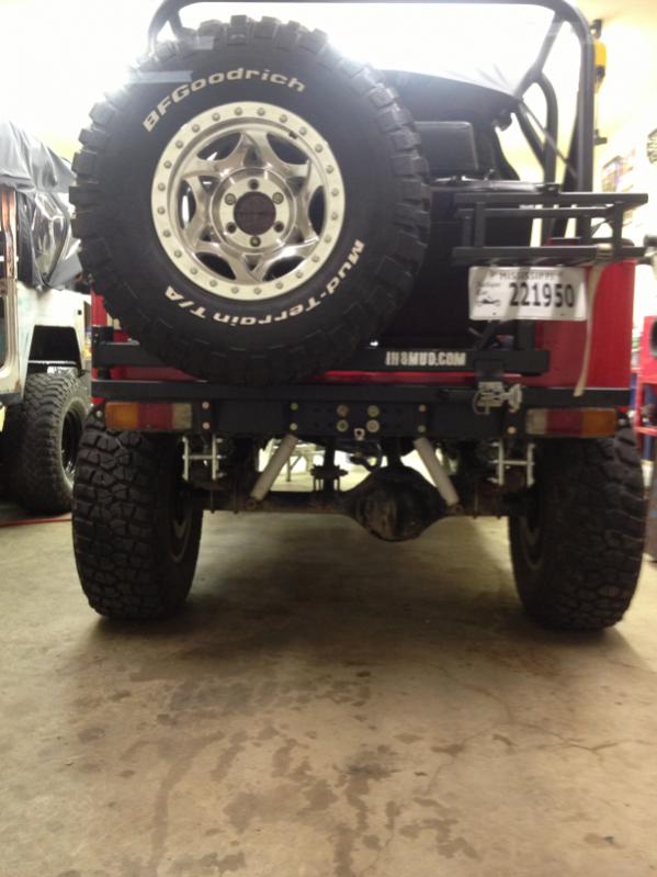

Saggy rear passenger side fixed thanks to some old springs WCT gave me. Also added some bling with raffle prize shackles from GSMTR.
