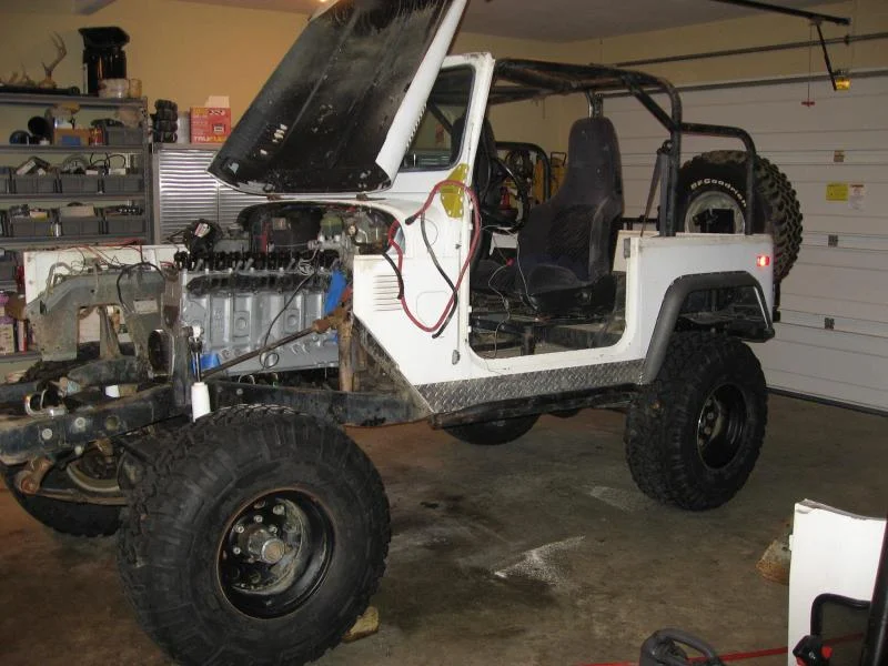

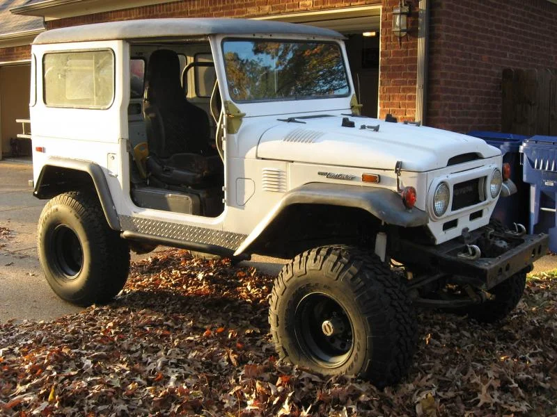

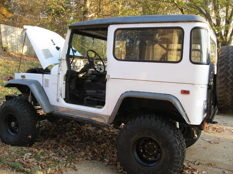

Well I guess it is about time for me to finally start a thread.
This is my 1974 FJ40:
It has a 2f from a FJ60, 4speed, SOA, It currently has 3 brand new Goodyear MTR 35x12.50x15(old style) and 1 Procomp all terrain 35x12.50x15(for sale) Custom roll bar, and gauge cluster, bucket seats, stock gears with a lunchbox locker in rear. Has VERY thick rattle can white paint job. I believe this is what has saved it from the rust fairy. Paint job is a 80 footer any closer it starts looking kind of rough. Frame and tub are rust free. This is one of the main reasons I choose this one.

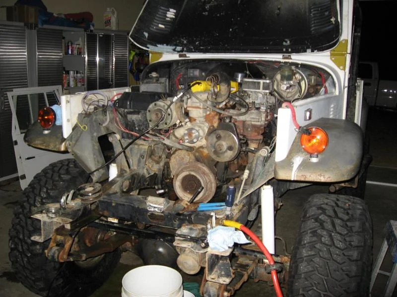

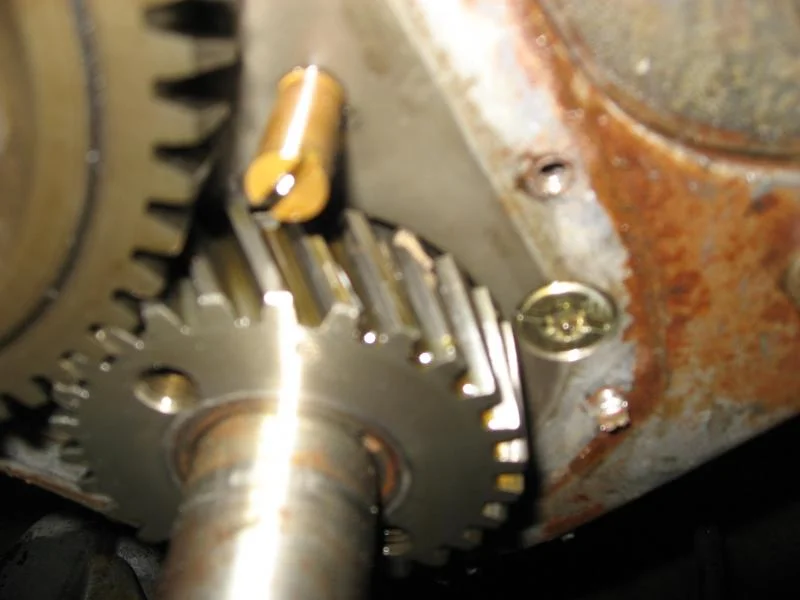

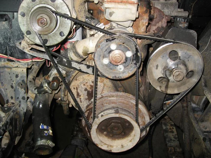

I figured I might as well do the timing cover and front crank seal. So I removed the front and the radiator(hoses were shot). I discovered that a 2f has a much larger Crank shaft nut than the 1FZ-FE, 46mm to be exact. I had to go get on at northern tool about $22.00.
Removed pully and found timing cover was missing a bolt. Took cover off and found the other half of the broke bolt. Enough was sticking out that a pair of vise grips removed the rest.

Somebody put about 1inch of gasket maker on the front arch and oil was pouring out of it. The pan came off pretty easy. I figure this is the best way to become familiar with the 40.

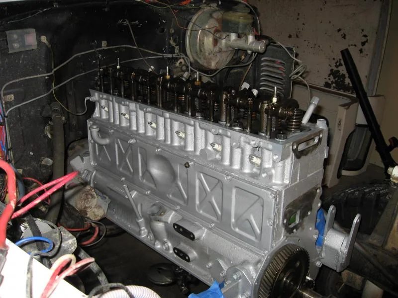

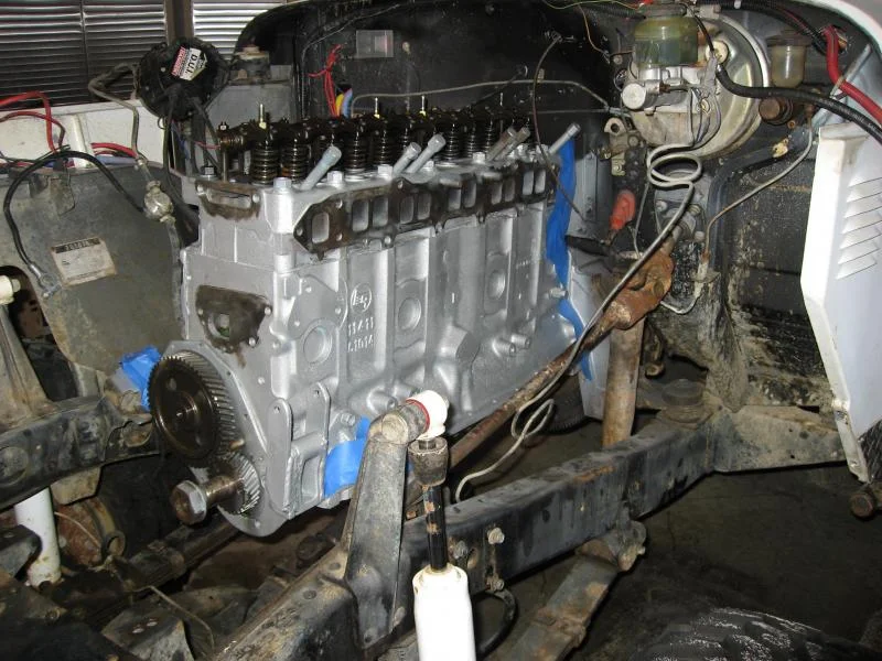

I have also removed the water pump. which is in great shape and I will reuse. I removed the Tstat housing, and glad I did because it had gasket maker blocking 90% of the port going to the head. Oil cooler removed and power steering pump removed. Went ahead and took off the exhaust manifold. Now I going to clean the motor and frame and give it a little paint job.

i'd highly recommend going with factory toyota gaskets, especially the oil pan. also, the bolts holding the timing cover on are different lengths. the FSM shows the proper lengths and locations. if you mix them up, then you can cause an oil leak by doing so. ask me how i know.....
that's a crazy alternator bracket!

Going back with the good stuff. Do you have a source on bolts? Do you know of any FSM online? I will be searching today to try and find the proper specs. Any suggestions on the alternator bracket, it seems to work. This thing has a different bolts on everything! My goal is to try and get everything the proper size.
