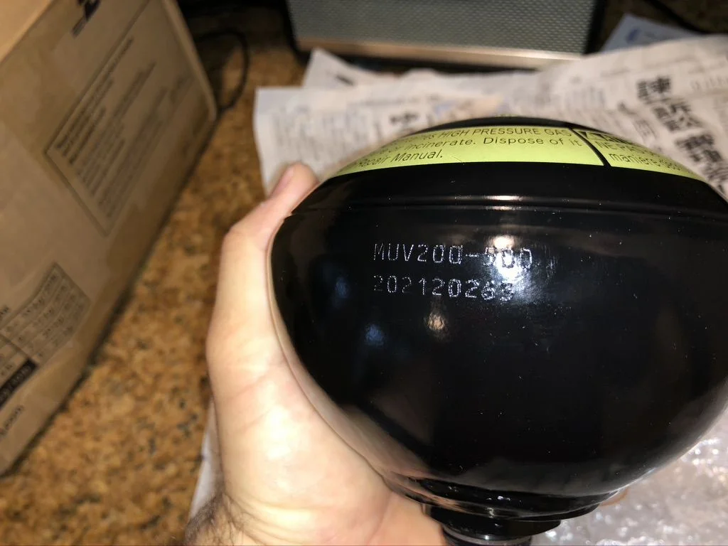

JDMParts on eBay took 1 week to arrive via DHL from Japan. I paid $470 for the rear pair.

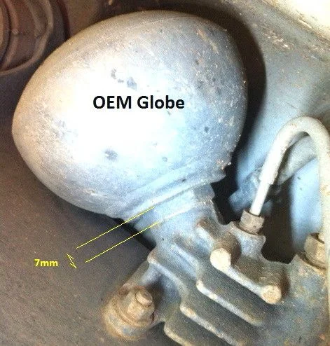

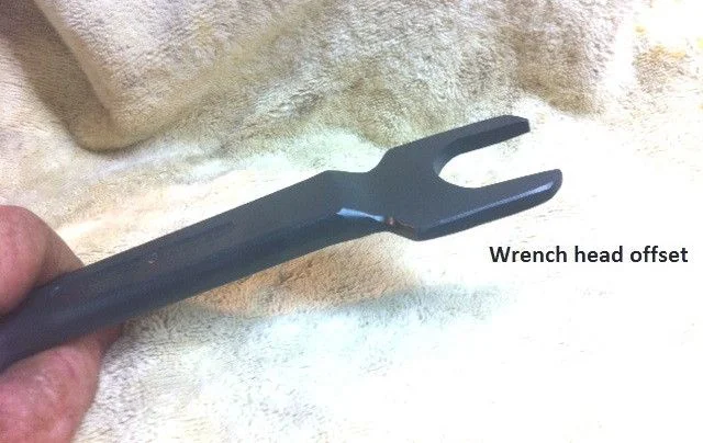

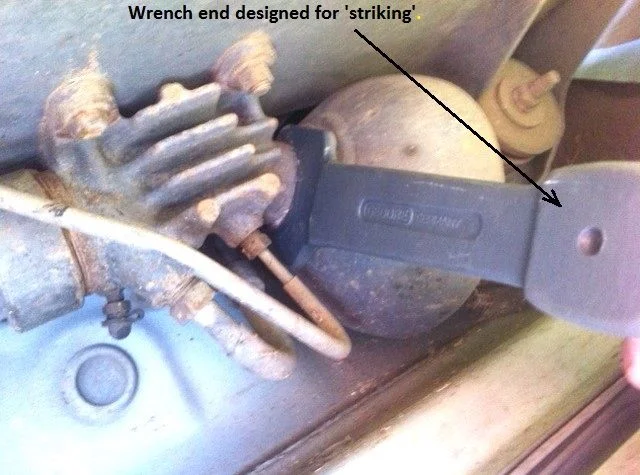

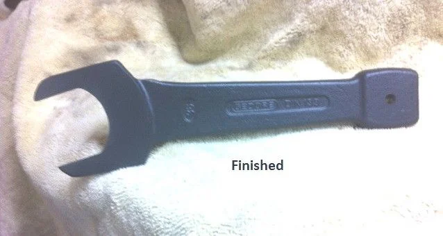

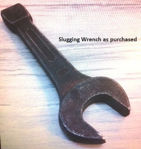

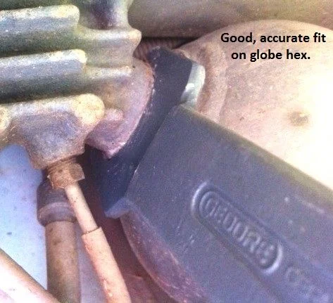

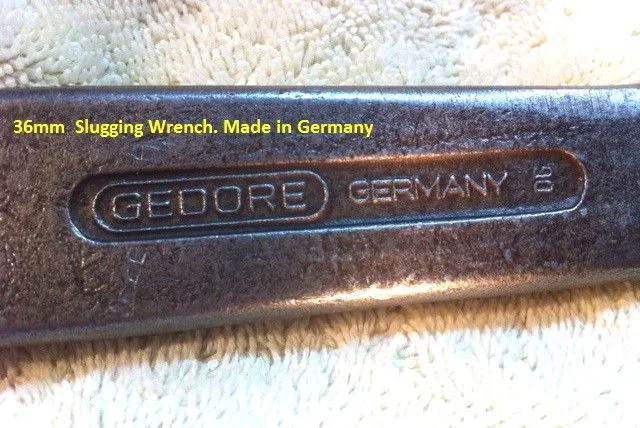

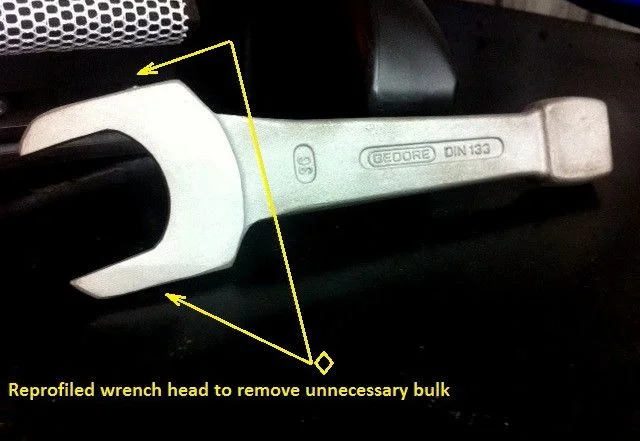

@djkcpa - I modified a 36mm wrench to suit this job. PM me if you want to borrow it.
(Edit): Modified = reduced open ends to just under 8mm thick, and narrowed the jaws to clear hydraulic lines.
A fan clutch wrench would have cleared 'as is' but I was worried it would not deliver the torque needed.
I did something similar...only started with a 'Slugging Wrench'.

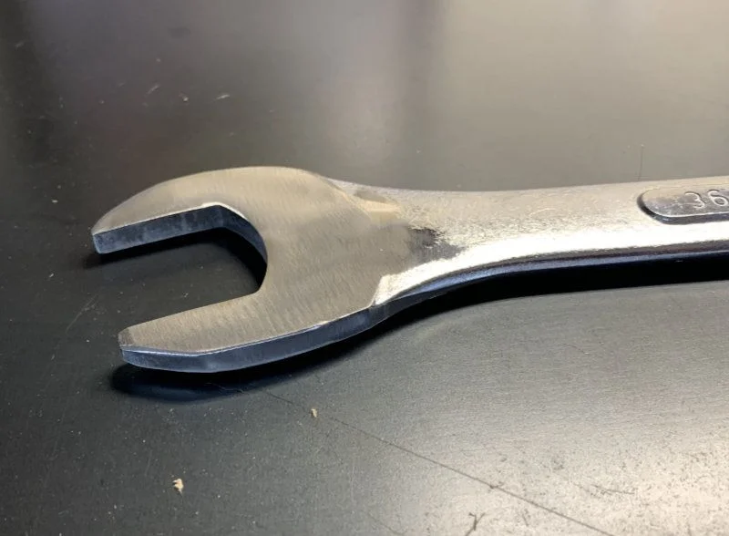

This looks awesome except that a quick Amazon search shows the only 36mm open ended slugging wrench to be $68. Any suggestions for a better source? I like this idea better than just a big box wrench for my rusty spheres. I don’t currently have anything this big other than adjustables.
Bought mine off Ebay $22.00 shipped
I started with a $21 Sunex wrench off Amazon and just ground it down with a flap wheel. It took a while, but turned out fine. An eBay special would work equally well I am sure.

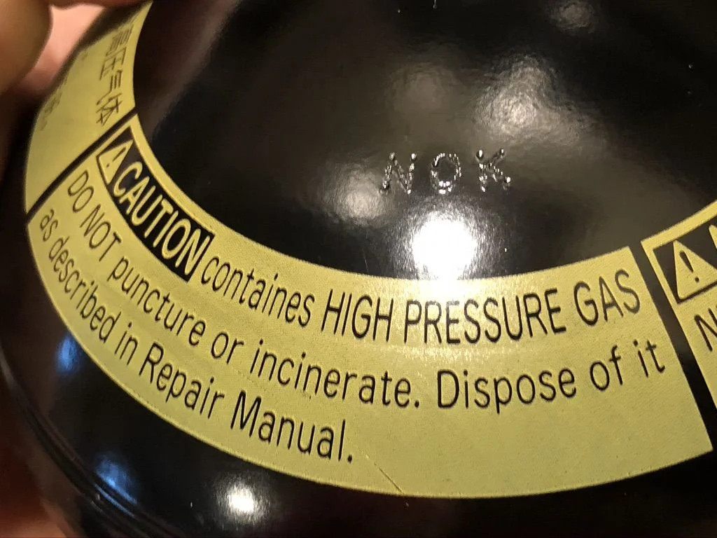

You got yours from Japan? Most of the OEM ones I see on ebay are from Japan, but the price seems pretty good ($900-$1200) range, however all the ads mention extra shipping or customs costs or whatever. Did you have to pay extra on top of the cost of the globes/shipping?
Check out JDM Planet.... shipping was
¥17,300.00 via Airmail
