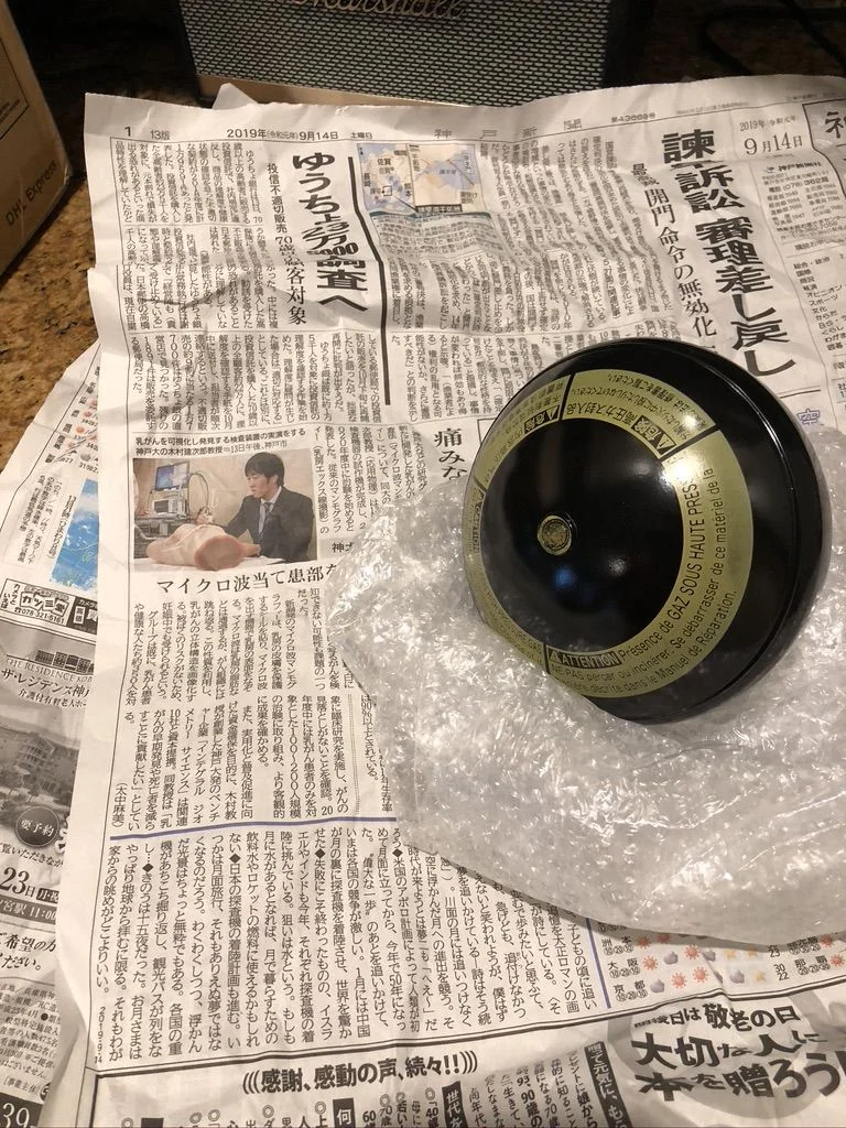

JDMParts on eBay took 1 week to arrive via DHL from Japan. I paid $470 for the rear pair.

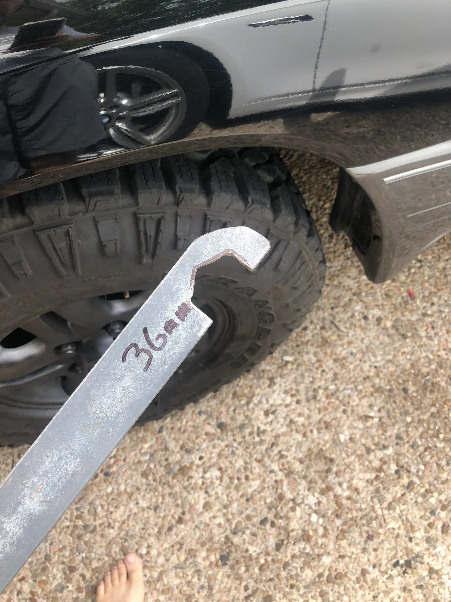

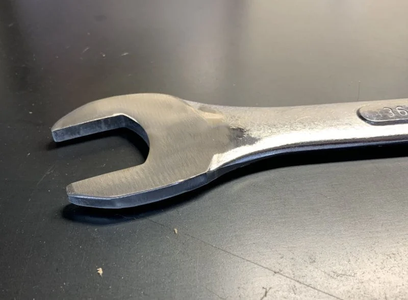

@djkcpa - I modified a 36mm wrench to suit this job. PM me if you want to borrow it.
(Edit): Modified = reduced open ends to just under 8mm thick, and narrowed the jaws to clear hydraulic lines.
A fan clutch wrench would have cleared 'as is' but I was worried it would not deliver the torque needed.

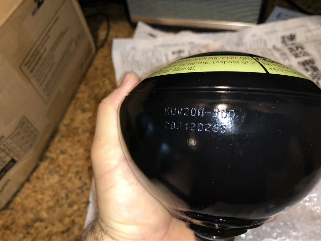

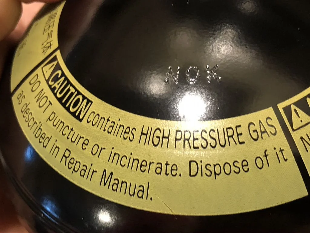

Benefits of getting globes from Japan, you get to catch up on the current events.
Are these Date Codes???? Pehaps.
Thanks for the offer.
