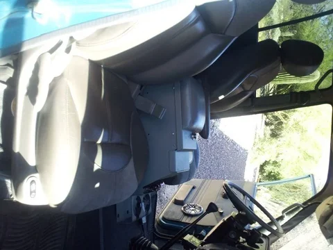

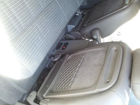

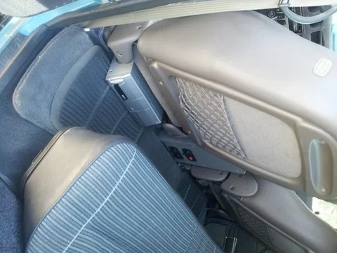

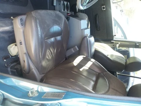

Here are my seats from a 2001 PT Cruiser, leather, both seats heated, drivers side has arm rest, passenger side fold flat forward to provide a level surface. Both recline way back. Have not wired in heaters nor the height motor (drivers side only) as I want to do some other wiring at the same time and need to plan it out. But they worked when I jumpered them right to battery for a test. Sorry, not sure why they all got flipped on their side for this post. These are in an 84 model. slots must be cut in plastic trim to allow seat belts to move freely when moving seat front to rear.
