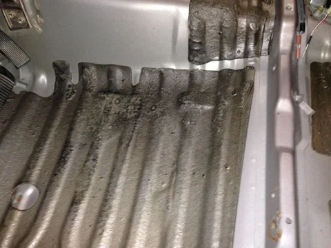

I'm already have the CCF and MLV and plan on adding that in as well. Also, when you have the door panels off I'd highly recommend cleaning out the bottom of the inner doors...if you have half as much crud built up as i did you'll be cleaning it out for quite a while to make sure there's good drainage in there...and that your weep holes are clear. Another must for sound deadening are your quarter panels and the rear tailgate area. Here's a shot of my driver's side floor and one of the inner door panels after cleaning with the simple green.

Well I decided to go the dry ice route, I started off with simple green and the green Brillo pad, which worked but the dirt is what did me in. It was caking so much I just decided to run over to the grocery store and pick up some dry ice. Got 2 bags about 8 lbs and went to work, got all but the passenger floor board and I was gonna leave it but I just can't. Gonna have to get some more on Thursday and finish it up. I also cleaned up the PT cruiser seats with some Turtle brand apolstry cleaner and I am impressed, they were dirty and smelled and I bought it on a whim hoping it worked and it didn't let me down. They even smell nice and fresh, I'm gonna do the rear seat too. Pics aren't the best, I'll take some later in the daylight.
