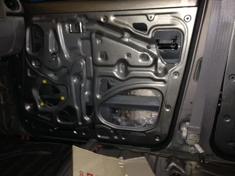

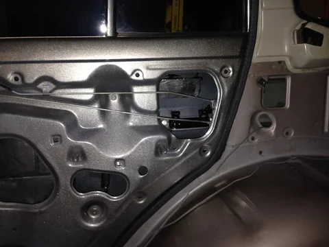

ok, here are some of the shots...tough to see being the inner door. You don't have to do 100% coverage, just overkill for sound (guess it would make sense if you're trying to reduce heat/cold). My door and tailgate sound so solid now...this is more than enough coverage for me. I'm also going to try to add CCF and MLV to the floor and the door panels, q-panels and tailgate. for the biggest effect you have to do the doors and tailgate as there is a ton of resonance with them as is. Hit your floor without the sound deadening, then the door...it isn't even close to which one is louder.
inner door #3.webp inner door #4.webp inner door #5.webp inner tailgate.webp inner tailgate#2.webp
for the doors I think you can see through to the large pieces I put in...also at the top of each door (above the handles) there are long strips that go all the way across. I've easily covered over 50% of the sheet metal (probably closer to 75% coverage)...just tried to space it evenly I'll also end up adding some small pieces to the inner door skin as well.
For the tail gate I used 3 pieces on the main section then some on the upper portion of the tail gate. Again I didn't bother going for 100% coverage...staying mainly to the flat portions of the sheet metal. I'll also end up adding something to the back of my license plate to keep that from making noise.
Biggest thing to remember is that this material helps with the rattles and resonance (think hitting a cymbal)....to really quite the interior down you need to do CCF and MLV - again the doors, q-panels and tailgate will have a greater reduction in db vs the floor.
