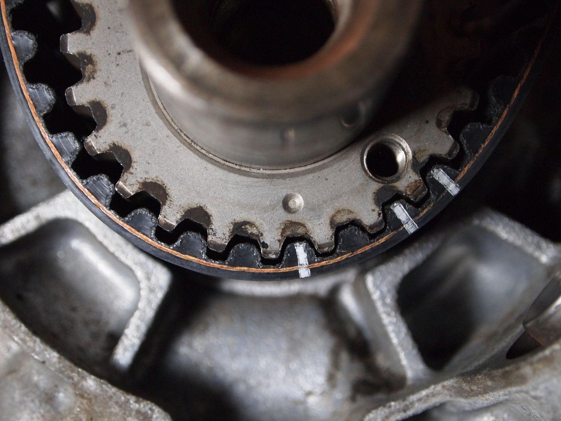

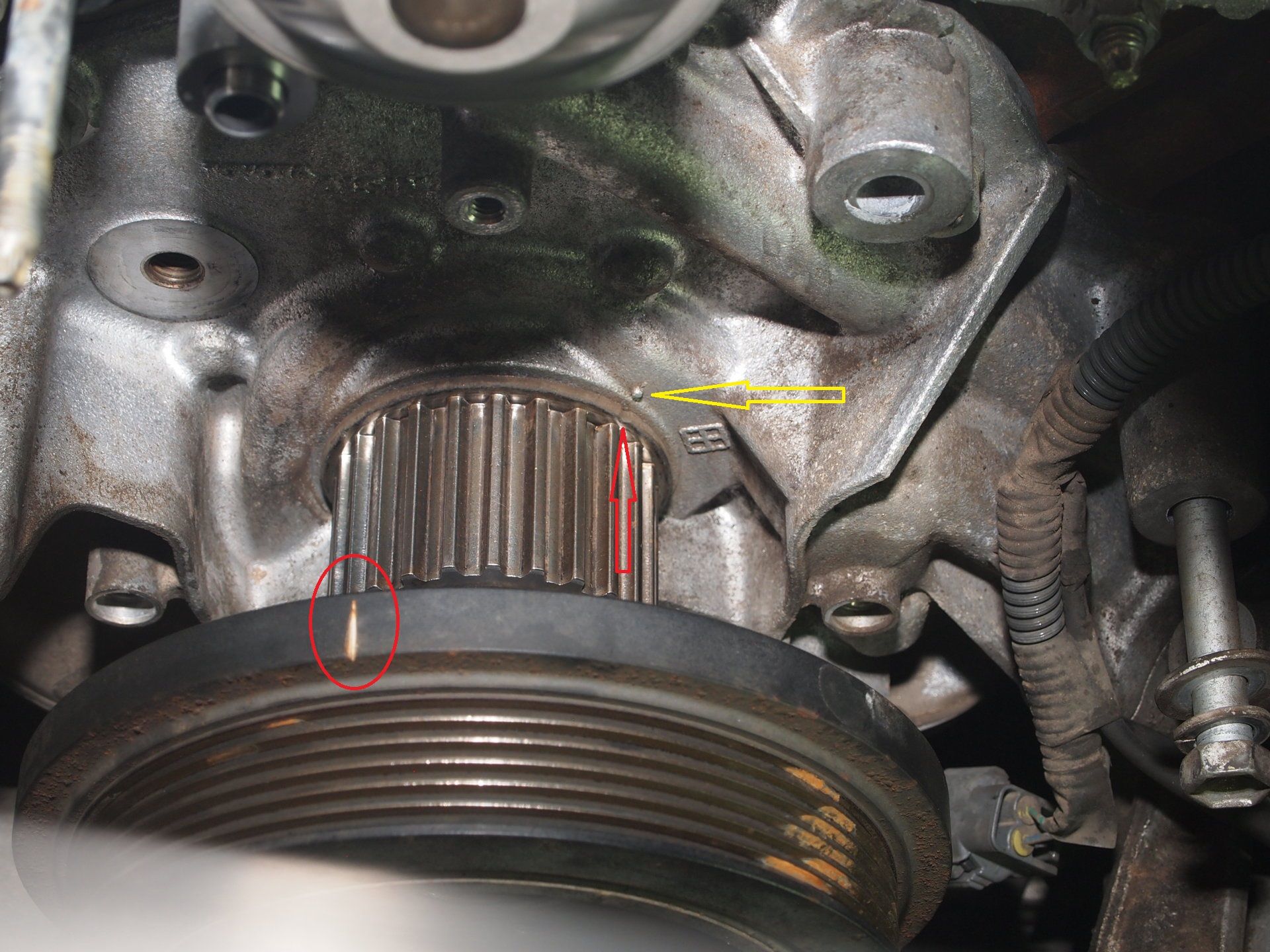

With crankshaft set to TDC, the #1 piston is at top of cylinder. Which happens when mark on harmonic damper (circled in red ) aligned to zero on dial (not pictured) that is fixed to lower timing belt cover. TDC of #1 cyl can also be set with timing mark (notch, red arrow points to) on crank sprocket and mark (bump, yellow arrow points to) on oil pump housing.
View attachment 1861957Crank Marks for belt are seen here:
With LH cam timing marks aligned, the #1 intake & exhaust valves are closed for compression stroke. We must also aligned RH cam marks. Then belt ties it altogether.

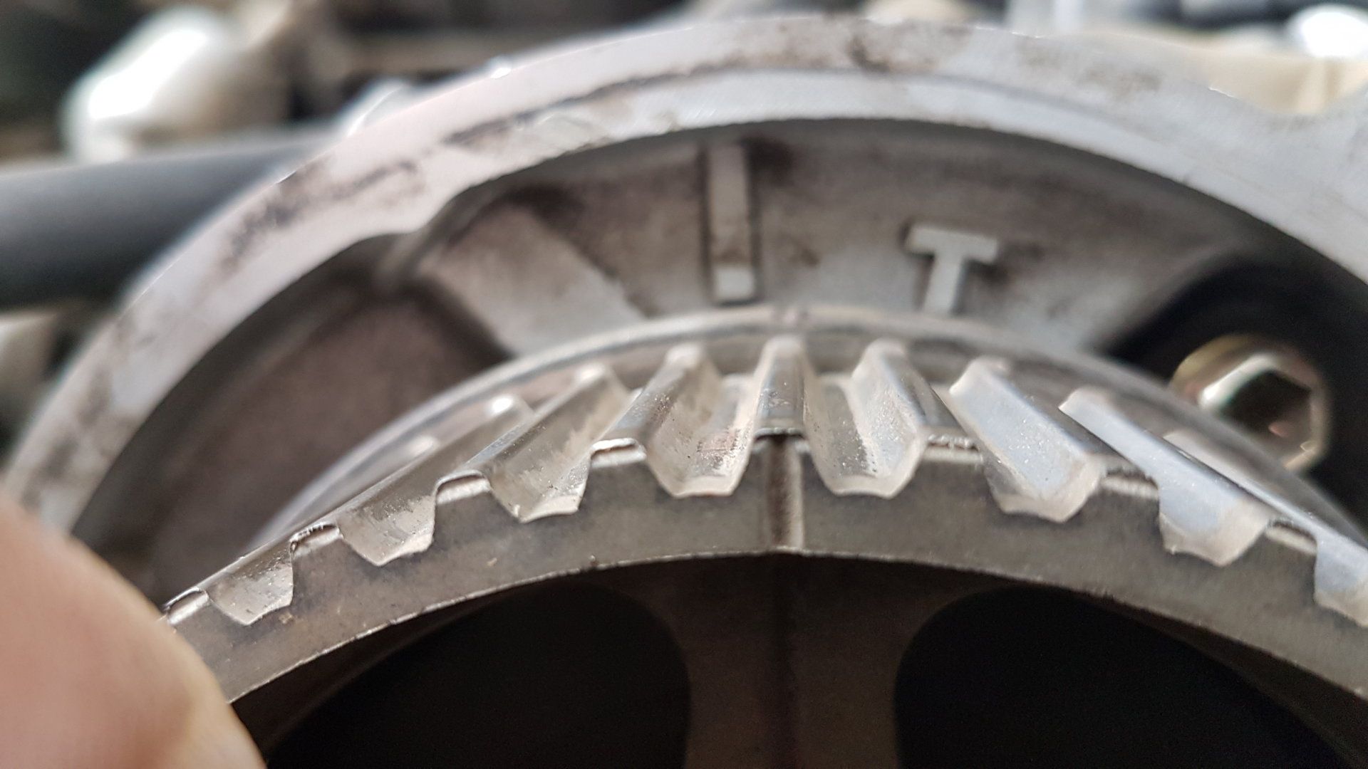

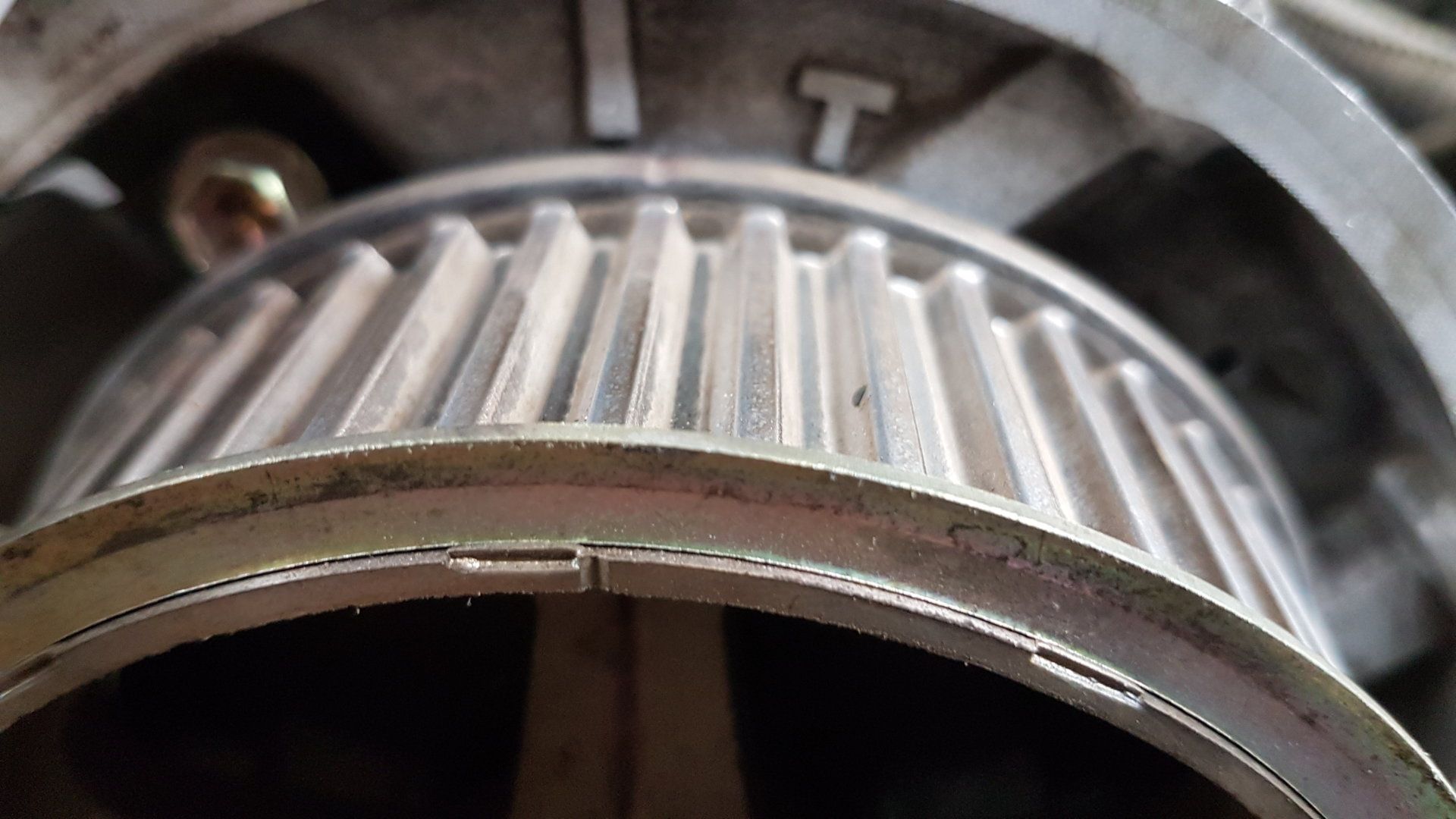

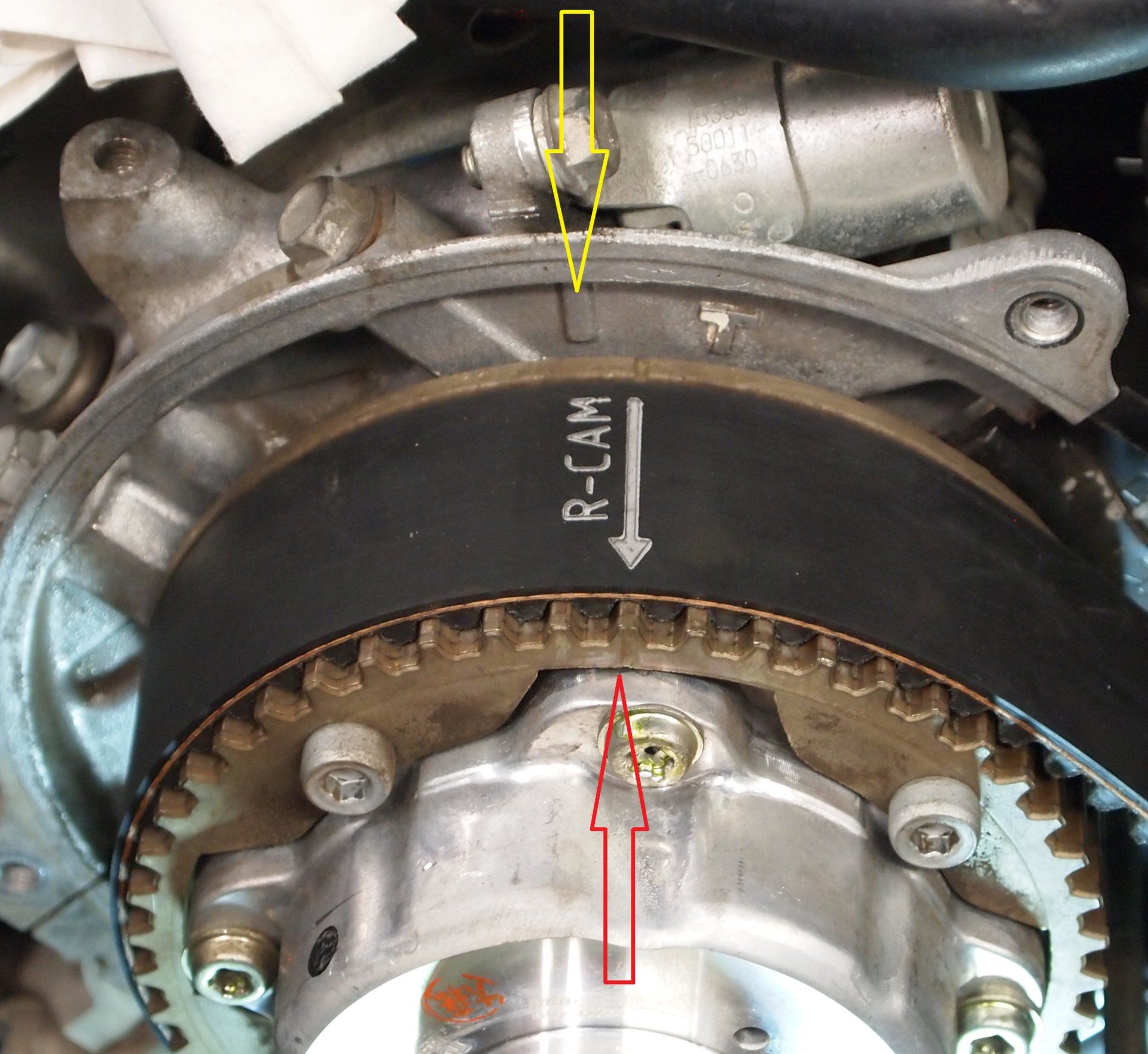

This is a VVT engine so cam sprockets looks a little different than non. This sprocket is about 1/2 tooth past (CW) the mark on engine. View attachment 1861990
Yellow arrow points to timing mark on engine. Red arrow points to mark on this cam sprocket which is about 1/2 tooth past (CW) the mark on engine.
Mark sure to NOT use the "T" for cam marks timing mark.
In these pictures sprocket happens to be about 1/2 tooth pass (CW) of the timing mark on engine.

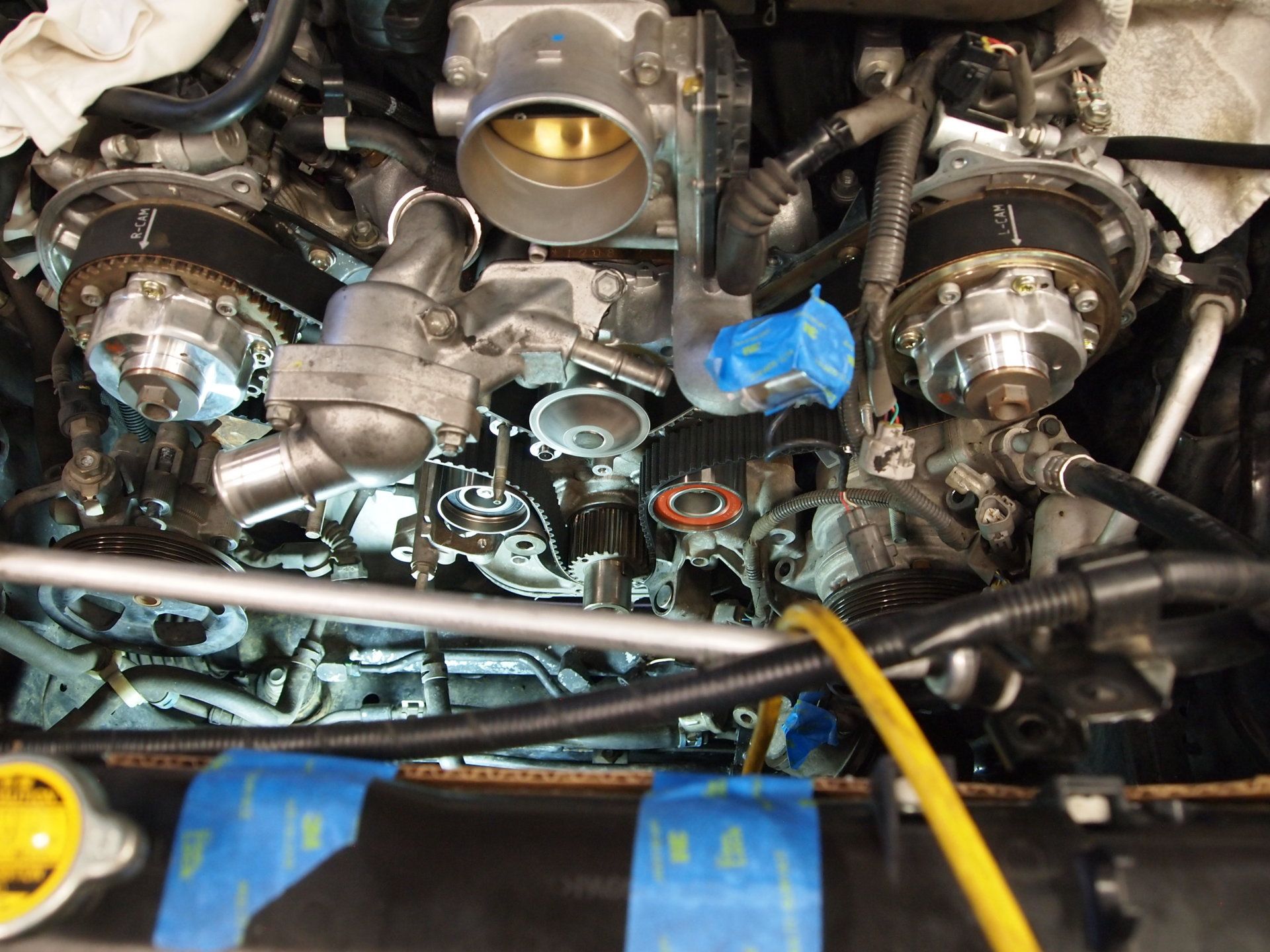

Tips:
Cover radiator with cardboard.
With all spark plus out, it makes turning crank easy.
Cleaning harmonic balancer and crankshaft then adding a little grease where they mate, makes slipping on and off easy.
Forgive me, but this is totally new. I think that I have the timing belt gear on correctly. The notch in the gear is ligned up with the bump on the engine.
It is difficult to get the cam gears to stop perfectly when trying to lign up the line on the gear with the line next to the T on the housing.
The cam gears wants to continue to rotate to the next resting position.
Am I just sort of balancing it in that position untill I get the belt on?
You're fine. In-fact Toyota changed the procedure and rightly so. They once had put on the lower cover and harmonic balance, which blocked our view of belt marks at crank.

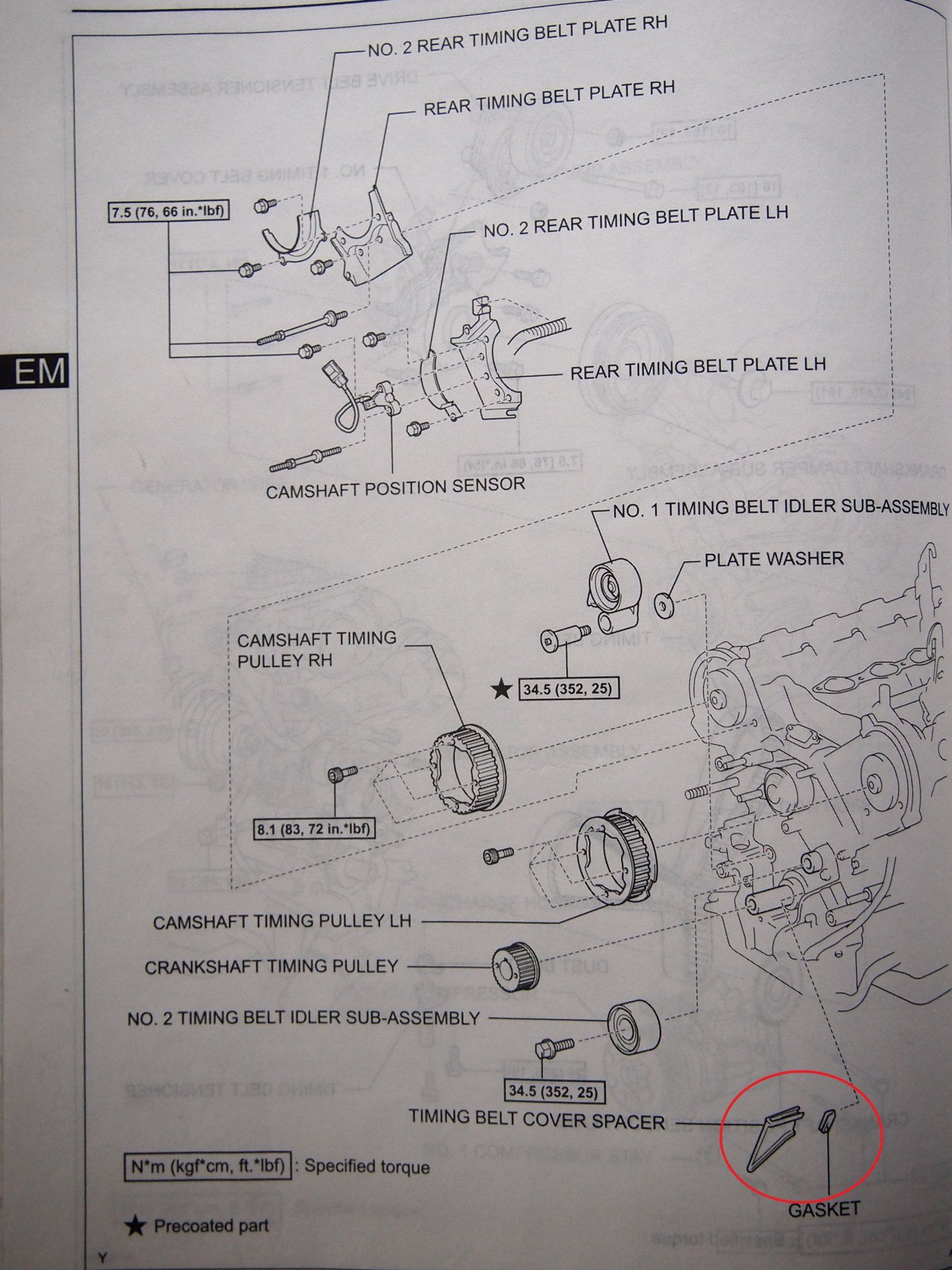

Here is picture from 2007 FSM. You can see that they now actually tell us to set LH (diver side) cam 1/2 tooth forward of mark and RH cam 1 tooth forward. Also see picture in post #125, notice cams forward of mark.
They also now have us put belt on before tension. This works much better, as we don't fight the belt so much. I actual put belt on then install idler, followed be tensioner. This way I don't fight tension in belt. But I do have belt move around on me. One solution, if you don't have 4 hands, is clip/clamp belt (lightly) in position on sprockets as yo install LH idler and tensioner.

Don't forget the two little pieces of plastic (Timing belt cover spacer & Gasket). Mice get in here when missing. Mice will take out a belt. I put a dab of FIPG on bottom of cover to hole gasket in place. Make assembly easier.

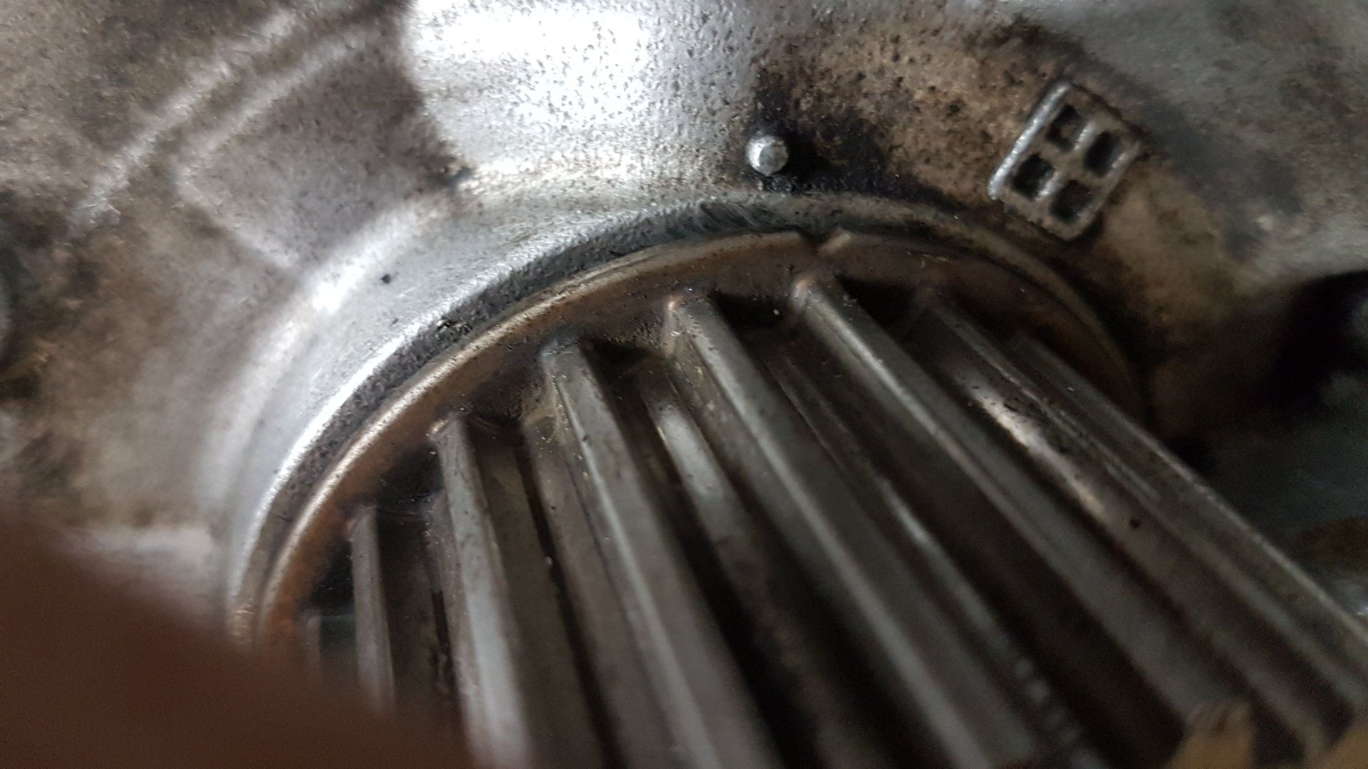

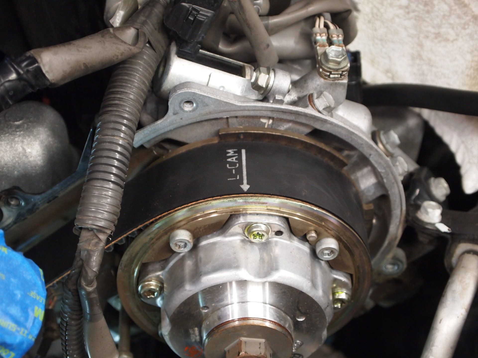

It is the VVT procedure. But it doesn't really matter, here's why IMHO:
First if anything we need to take more care with the VVT, out of inference concerns. VVT actuator are in neutral position (no oil pressure). So cam in much the same position as a non VVT. Or in other-words, valve in same position/protrusion. With the non VVT, no one has found interference on the bench. By that I mean, guys have turned the crank 360 degrees with belt off without interference. I have also done this a on a VVT engine, but left cams near the "marks". So I'm not concerned with interference on the non VVT engine with cam resting near the marks. So we've that concern out of the way IMHO.
So what we're untimely concerned with is the timing marks being dead on, once belt has full tension on it.
Keys are: Belt marks must dead be on the crank and cam marks. The way I start with one idler off and tensioner out, belt has a lot of slack. #1 cylinder at TDC (Top dead center) with crank timing marks aligned. With cam on the mark or only off timing mark by 1/2 or 1 tooth is not issue at this time with belt slack. But belt marks must be dead on all sprocket marks. Then once idler installed belt slack is taken up. Then tensioner installed and retainer pin removed, putting full tensions on belt. Belt will pull/turn back cams (may need to back-off CCW the crank a few teeth, then turn CW a few teeth to get tension in direction of travel) to see alignment marks dead on. At this point, all marks including belt marks will be dead on, which is the goal.
We then test to make sure we have it all set dead on. We do this be turning crank (spark plugs out makes this so much easier) 720 degrees (two full revolution) until crank on the mark (sprocket mark is aligned with timing mark on oil pump). At which point both cams should be dead on the marks. The belt mark will not line up any more, but that is fine they've done their job.
Of course you can use the method in 98-05 FSM which has lower timing cover on and you turn back the cam a bit.
But I've never like that I can no longer see the belt marks on crank sprocket/mark on oil pump this old way. If I jump a tooth on crank during assemble, I don't no until the 720 degree test spin. Nor do I like that I must fight the belt with this method. Also the timing cover being plastic and old may have zero off a MM or two, which makes seem belt stretched (marks not dead on).
I can't say for sure but it seems Toyota as they wrote the FSM for the VVT. They made the processes a little easier and less likely to error. They sure made the picture of timing mark vs that "T" clear.
