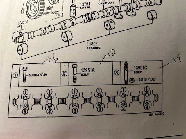

While reading my book last night I see I'm missing some hardware. It may be in a box still. The 3 different flavors of bolts that keep the rocker assembly in place/mount the valve cover to. Of course they are obsolete

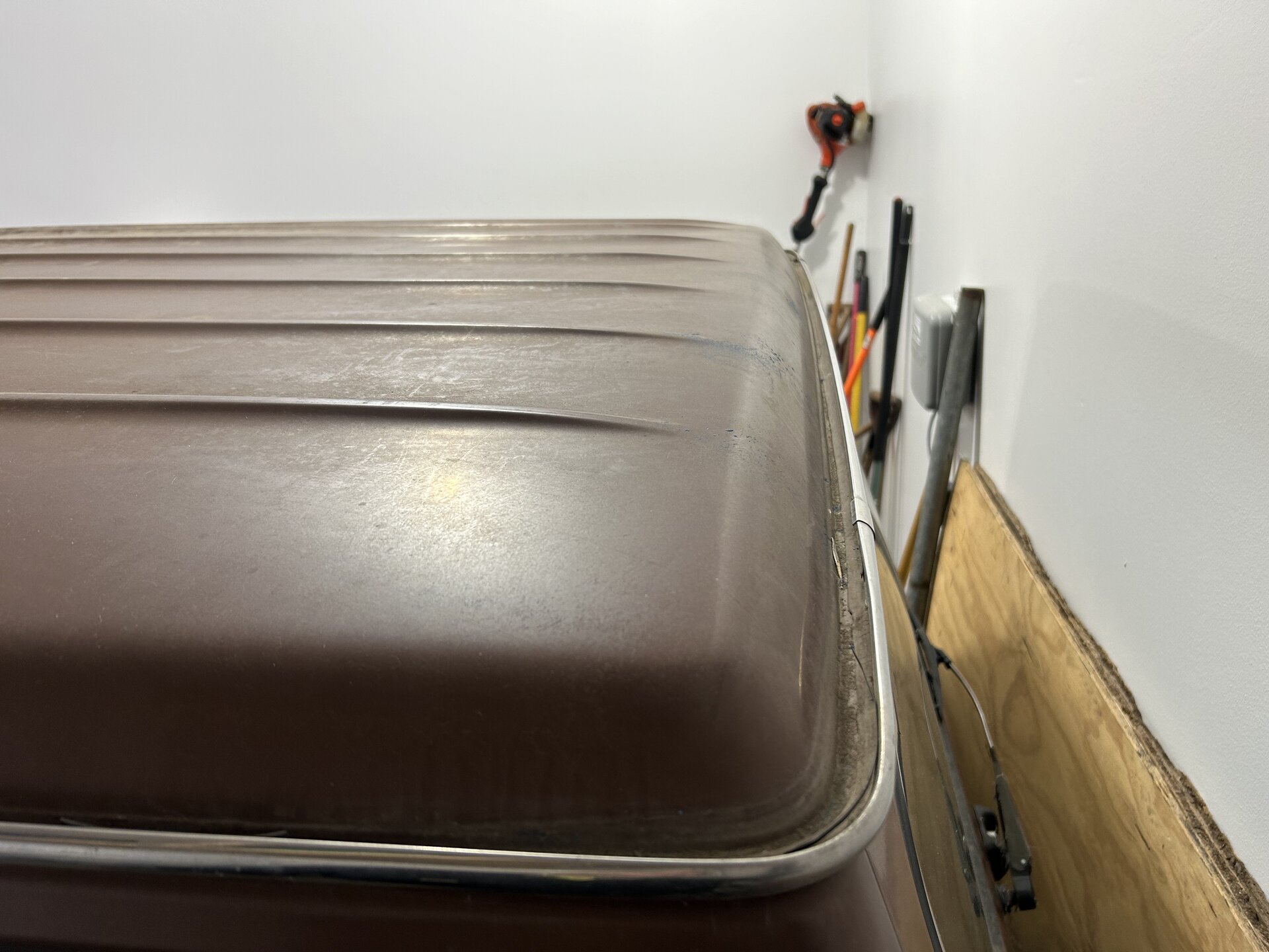

Not engine-related, but definitely add resealing your drip rail to the list. Looks like the factory sealant is cracked, which will allow moisture to seep in under the roof skin. The roof and other areas will start to rust from the inside out.
