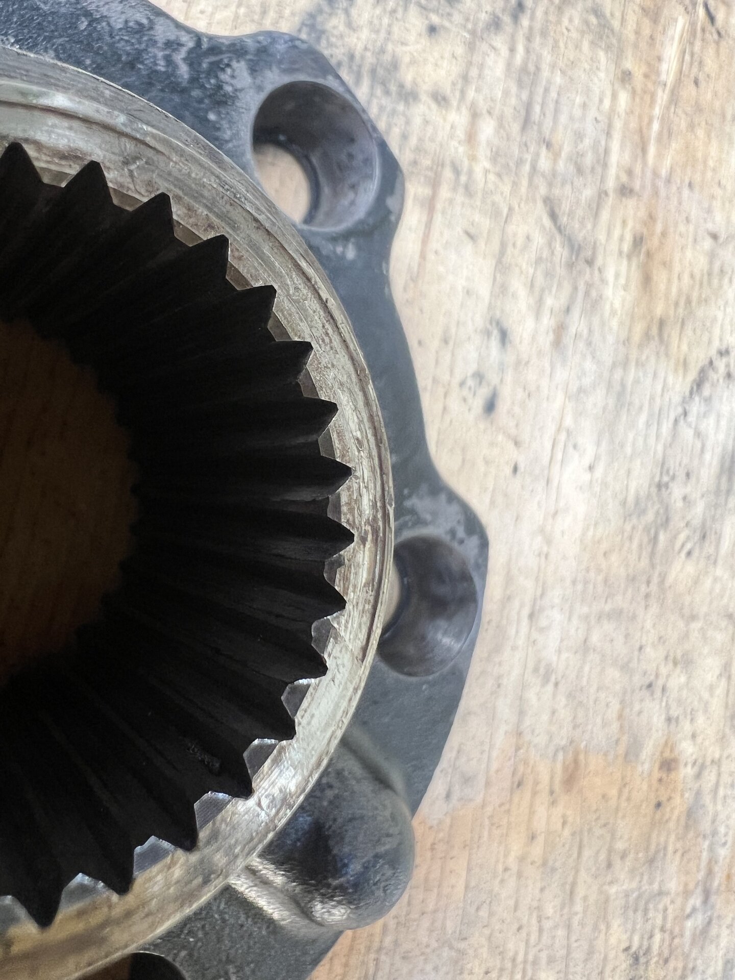

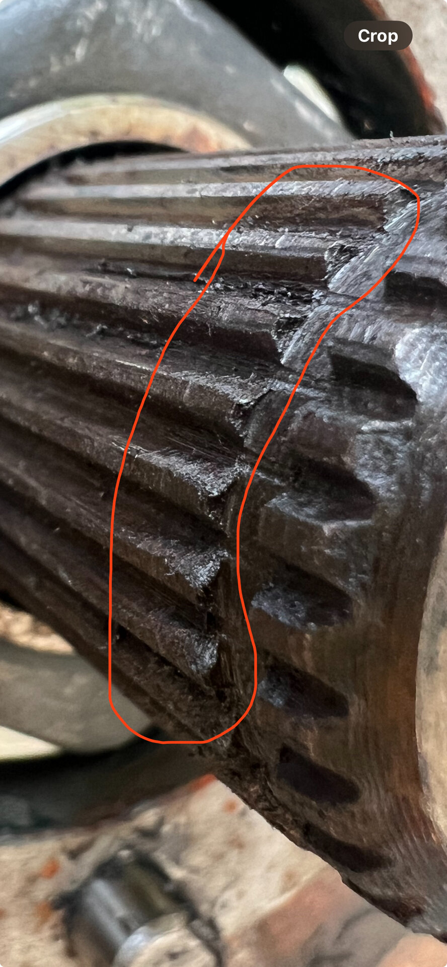

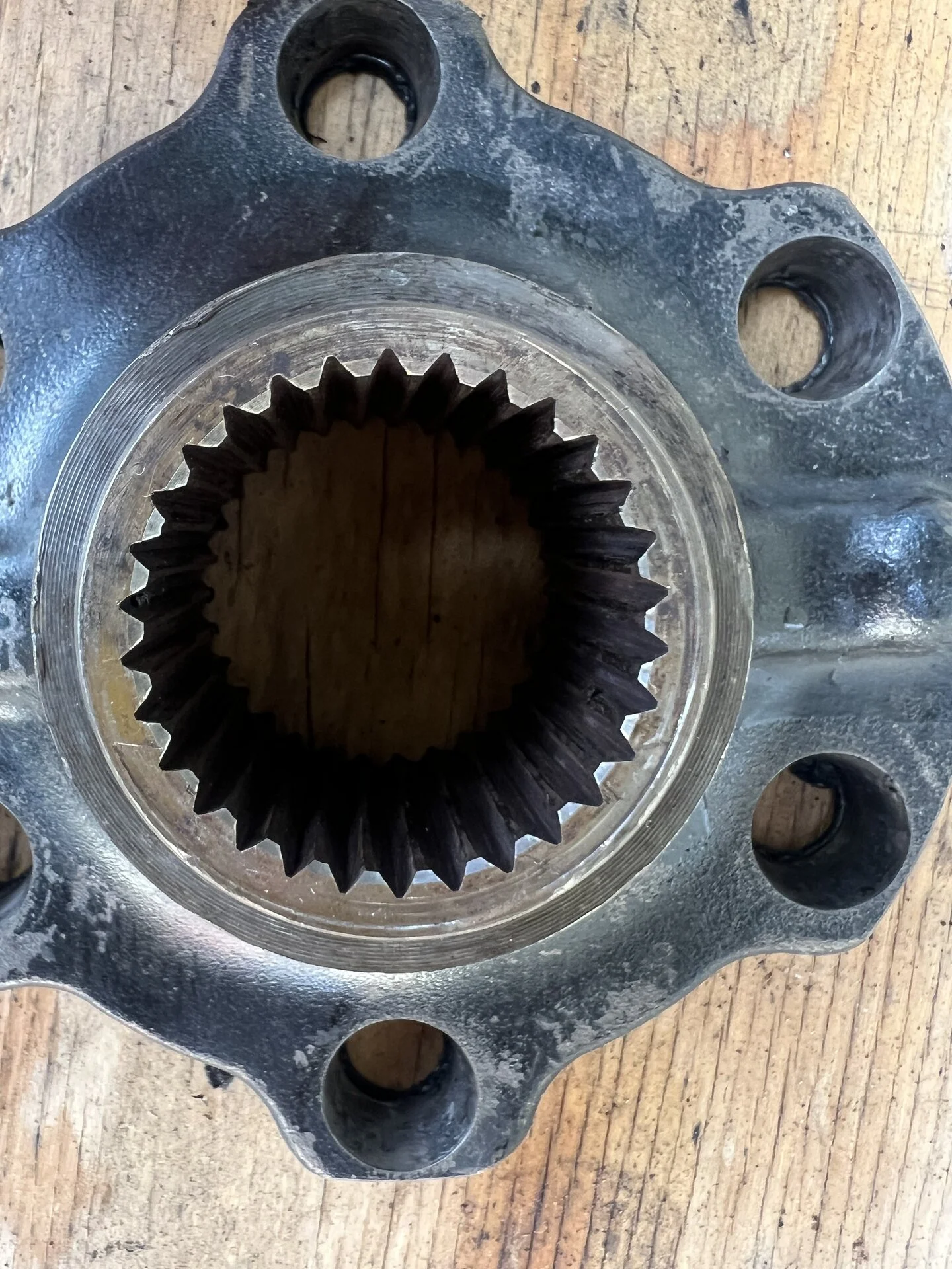

Took the wheel off and also the flange. There is something, whereas the main point is: is it cause or result?
The CV outer teeth are slightly damaged whereas the rest looks pretty well for 270k miles.
The teeth of the flange also look good to me, with some wear. Either way: new ones arrive tomorrow.

I guess my mistake was to reuse the snap ring… it was sitting fairly loose, lost tension and wasn’t flat anymore!
And seeing that it already worked it’s way into the flange surely shows some “in and out” movement… you can clearly see the print of the snap ring.
The CV axle itself has a very slight play up and down on the inner side. Slight play of the middle part in and out, but I think it’s normal.
Also found the inner side boot to loose oil.

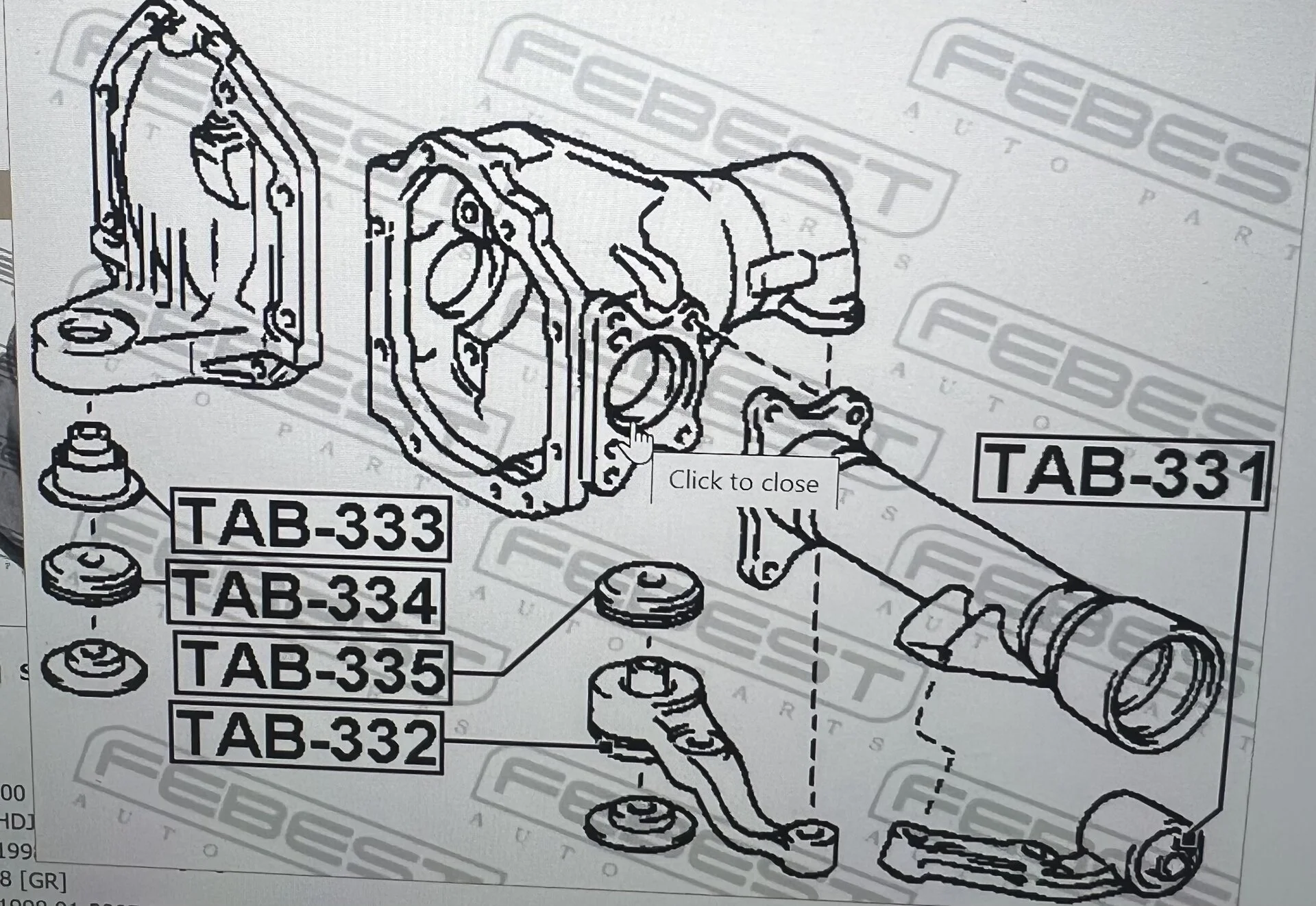

Next update: via a different thread here (clunk P to R...) I checked my diff mounts. When shifting the bushings move and I also ordered those for replacement.
At that point the front end is close to 100% new :-D
But the bad bushings could perhaps also cause the noise when in a left turn the diff moves and starts rattling... Let's see...
Will update next week if all that solved my issues

Just did the front bushings (333, 334, 331) yesterday. Shifting clunks gone, but driving still present.
Will be checking some more stuff today (engine mounts,…) and keep fingers crossed my knuckle refresh solves my issues.
