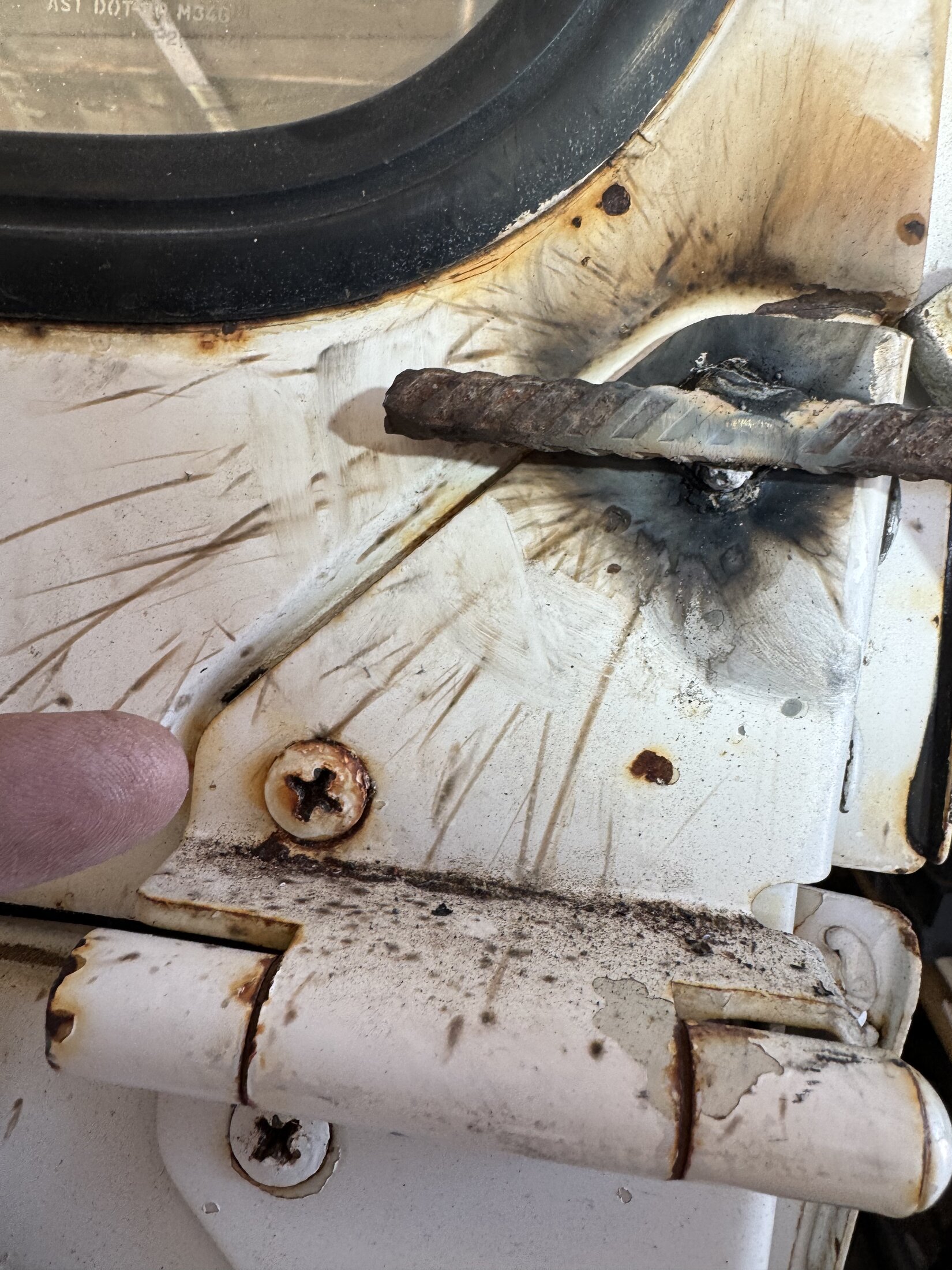

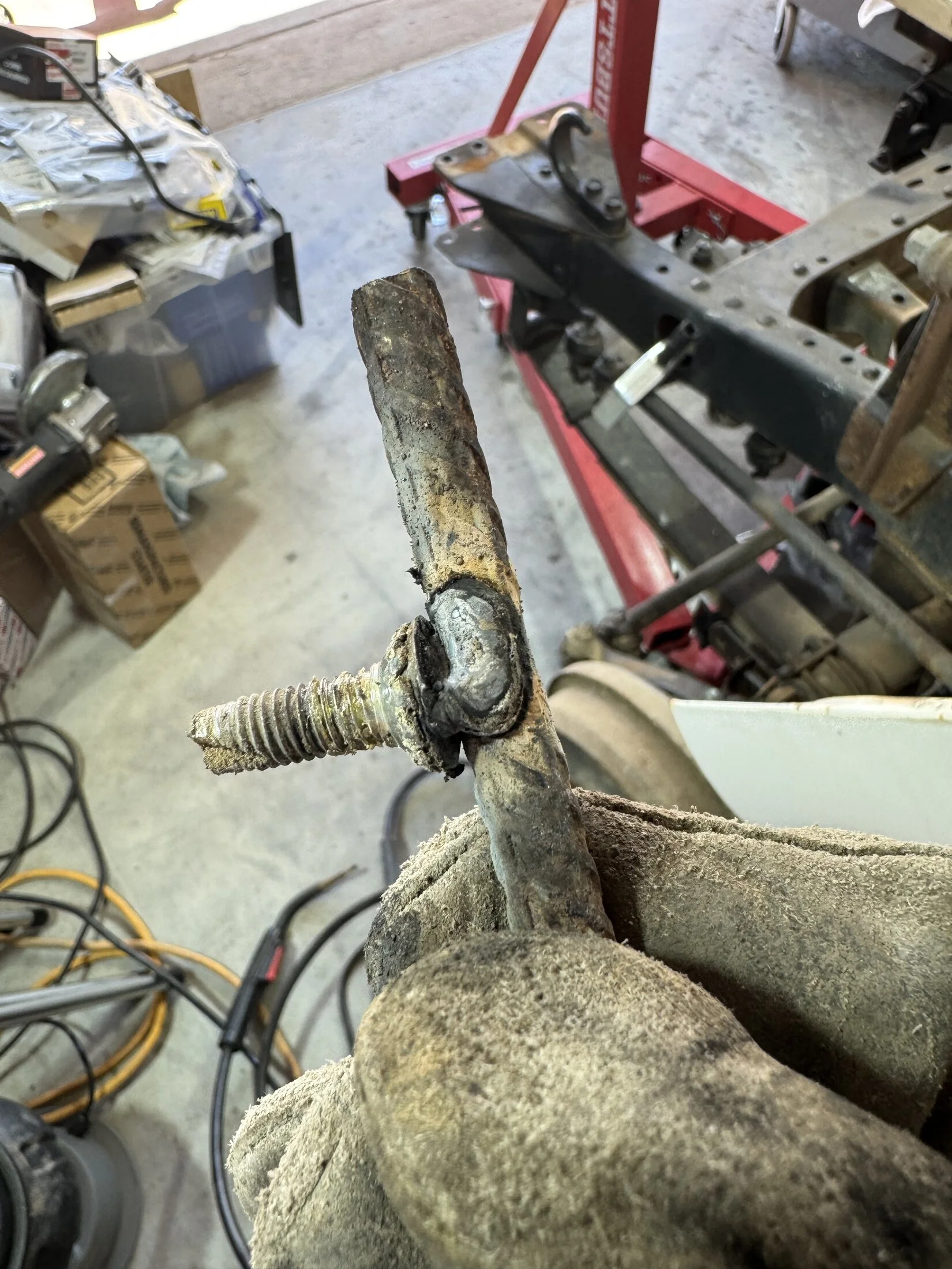

Thought I’d post my solution for a stripped windshield hinge screw. As far as I know, there’s no way to get at the back side of the screws in the windshield frame. I was nervous about trying to drill this one out, so I came up with this option to try first, figuring that if it didn’t work, I’d just grind it off and have to try drilling.
Result was a total success. Despite my amateur welding skills.
The "weld a nut a on" is well known technique, that's almost always met with success.
Happy it worked out for you as well.
