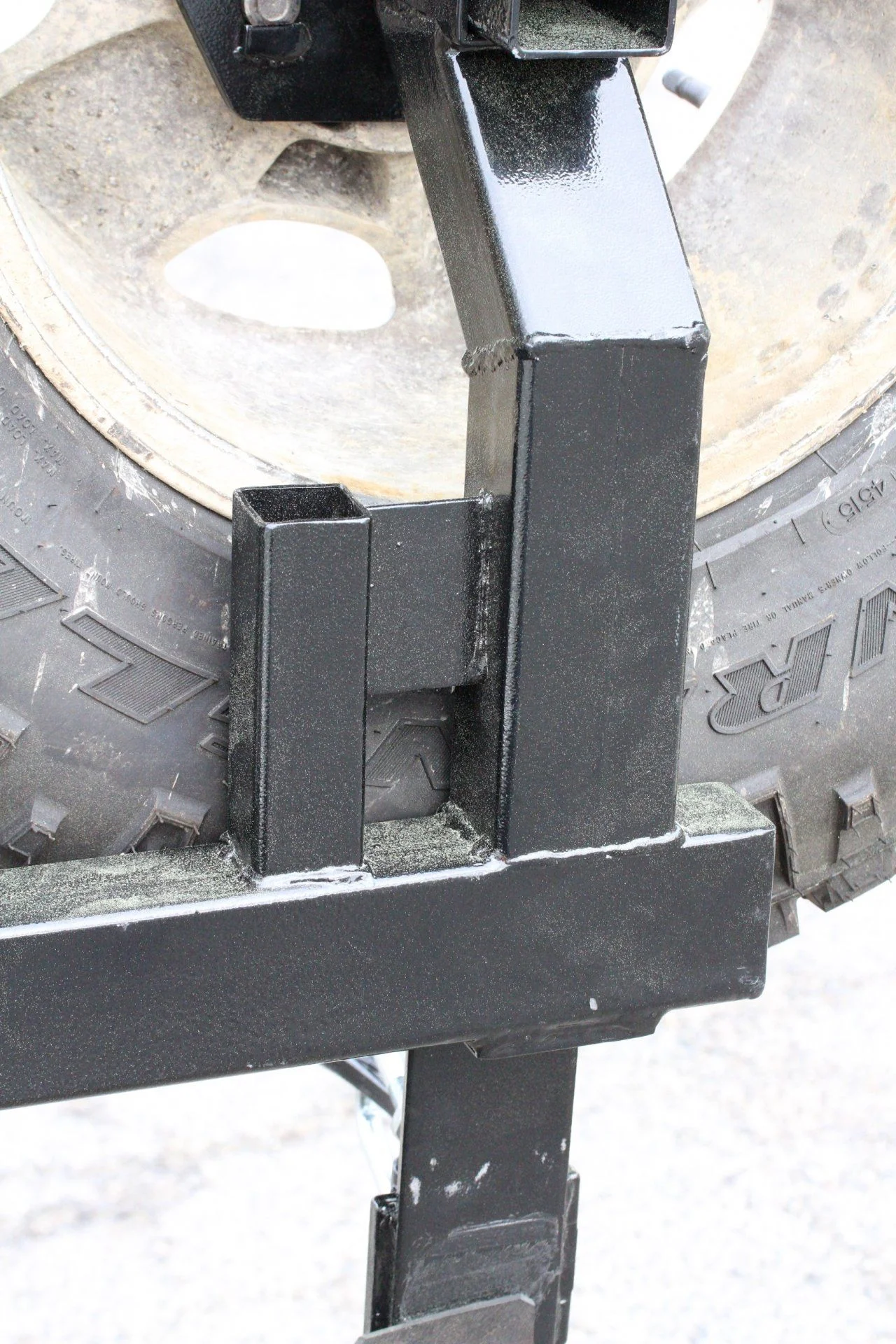

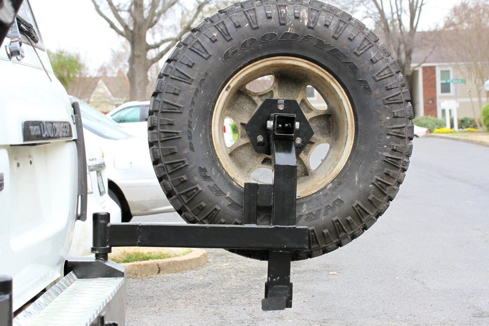

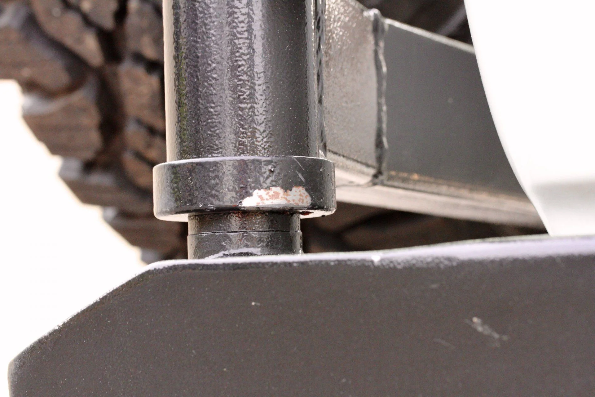

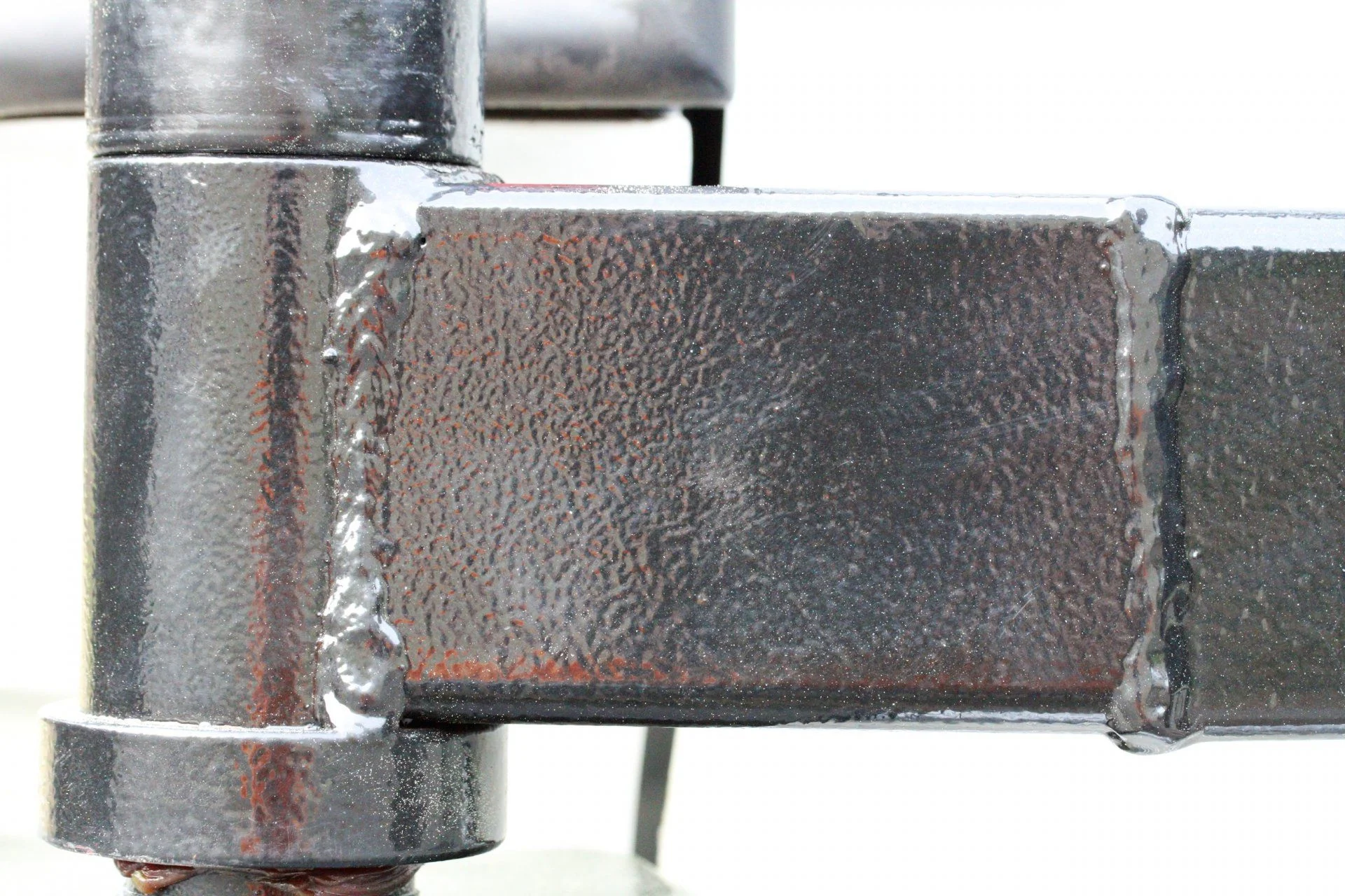

So... The bumper came with ZERO hardware. It uses a bunch of existing locations to mount and requires minimal assembly. That being said, there is probably supposed to be something that holds the spindles on. All it needs is a washer and a nut to go on the threaded end of the spindle under the screw-on cap. BUT... there's nothing to put on there so the swing-outs are only held onto the spindles (and bumper) by gravity, friction, and the latches when latched closed. Not cool, SoFlo... Not cool at all!
View attachment 1428286 View attachment 1428287
no provision for at least a set screw?

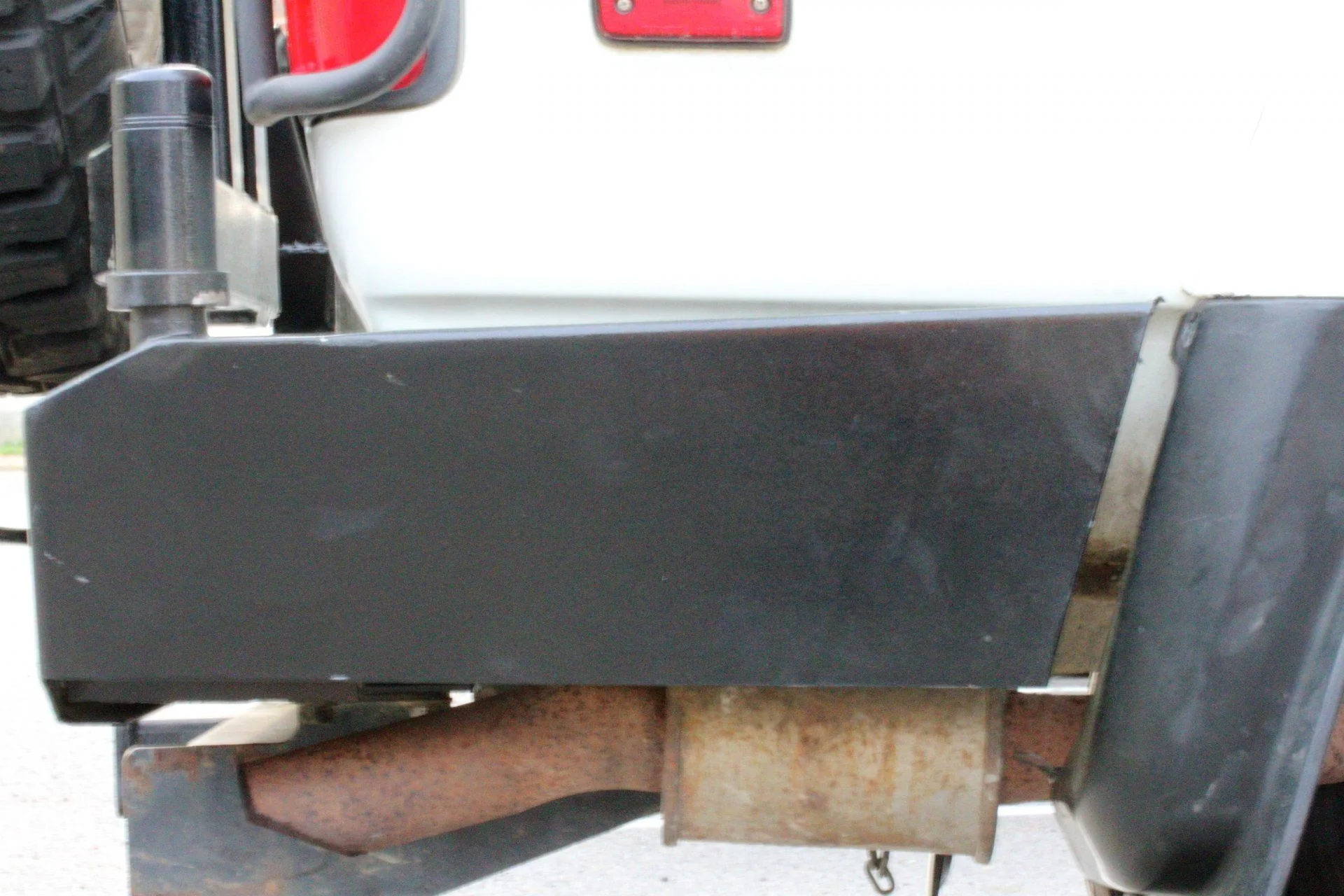

Looks like"your guy" hasn't done the best with installing it either? Some of your pics put the installation on par with the bumper quality.
How does it attach to the chassis? Photo is not real clear.
Looks to me like it's been installed with the side wings pointing up at the front when perhaps the bumper could have been installed with these oriented lower with a little more attention to detail. Having the side wing lower would also improve clearance to the body.
You say "your guy" cut the end off the side wings? Looks like he didn't do you any favours there either. Installing with the wings hard against the body is just slack IMO

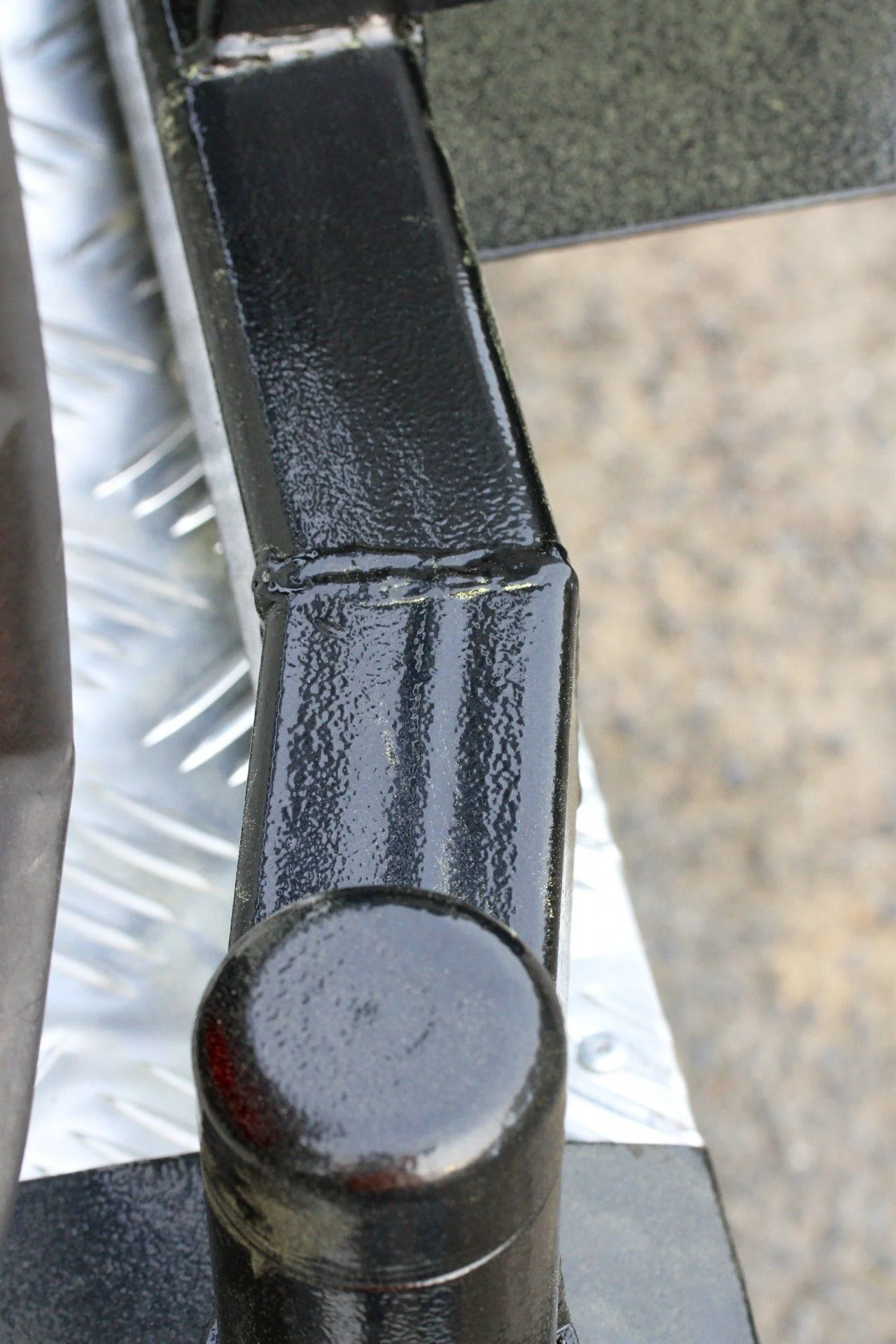

Those cuts :confused: and that what appears to be a cross-threaded and loose bolt :eek:
Yeah sure, I see that too.
But that's a problem with one part of the bumper. The rest of it could still be set-up better.
I can't fathom sending it out of the shop contacting the body and with gouges in the paint.
