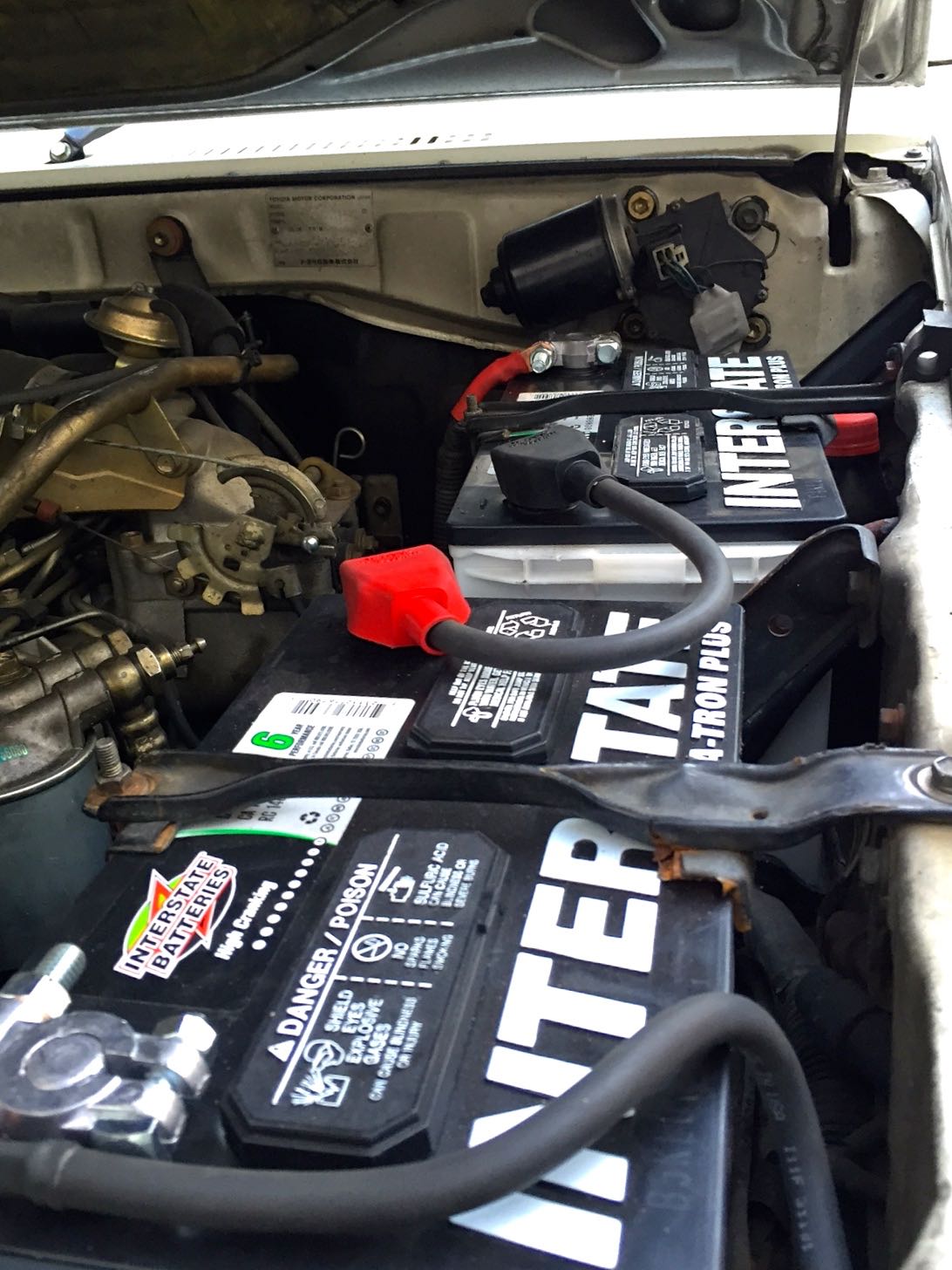

Finally got to try and "shock" the batts, but no luck. Its been tough trying to work on this, been gone a bunch for work but that's slowed down so now I got some time to get to the bottom of this.
First up is new batts, then some diagnostics with the amp meter and see were that leads me.
What are you guys all using for batts?
Interstate.
Better availability in the boondocks and good batteries.
