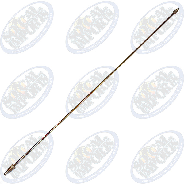

Man today was ruff! Plan was to finish the passenger side today and all was well till I found the flare nut from the brake tube that goes across the axle to the rubber flex line was a bit rounded. Well long story short I could not brake the flare nut free, I soaked it in PB then tried heat, multiple wrenches and nothing. So since the flex line was in rough shape I cut that and removed the hole brake tube, and used a vice and vice grips to get it off. Not fun.
So my question to you guys is do I try and get a whole new brake tube, or is it possible to cut the tube, get a new inverted flare nut, and re flare the tube? I figure it will only shorten it by with of the flare, so fitment should still be OK, I think. But if a new line is easy to source I think that will be best. Just throwing out some ideas here.

looking at the picture you probably don't have enough room to do a new double flare (I am not sure if the 70s use a double flare or a bubble, the bubble curves out and the double flare curves in).
you need a metric version of this to flare a new end
http://www.harborfreight.com/double-tube-flaring-tool-kit-66534.html
for some reason my first flare never works, I always have to cut it off and do a second
Just measure the diameter and buy a new length of Metric tubing and bend a new one up, its really easy and probably 10 bucks
That's what I was afraid of, not enough space with the bend right there.
