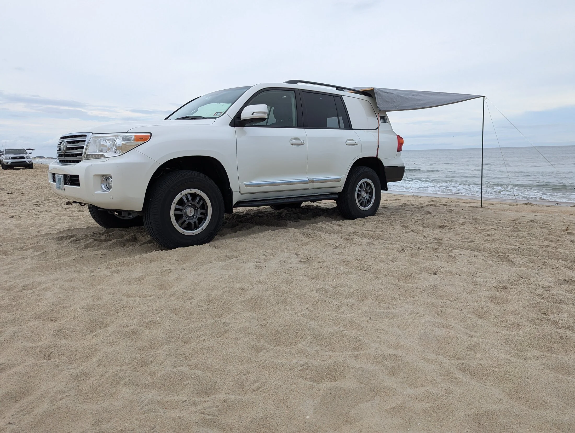

Did 1000 miles over the past couple days, we're in Hatteras NC now. Wow these tires are so much quieter than the KO2s they replaced, now I can hear every little air whistle and squeak. Never knew the radar cruise had a faint squeak when it would apply the brakes.
Hitting the beach tomorrow, I have Staun deflators calibrated for 18 psi. Suggestions welcome...
You will be fine, they are very good on the beach. My stauns are set to 18 as well. Enjoy the sand.
We actually went today, since it was so nice. Truck did great, it was easier than I expected. Setup the canopy/awning too.
