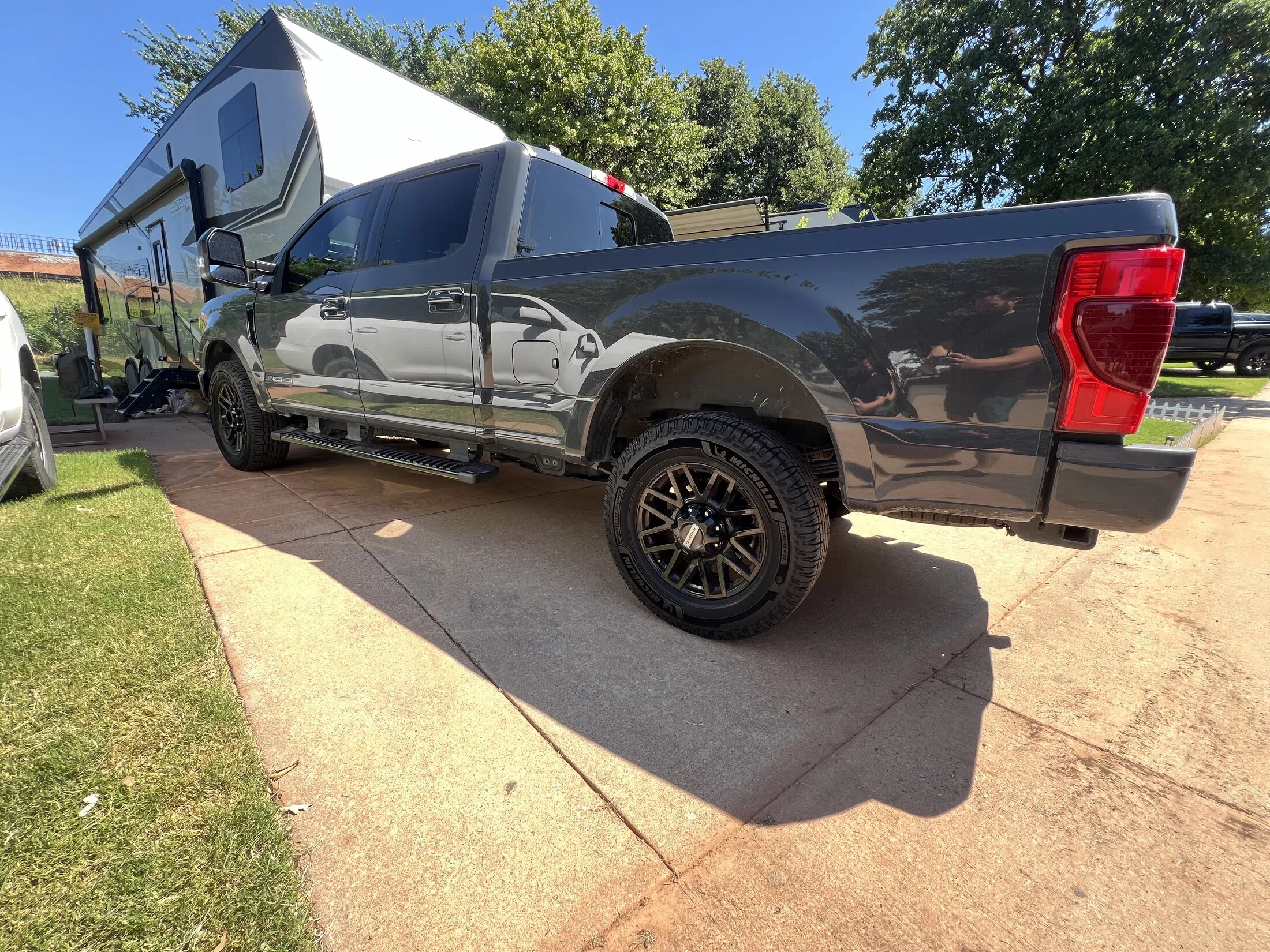

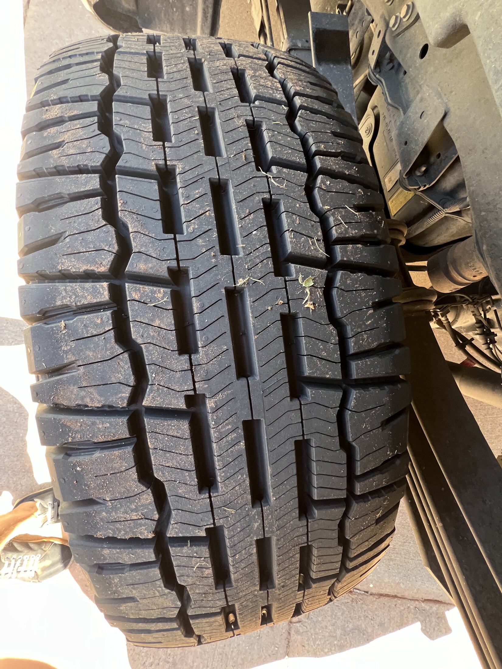

I just got the Defender LTX Platinum in 295/65r20 out on my F350 today, and thought some of the defender LTX fans in here might want to see it. It only comes in 20s right now though. There are water channels that run under the treads, it’s a really interesting design. They look better in person than I thought they would. Sorry I’m not posting my Land Cruiser, it has Toyos on it for now View attachment 3671458
How is the ride quality vs. the Toyos? I take it you have the open country? I’m leaning to get the Open country but worried my wife will hate them if she can hear the tires on road trips.

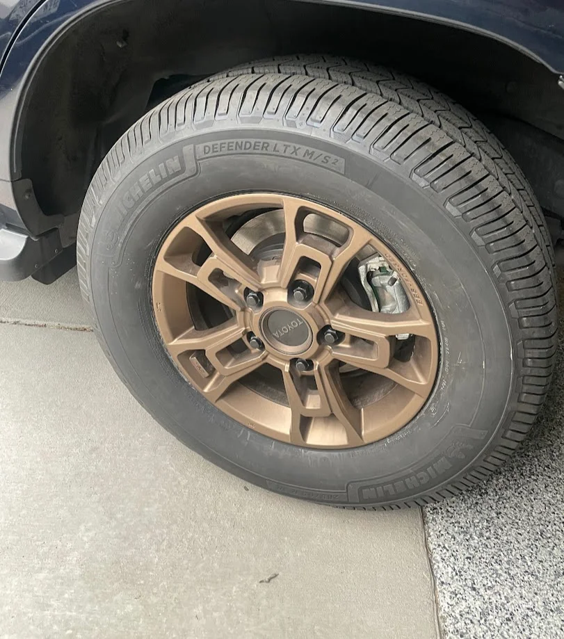

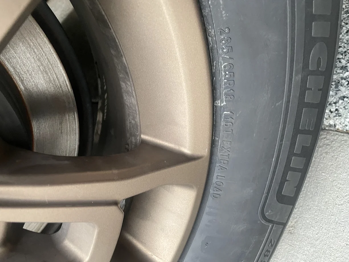

Posted this in the wheel and tires thread as well... joined the Defender club after reading this thread. 285/65/18 116T XL. Interestingly the discount tire website show these as SL but they had the same part number as the XL which is what I wanted. Discount Tire had a promotion which is why I took the chance. They were installed today and are confirmed XL.
Nice! I'm about to go with the exact wheel (black), tire, and tire size on my '18. I saw you said no rubbing with this setup. Is your LC fully stock as in no factory leveling kit, etc?
