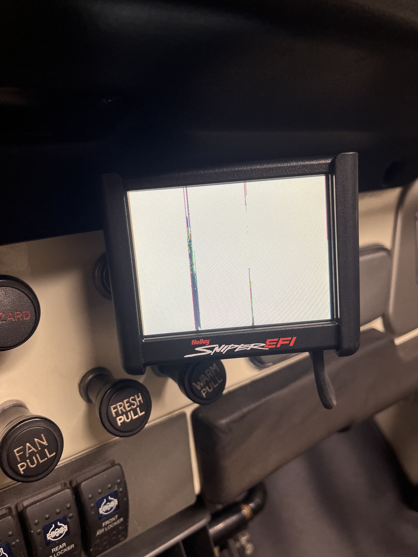

I bought my sniper in May of 2020. Powered it up for the first time today. The screen does some flashing and flickering and then is all white with some vertical lines. Anyone familiar with this? Google search didn’t turn up much other than these touchscreens can be a little glitchy.
I’d get ahold of Holley. That’s a bad display.
My son @SipLife had a similar issue. Turns out dust collects between the border trim area and screen and causes this. He now has it in a dust proof clear box. He called Holley and they sent him a new screen display no questions asked. They know its an issue.
My son @SipLife had a similar issue. Turns out dust collects between the trim area screen and causes this. He now has it in a dust proof clear box. He called Holley and they sent him a new screen display no questions asked. They know its an issue.

Thanks for the advice!
Called Holley today and they are shipping me out a new one under warranty! It must be fairly common. I described the problem and he didn’t want me to troubleshoot anything just went straight to verifying my purchase info and sending the new one.
Not looking forward to pulling the wiring out from behind the dash and through the grommet. I may wire it for quicker replacement next time.
