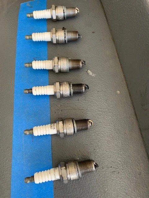

I have a December 1976 FJ40 with a 2f purchased as a project. We had it running one afternoon, then attempted to get start again with no luck just some pinging noises. I pulled the plugs out and all but one are crushed (see pic). I have a 61030 head and the block serial number is 2F 139052, which I believe was made in late 76'. Any idea what is causing the pistons to hit the plugs?
Any assistance is appreciated!

It ran when I went to look at it for the purchase, rough, buy it ran. One we got it back home I pulled the plugs and there was only one "crushed". I ordered all new ignition parts from TPI and we were able to get it running, a few pinging noises and here we are again, crushed plugs. Engine does not look like it has ever been rebuilt from the amount of build up on it. I can snap a few engine pics if that would help.

So, I'm thinking, hopefully it's just wrong spark plugs with too long of a reach, or wrong head for that block...
I replaced the manifold, push rod, oil pan, and valve cover gaskets. The head gasket does not appear to be new. I thought I read on a previous thread the 61030 head was made in 77'. Does this mean the 61030 head is for the flat top pistons? would I need to find a 60030 head for the dome pistons?

Obviously there is FOD in one or more cylinders.
Remove head and show us what you've won!

I pulled all the plugs this AM. #1,#2,#5, & #6 are the problem cylinders. #3 & #4 are properly gapped. #1 & #5 are the completely smashed, #2 & #6 are just touched the center electrode. Most likely a FO in the head. We will know more this weekend. Plugs were ordered from TPI Landcruiser.
