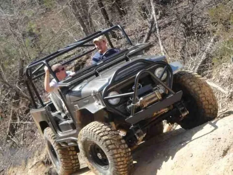

I know that 40 you speak of :D it is slow for sure. and seems to fall over a lot
the 60 axles are 4' ? wider than 40 series or just 2''?
3 inches wider I believe. Does that happen to be your 40? I love that thing. We followed it around at tellico once when my 40 was yellow. And my brother rode in it on upper 2.
Here's what mine looks like now, sans the winch and some scratches.
Nope...... not mine. Followed it around at tellico as well a couple times.
Looking good there. You will love that low/low off road.
