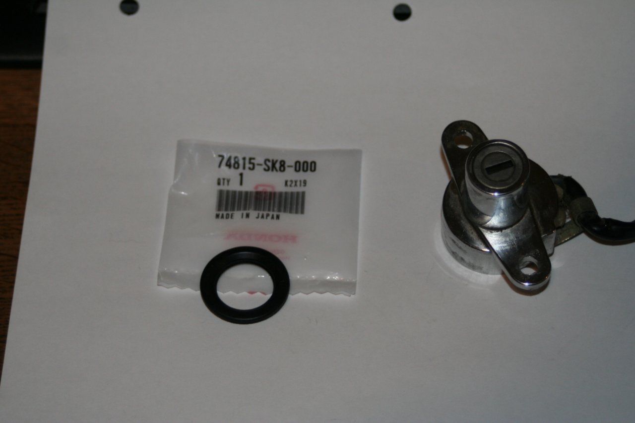

I want to give a shout out to Pablo, for posting this information. I picked up a lock grommet from the Honda dealer, that's just about perfect for our tailgate lock. Pablo posted this in his build, but I'm adding it here. Good stuff to know and only $2.20.
EDIT... I removed the picture, due to wrong part number. Here's the right one!

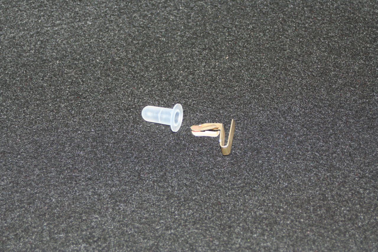

Ron, FYI the Auveco Body Hardware #19437 clips work with our interior panels. I paid $17.00 per box of 25.
http://www.auveco.com/AVPeCommerce/prodInfo/pdf/pdf/358.pdf
If those are the same clips that Steve sends out with his door panels, they are a little shorter than the originals, and thus some of the holes in the door panels would have to be closer to the cups. When I put the new door panels on I think I had to use the old clips ~ 50% of the time. Glad I had not lost them!
I don’t know Steve or what he sends, this is a photo of the two clips if it helps someone needing clips.
Ok, let's see here. On the left, in this picture, is Steve's and on the right, a plated old one. Steve is the fella making the door cards and he supplies the new clips with them. They are some what different, but I think guys are using them. Sure looks like JMack's are closer to OEM. I like that company, AUVECO, for many different clips, etc. That's where I found the green clips to rebuild the door handles. Good information to hang onto.

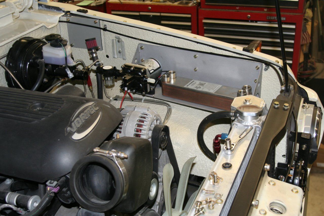

I wanted to include a hot water shower for those extended camping trips and this is what I've come up with. A long way from done, but I've got the main pieces mounted. That's the heat exchanger and the water pump. Got to get the tray powder coated and some hoses made up and I can wrap this up. I'll post up some better pictures when I get it done.
Tomorrow is tail gate day. My Son and buddy are coming out to help. For some reason, I'm more apprehensive about hanging this damn thing, than any other project.
So Ron, will this shower work only with the pig running (to keep warm coolant rolling through the exchanger) or will you have some sort of insulated hot water tank somewhere?
Cool idea, killer execution (as always).
You could certainly use it with a holding tank, but until I use it for awhile and see how it works, good and bad, I'll use it with the motor running. I could fill a bucket up with the hot water and then take a shower later, but either way you will need some type fuel fired heater in order to get the water hot.
Ron as others before have said before your work on this pig is incredible, thanks for all your time documenting the progress!
Question for you, did you calculate the output BTU of your engine at idle and size this hot water system for a set GPM at a set temp? I like the idea but I’m trying to wrap my head around how hot the water will get at what flow rate.
Thanks.
We got the tail gate in and the actual mounting of the gate, really wasn't bad. It was just two of us and our method worked well, BUT when opening the gate nice and slow, the corner caught a big weld in the corner of the body and chipped the paint. Had I thought about it and seen it, could of very easily ground it down. We were able to adjust it up some, still not perfect, at least it doesn't hit anymore. Won't be the last chip!
JMack,
Short answer, no I didn't. I had to laugh a little, because I usually calculate by way of the WAG formula. Seriously, after reading about others and knowing Chevys get up to temp. pretty quick and talking with the heat exchanger people, I bought a 20 plate exchanger. It is a long model, which transfers heat better than the shorter models.. more efficient at idle. The pump I got is a Shurflo that pumps 3 GPM. That's somewhat higher than others, but I can always restrict the flow, without damaging the pump. A stronger pump will pull lake water at a distance better, if needed.
I'm more worried about it being too hot, if it's a problem, I'll plumb in a mixer valve and reduce the temp with some cold water.
Your Cummins may have to idle up a little to bring the temp. up, most guys use the manual throttle to step up the RPMs. It doesn't take much to take a shower or two, figuring @ 2 gals. per shower. One way is to recycle the water back through the exchanger a second time before showering. Pump the water through the shower head into a bucket and pump it back around to heat it some more.
This is all new to me, so we'll learn together.

The lock grommet from the Honda dealer worked very well ( Thanks Pablo ), you do have to open up the grommet to fit the lock, but I used a Dremel with a sanding drum, took ten seconds, done.
