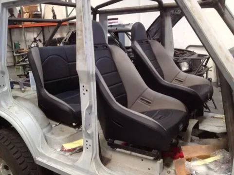

I do like the ones Landcruiserman, made for his. More modern looking, race car look. I'm not sure they would go with a stock looking interior.

The frame you posted is the one I bought from Landcruiserman. Here's a picture of his new ones, he made. Very cool looking. https://forum.ih8mud.com/showpost.php?p=8570482&postcount=394, I don't know how to post someone else's pictures.

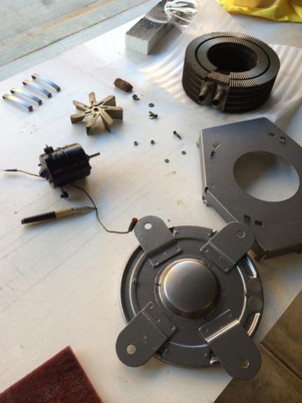

After seeing the rear heater rebuilds, I had to join the fan club. Took mine apart and cleaned and re-painted parts. Used a primer/paint in one called "dark steel" which I found to be the closest match if not quite as warm a silver. Took the motor apart and cleaned it, then painted the housing. Even stuck the Nippon Denso sticker back on. Too. Much. Fun.
